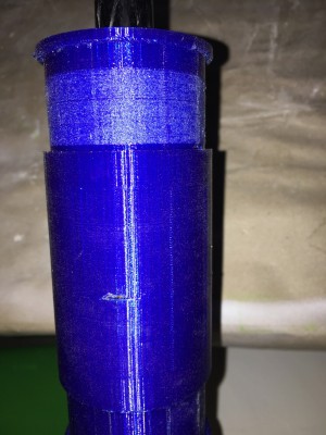

frminio
Posts: 23
Joined: Mon Apr 03, 2017 8:25 am
Re: RAMBo Problems?
Post by frminio »
Hi Geneb,
I was reading this thread as I am experiencing mid printing extrusions stops. I first thought that it could be related to thea temperature setting so I slightly raised the nozzle temperature. No success. Your comment on the power supply is intriguing since I lately experienced big print (>5h) showing a sudden change in extrusion quality, clearly shown by a wither plastic (under-extrusion) ( I will post a picture to illustrate this. This same print ended up with a proper extrusion by the end of the print. I did notice that but did not inquire much as the part was ok with me.
I will follow your suggestion on tightening wires and check voltage.
thanks
Francesco

Hi Geneb,
The extruder seems to work properly. In any case, it is not resetting. Lately, I replaced the hobbed drive roller, thinking the old one was degraded. It seems that this was not the fixing.
What happens is that I have two extruders. The original one EZStruder that is giving this problem and the new one an EZRStruder that seems to work better (stronger in keeping the filament in the hot end).
The part in the picture was printed in PETG using the new EZRStruder. It was printed the way you see it, with the whiter part near the end of print.
It looks like the filament was extruded at a lower temperature, but then everything came back to normal to finish the print.
Now, with the old extruder it looks like the filament gets clogged and /or the extruder is not capable to push and keep the filament down in the hot end.
Since this phenomenon (filament tend to clog) happens with both extruders in a similar manner, I tend to exclude the extruders themselves them from the troubleshooting path.
So, today I was looking at temperatures.
I print with ColorFabb NXGen, a good quality sort of ABS. I usually print at 225 degrees Celcius. Since last two prints stopped at mid print, using the old extruder, I raised the temperature from 225 to 230. What I noticed is that nozzle temperature fluctuates between 225.8 and 230.9 degrees Celcius. I find it strange that the temperature drops so much, all the time.
When I upgraded my V2 with the HE280 I did not recalibrate the temperature probe law inside the firmware. Maybe it is a good idea to do this.
Ok, before raising the temperature that seems again not be the fixing, I checked the voltage and the wiring as you were suggesting. I found them somehow loose and tightened them back firmly. The voltage was looking low, around 10V when heating up the bed and the nozzle, with very similar values. But I measure the voltage on the screw side of the plugs.
Francesco

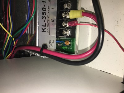

frminio
Posts: 23
Re: RAMBo Problems?
Post by frminio »
hi geneb,
Before moving to purchasing another power supply I was able to better troubleshoot.
The actual voltage output was 11.25V and I was able to raise it up to 12.35 acting on the little orange screw show in the picture, nearby the green led.
When the nozzle is heating up the voltage fluctuates between 12.10V and 12.35V. Are these fluctuations sing of degradation?
For the moment I consider this is fixing one part of my problem. I am turnings my attention to the "old" extruder, as "new" extruder is printing fine
Posts: 5359
Re: RAMBo Problems?
That little amount of bounce isn't anything to worry about - it could be your meter or how well the probes were connecting to the test points. Congrats on the troubleshooting!
