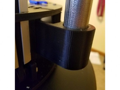

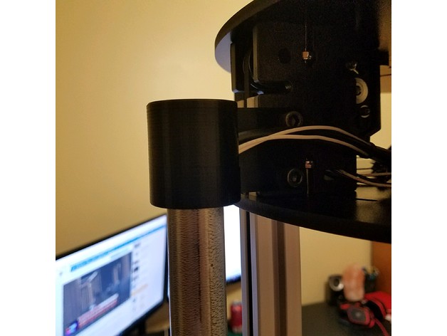

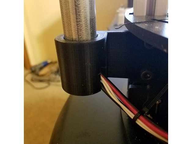

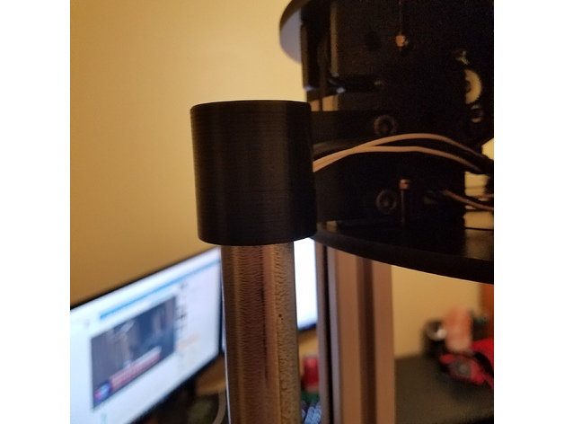

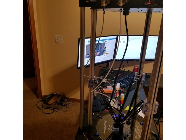

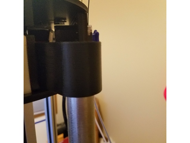

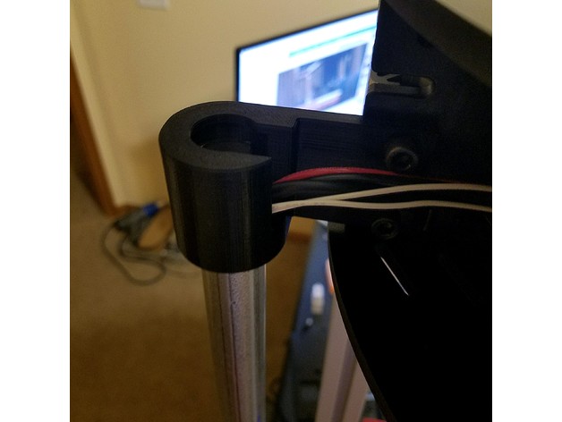

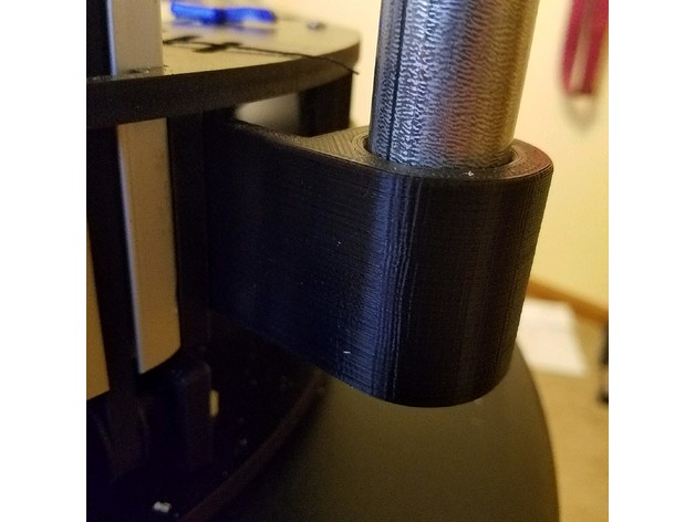

After rolling through the assembly of this bad boy, I noticed I had some slight rubbing of wires up against the belt bearings at the bottom of the machine. Yeah, I could bend, zip tie, tape, or even hot melt the wires out of the way, but in the interest of doing things the hard way and going entirely too overboard, then utilizing way too many resources, I decided to go almost all balls out. I lengthened my wires, then created a couple brackets in Fusion 360, printed out a couple brackets with my semi-trusty super hacked up Chinesium Prusa i3 by pulling dimensions off of the SolidWorks drawings provided by our fearless SeeMeCNC leaders. Then BAM. Threw a big obnoxious hunk of glory conduit (just the standard 1" diameter stuff I found at the local Ace Hardware) in the brackets and shoved those wires in like a chubby middle school kid trying to sneak back in the house after midnight through the basement window.
That being said. I completely and totally was an irresponsible millennial *gags at the affiliation* and didn't take nearly enough pictures throughout the process of this. So here are some pics, that are exactly what I have posted on Thingiverse, ANDDDDDDDDDDDDDD here is the Thingiverse link.

Nicely done, I will probably end up doing something like this next time it comes down for service.
