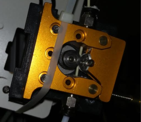

Hi guys,
For the longest time I was having problems with the hotend jamming and the extruder stripping the filament. It turned out the scaling was off on my printer by just under 6%. I found this out when I printed a NEMA 17 to NEMA 23 adapter and it was too small. Up until that time I was printing knick-knacks, so I didn't even bother checking for accuracy.
When I discovered the error, it occurred to me that the volume of plastic would also have to be corrected. It turns out that about 91.5% of normal is just about right. Now I've got nice, clean prints, with zero jamming.
Since I knew that my scaling was off, I found a 100 mm x 100 mm "L" block on Thingiverse and printed it up. I got the scaling factor that I needed, but found that the X and Y lengths were off by about 1 mm (the X axis being the longer of the two). The "L" block is 10 mm wide (and 5 mm tall), and it's thicker nearer the angle, and tapers off towards the ends. It is also a little over on the X plane, while the Y plane is a bit under.
The printer has been leveled using a dial indicator and the new arm lengths were stored in the EEPROM. The printer prints out a very nice and flat circle at any diameter.
Are there any adjustments that can be made to correct for this?

Steps per mm for the extruder look to be unusually low to me.

geneb wrote:Steps per mm for the extruder look to be unusually low to me.
Good catch! They would be if it were the original extruder. :)
I replaced my ez-truder with a:
https://www.ebay.com/itm/Aluminum-Bowde ... 2749.l2649
and I'm driving it with a NEMA 23 stepper.
The extruder had to be modified for the larger shaft of the NEMA 23 motor by drilling out the filament drive gear to 1/4" and then cutting away the extruder frame where it got in the way of the drive gear set screw (Lewisburg isn't the place where you want to live if finding small machine parts on a weekend is a necessity). This was actually a bit of a rush job so I had to make do with the parts on hand.
The screw that holds in the roller was removed and inserted from the inside of the extruder (where the screw threads are). I now have a NEMA 17 stepper motor with a 5:1 gearhead on it, which would at least look nicer (no tiewrap to hold things together). But since it is working flawlessly (not taking into account its looks), I'll probably leave well enough alone.
So far it has stripped the filament just once. That was because the filament had a "Z" crimped into it from the factory that wouldn't go into the head. That's it. :)

After replacing the hotend, the old extruder worked much better. But it would still stall out for no apparent reason (although I now suspect that my volume problem was the root cause). I got *really* tired of having to nudge the filament along from time to time as it went, and so I got medieval with it. :)
