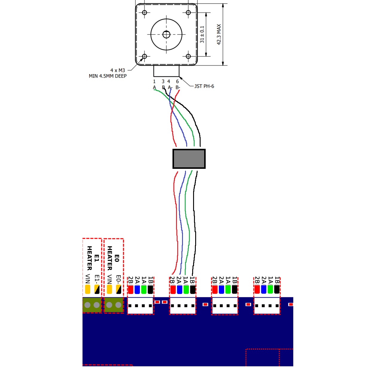

Hey everyone so I finally decided to pull the trigger and bring my Max v2 up to date with upgrades. Got my Duet wifi and titan extruder yesterday and im still waiting to get my fsr kit with the tricklaser fsr plate.
Everything went pretty smooth with the upgrade process except i cant figure out how to properly wire the titan extruder stepper motor for the duet. here is the link to the data sheet for the pancake stepper motor used on my titan extruder. https://wiki.e3d-online.com/images/2/2e ... PUBLIC.pdf
Here is the wiring diagram for the duet wifi. https://duet3d.com/wiki/Duet_WiFi_and_E ... g_diagrams
is this how it should be wired?
I havent had time to trouble shoot the wiring yet since it was late at night and now i have to go to work. Any help would be greatly appreciated!

Hi buggy,
nop should be like this B-= Black B= Green A= Blue A-=Red

Thank you for the response! I will try this when I get home, in hind sight i should have wired it that way first lol
