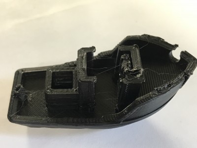

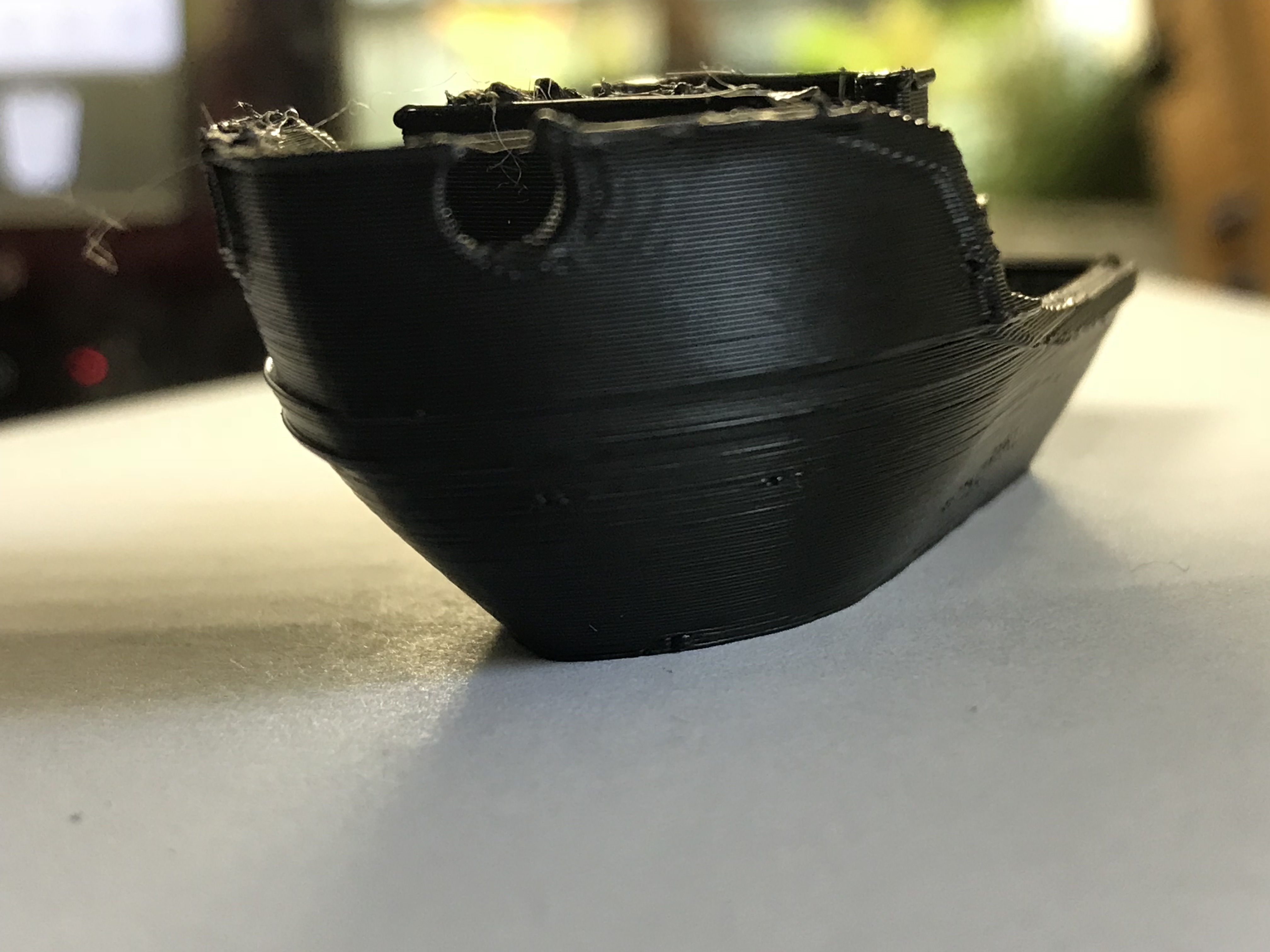

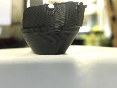

So after reading about adarcher's grinding problem I was inspired to swap my tower connections to see if one stepper in particular was skipping. I swapped my stepper and endstop connectors from X to Y, Y to Z, and Z to X, effectively rotating my prints 120 degrees counterclockwise. The chattering/stuttering sounds started up after 20 or 30 layers this time. I hit the e-stop pretty quickly because it seemed like the hotend was dipping back into the print and was failing to extrude. Rotating the connections didn't seem to change the nature of the chattering, but I want to try it a few more times so I can watch it closely.
It's difficult to tell if the problem is particular to one tower. I'm printing a Benchy - is there some specific test print I could run to try and suss out which tower is losing steps? I imagine that a shape with trilateral symmetry might show errors related to skipped steps more consistently. Or perhaps if I printed something offset close to one tower in particular? I am tempted to try a spiral vase but when the hotend skips it moves so far that I can't imagine being able to continue the print to check for accumulated errors.
If I were to have to guess, I would say the problem sounds like it's coming from the Z tower. But when I'm facing the machine from the front, it also sounds like it's offset a little to the right. Visually, it's hard for me to tell what's going on at all three towers at the same time, but I'm certain I've seen the Z tower stutter during many if not most of the times this problem has occurred. So, I'm fairly certain the Z tower is affected, but maybe the Y tower is also implicated. Another explanation for the sound I'm hearing is just an asymmetry in the resonance of the top enclosure, so maybe the problem is all in the Z tower. Which is not to say that the X tower isn't affected - when it really gets going, the chattering seems to come from the whole machine.
Now is it time for me to start cutting off connectors and re-crimping the wires? Not sure what else to do.
Thanks,
~Joe

I'm pretty sure I replied to your support ticket (surprise!) last night, but if anyone else is having this problem they can try this file:
http://download.seemecnc.com/motion-test-cylinder.gcode
This started out as a 150mm diameter by 150mm tall cylinder. It was sliced with no top, no bottom and in spiral mode (single wall) in Cura. I then stripped out all the fan, heater, and extrusion controls. The end result is a g-code file that will just run in a spiral circle up to 150mm. This should help identify the problematic axis. You can play with the speed multiplier in the control panel to speed up or slow down the motion.
It was sliced at 60mm/sec.

Yes, thanks again! The power supply was set to the wrong mains voltage after all. I meant to email you about closing the ticket but was a little distracted last night. I appreciate the quick turnover. That problem seems completely resolved; I've run several files including your cylinder, Ryan's Benchy and my own stuff with no symptoms, and my 12V supply is steady. I'm still having some issues but it's totally normal stuff now - prints peeling up, and I think some Q-tip fiber got stuck in the grease on the ball joints. I'll make new threads for them.
~Joe

If the supply voltage to the TMC drivers drops below a certain voltage (somewhere around 9V AFAIR) then the drivers shut down and they need to be re-initialised when power is restored. So when the firmware detects that the voltage has fallen below a slightly higher voltage (9.5V AFAIR) we shut the drivers down. That's why you get stuttering if the PSU can't maintain sufficient voltage.
This isn't the first time I've heard of a user having this problem because a PSU was run from 110V but set to 240V. Perhaps we should pop up a warning messages when under- and over-voltage events occur.
