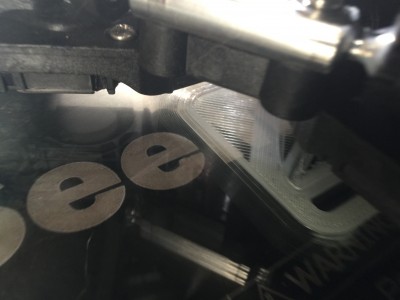

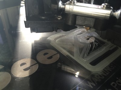

  I have a New Artemis 300.  Impressive looking machine!  I have read a lot on PLA printing and gotten to the point I am getting prints to happen...but they just are not printing like some of the sample .stls provided.

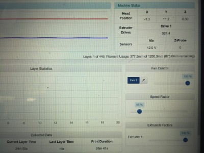

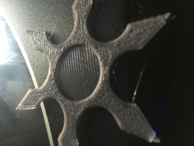

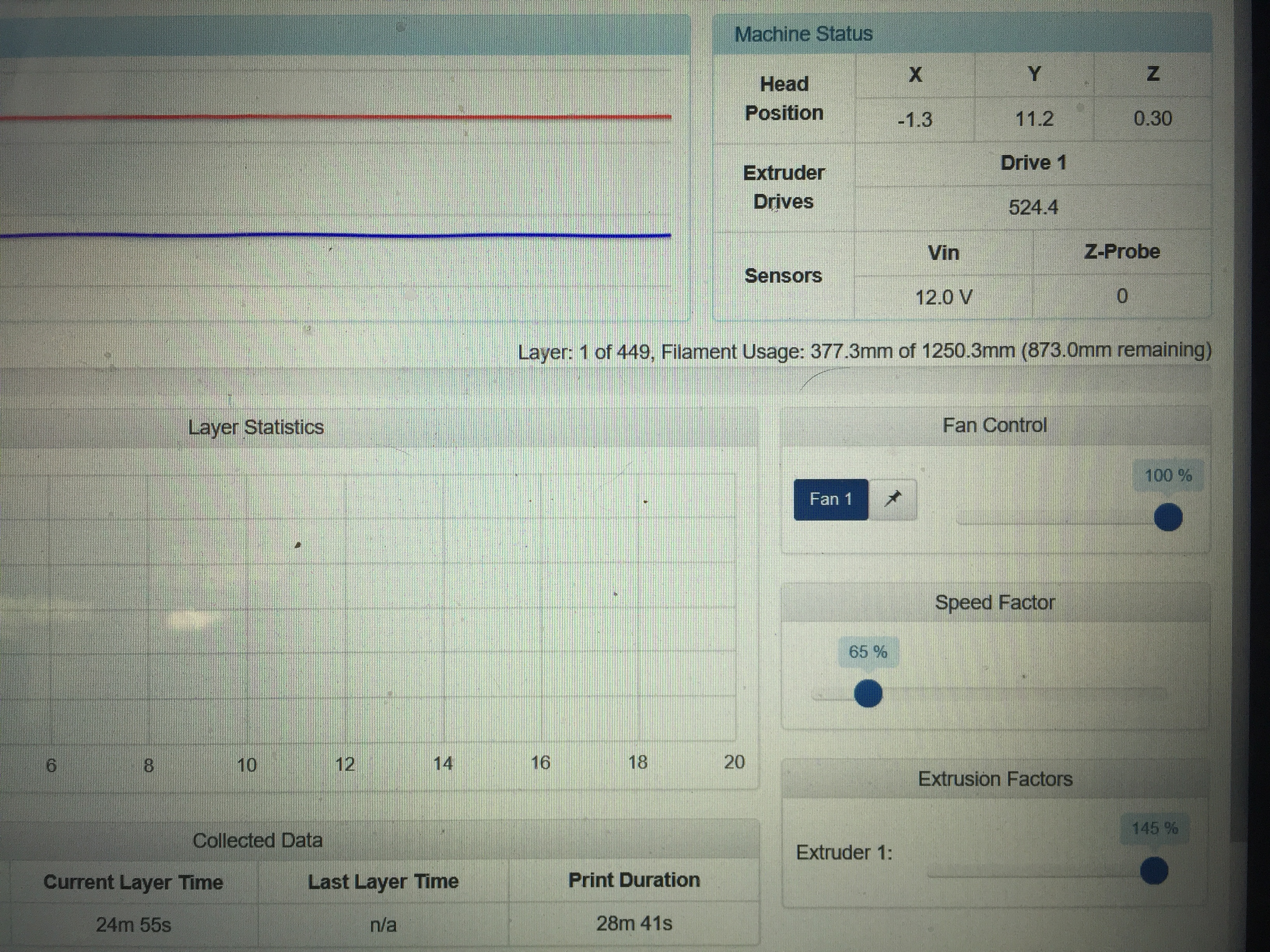

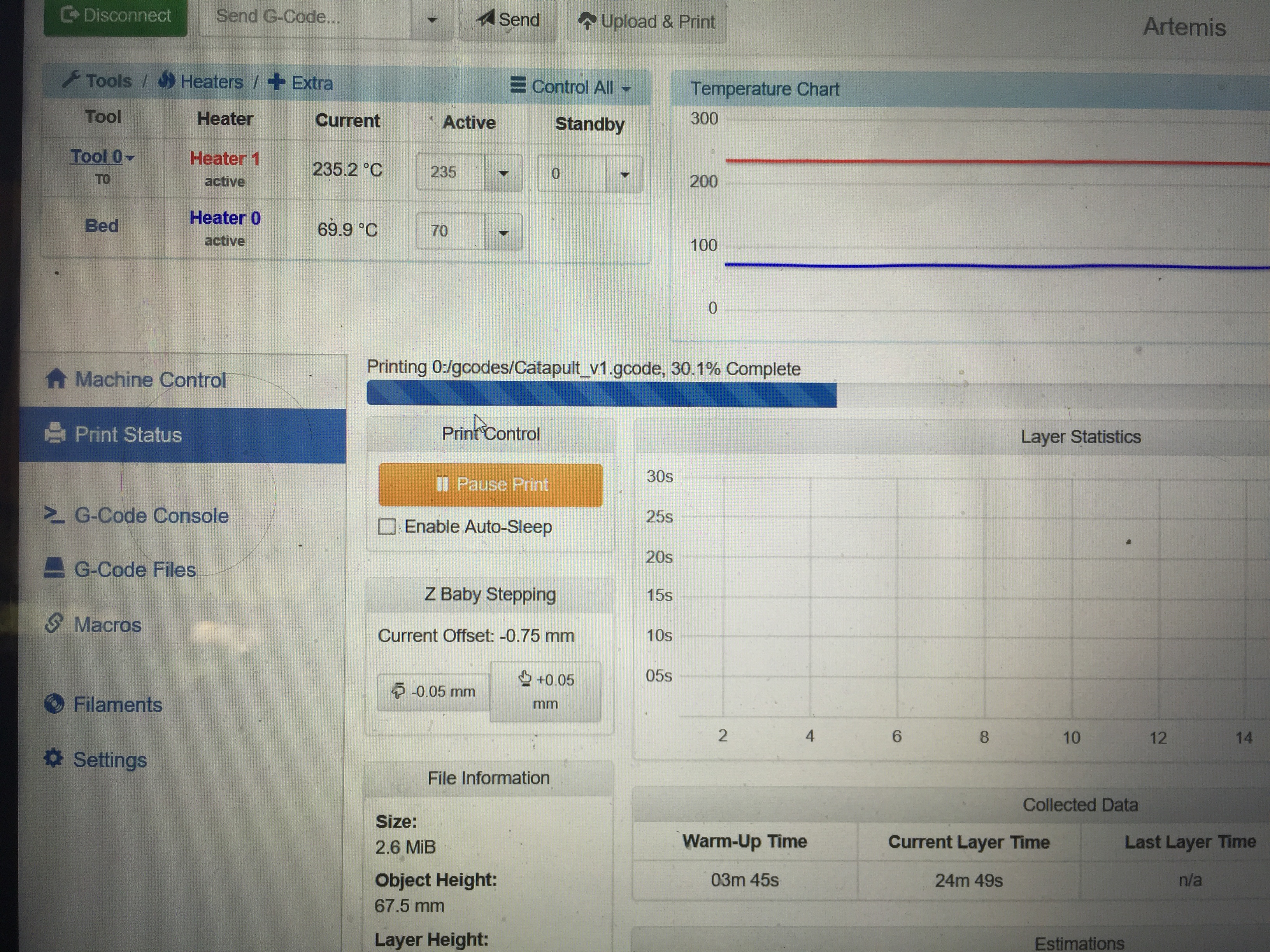

  My main problem was adhesion .  I slowed down the protest speed.  Also, filament was not extruding well.  I checked for nozzle blockage...it flows well when manually tested.    So I sped up the "Exteusion factor" on the control panel .  Also raised filings temp.  So it's laying down filiment well now.  Well...not well.  I can't get the lines of layer down filiment to "squish together" like some of the samples did.  I even have my z-baby steps lowered to - 0.75.      Here are some shots of the base build of a mini catapult model.  Suggestions or rerencing me to another post in here regarding this issue greatly appreciated!  Posting some photos of my screen and the prints .     Aloha!  -Tom.

It's a little hard to tell from the pictures but I think that the "first layer" may be a bit too close to the bed.
It also looks like your temperature is set too high for most PLA's (235 may be ok for some PLA's)
---60 degree bed temperature is usually a good point for PLA.
---Some PLA's like 235, but most work with 180-215.. Sometimes I print hot at 205
---What PLA are you using (makergeeks likes 235 - but I don't like makergeeks)
I would not run the fan at more than 60% after the 1st layer -- I am using no fan in most cases...
This may be a question of adjusting Z offset.
The first layer "skirt" should have a rounded feel. It looks like your layer might be a bit squashed into the bed.
Therefore you would want to raise your Z offset away from the bed.
