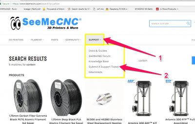

Official technical support is here:
SeeMeCNC-support-request-ticket
