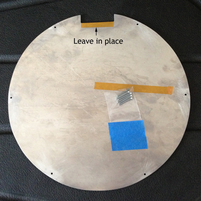

I published the prints for the heat distribution plate on my blog this morning. Here's a little more info on building one:
You do need to insulate a few exposed traces on the Onyx. And if you accidentally scratched yours, you will need to insulate that area too.
It's also prudent to insulate the edge of the electronics pad opening "just in case". This is the backside of the plates I sell, they come with the opening taped, some extra Kapton to insulate the Onyx traces, and longer 1" x 4-40 screws to hold it all down. Note the random pattern of scratches on the backside, they are unique to each plate and engineered to most effectively transfer heat ;) (just kidding, they are a manufacturing artifact) The front side is burnished with a scotchbright wheel to create a grippy print surface.
Backs Side.jpg (143.63 KiB) Viewed 19188 times

Folks, I have decided to discontinue manufacturing and offering the aluminum heat dissipator plates. Apparently, the waterjet cutting can lead to internal stresses that can relax and cause warping over about a two day period. I had the batch of 25 cut and kept 2 for myself. These are still dead flat. However, I've now had two customers contact me with warped plates. This relaxation warping likely occurred during shipping. I picked the plates up within an hour after they were cut, completed the finishing work (countersinking, deburing, etc) and shipped them with a few hours. I am hopeful that the majority of the plates are fine. The original batch of ten I made on my CNC equipment and I know are dead flat and won't warp. For those of you with the waterjet plates, if you have ANY QUESTION that it is warped, contact me and I will give you a complete refund immediately. You have two options for this refund:
PREFERRED: bend or otherwise destroy the plate and email me a photo, I will refund the price of the plate AND your shipping costs. I would prefer that you do this as I do not want defective product on the market. I run a squeaky clean business, and do not tolerate imperfection. I will lose money on each returned plate as it is, so it does not make sense to have you ship it back and go through the hassle of packing and mailing. Please recycle the destroyed plate!
ALTERNATIVE: If you choose to keep the plate, I will refund the purchase cost but not the shipping costs. You are welcome to do this if you so choose but it is a one time offer - you can't choose this and then come back later and ask for a shipping refund.
If you have another suggestion, I am willing to work with you. But, I am not going to be manufacturing 1/8" plates. I have received prototypes in 3/16" and 1/4" and after a week these have not warped. However, the added cost is considerable and the added mass requires more energy to heat up. I have also experimented with a three-point mount/leveling system but I am not sure that these will be a cost effective option, so no decision to offer them has been made.
I'm very sorry for any inconvenience. As I mention above, I am hopeful that the majority of the plates arrived flat but if not, I'll refund everyone and take the loss on the chin. Everyone on the wait list has already been notified and the wait list signup has been removed.
