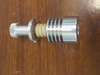

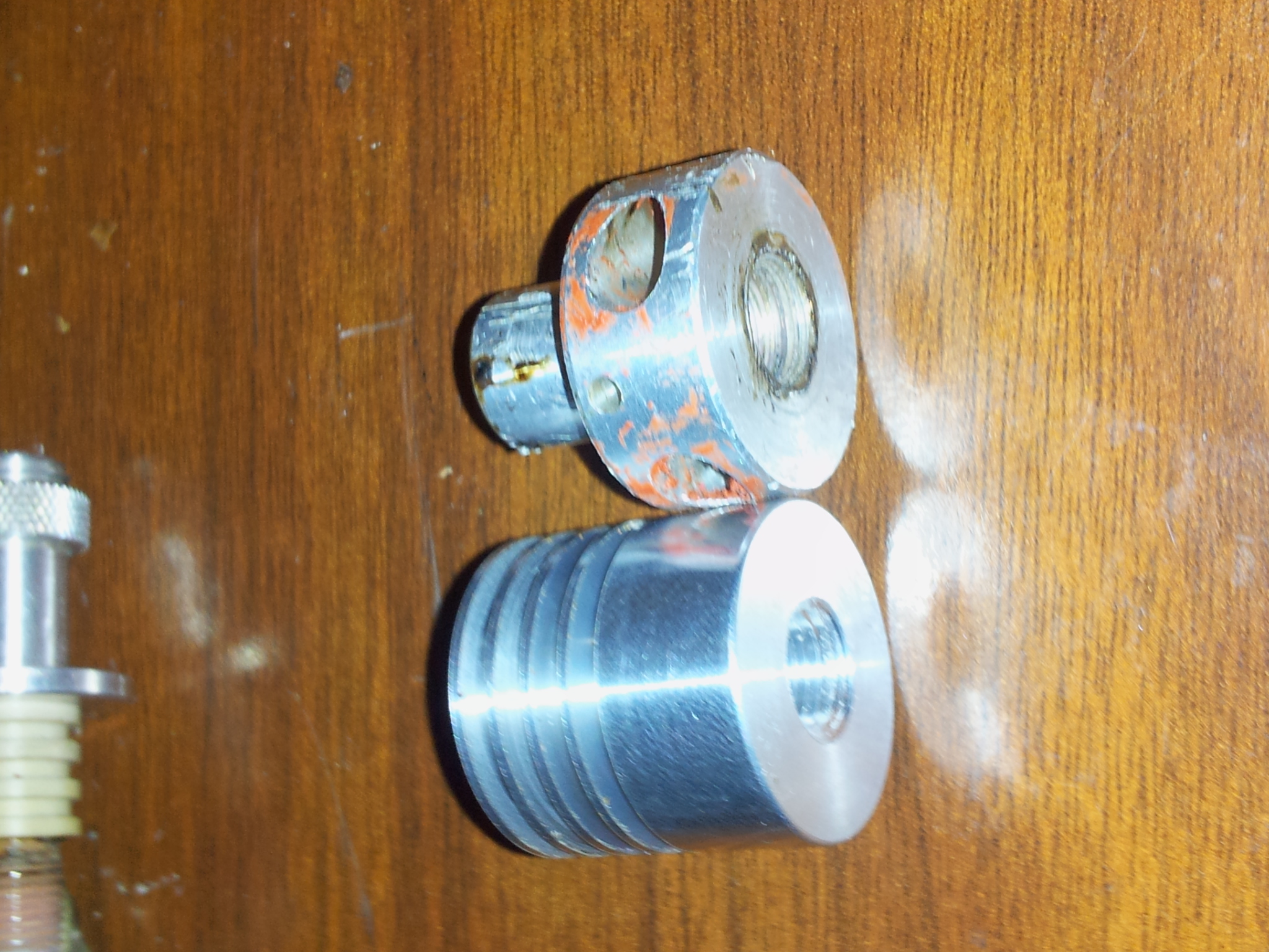

I had a friend help me out with a design I wanted to try. I kept having problems with the filament getting too hot and not feeding. So we are trying something just a bit different.
I still need a new nozzle but I hope this makes it easier to keep it cool.Re: Hot end design

No Stainless is an excellent insulator if you make the wall thin enough, apparently the magic number is ~0.5mmcambo3d wrote:I saw on another forum that they are using brass tip with a small melt zone and stainless steel tube. no peek at all. Surprisingly its stays cool to the touch without a fan must have something to do with dissimilar metals; I don't know, but it seems to work. jgr hotend made in austraila. trinity labs testing one in the video. Supposed to be able to print with most filament without problem. Model for the delta (rostock) styles printers coming soon.

It's interesting only because Nophead tried a stainless extruder over 3 years ago and couldn't get it to work reliably without using a tapered bore, but there are now a few all stainless hot ends with bo peek or PTFE.
Jolly Grim Reaper is selling one, Joseph Prusa has one.

Those are pretty neat. I may see if I can find some stainless tube to try out. I found some smaller fans as well so maybe one front and one back?

Dang, That sounds like it was fun. Spring Break is next week so I am going to be trying again. Ellen, my wife is really excited about having the printer working correctly so she can design shoe lasts, and I just love to play. When you get a sdesign ready please let us know!
