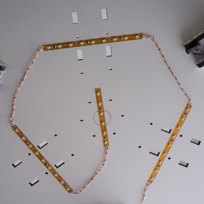

Lights
The wires are going through one aluminium rail.

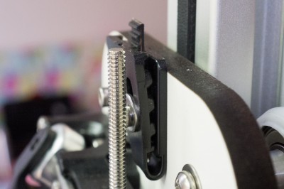

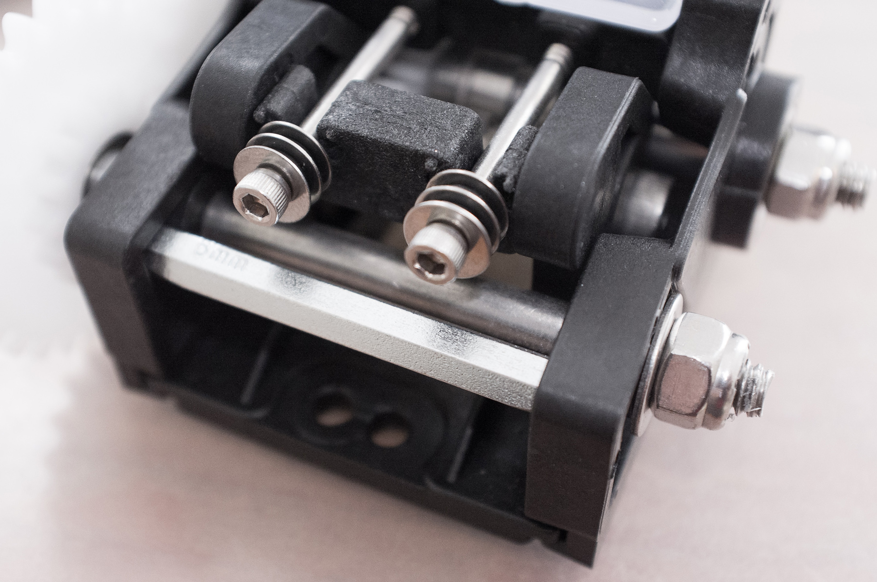

Extruder stiffener
Made of an allen wrench - I have plenty of them due to Ikea ;)
Now it's possible to adjust the position of the gear, so it is in the center of the two other gears.

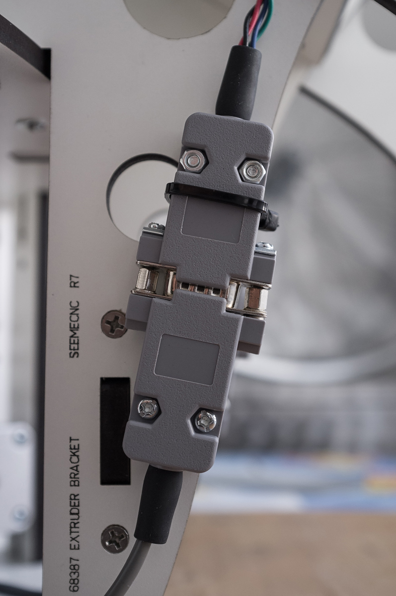

Connectors
I added 2 pairs of D-Sub connectors for easier removal of the extruder-unit. One is for the hotend the other one for the extruder stepper. The connectors are screwed together for save operation.

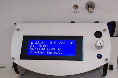

Switches
The small one switches the lights the large one the power to the heatbed.
I also screwed the LCD face plate above the display to the LCD standoff plates. The screws are going through the holes in the PCB of the display. I added a nice aluminium knob.

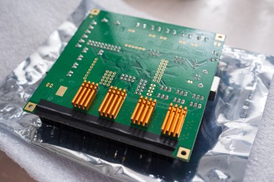

Heat sinks
There where places to put heat sinks on the backside of the Rambo, so I put some there ;) Probably not necessary.

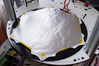

Table insulation
I added also some aluminium foil to the top of the table. With this two foils I could significantly increase the heatbed temperature (with the original underpowered power supply).
You can see in the picture also a small chamfer for the wires and how I soldered the wires to the back of the heatbed pointing inwards.

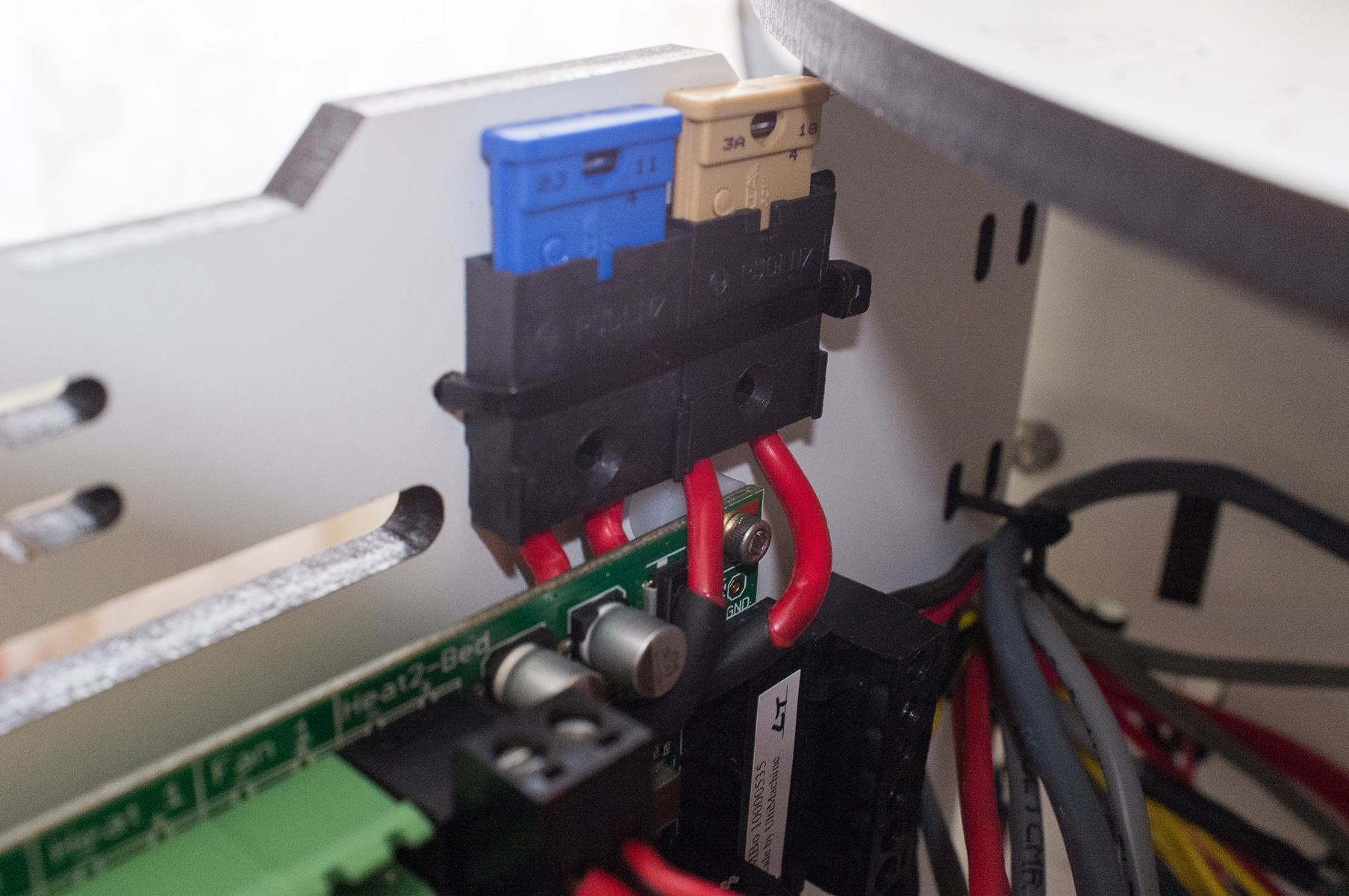

Automotive fuses
I replaced the fuses for the heatbed and hotend with automotive ones.

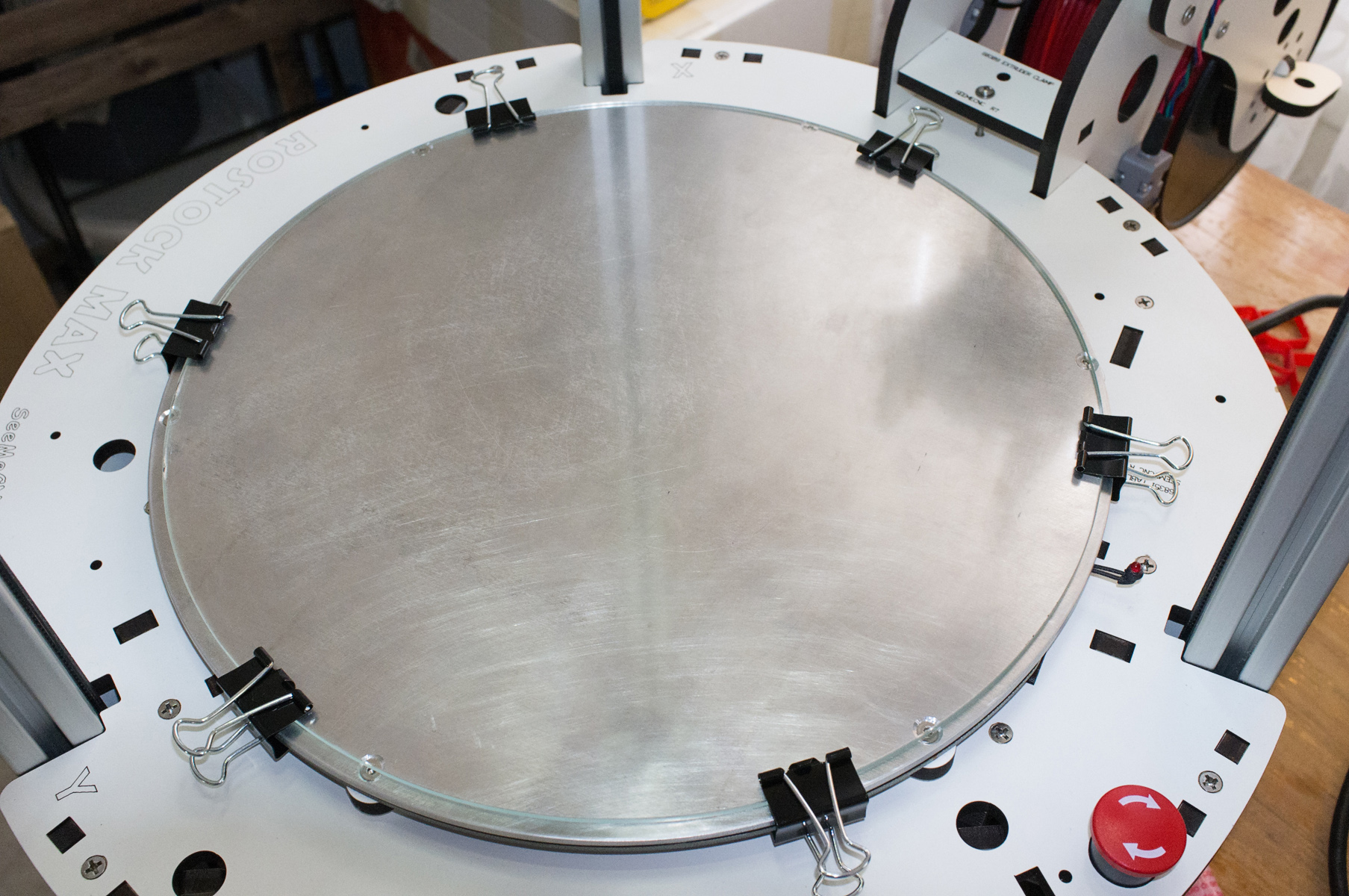

Aluminum heat dissipator plate
Like Mhackneys, just without the cutout for electronics pads. (Because I soldered them to the back side.)
Got it for 10€ water cut from a local. It was important to be precise with the holes for the screws, but because there are six of them, it was easy with a pair of compasses. ;)
I replaced the screws with metric ones. (Had to change the t-nuts as well.)
I'm using six 9mm paper clips (the original ones are 7mm).

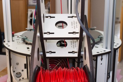

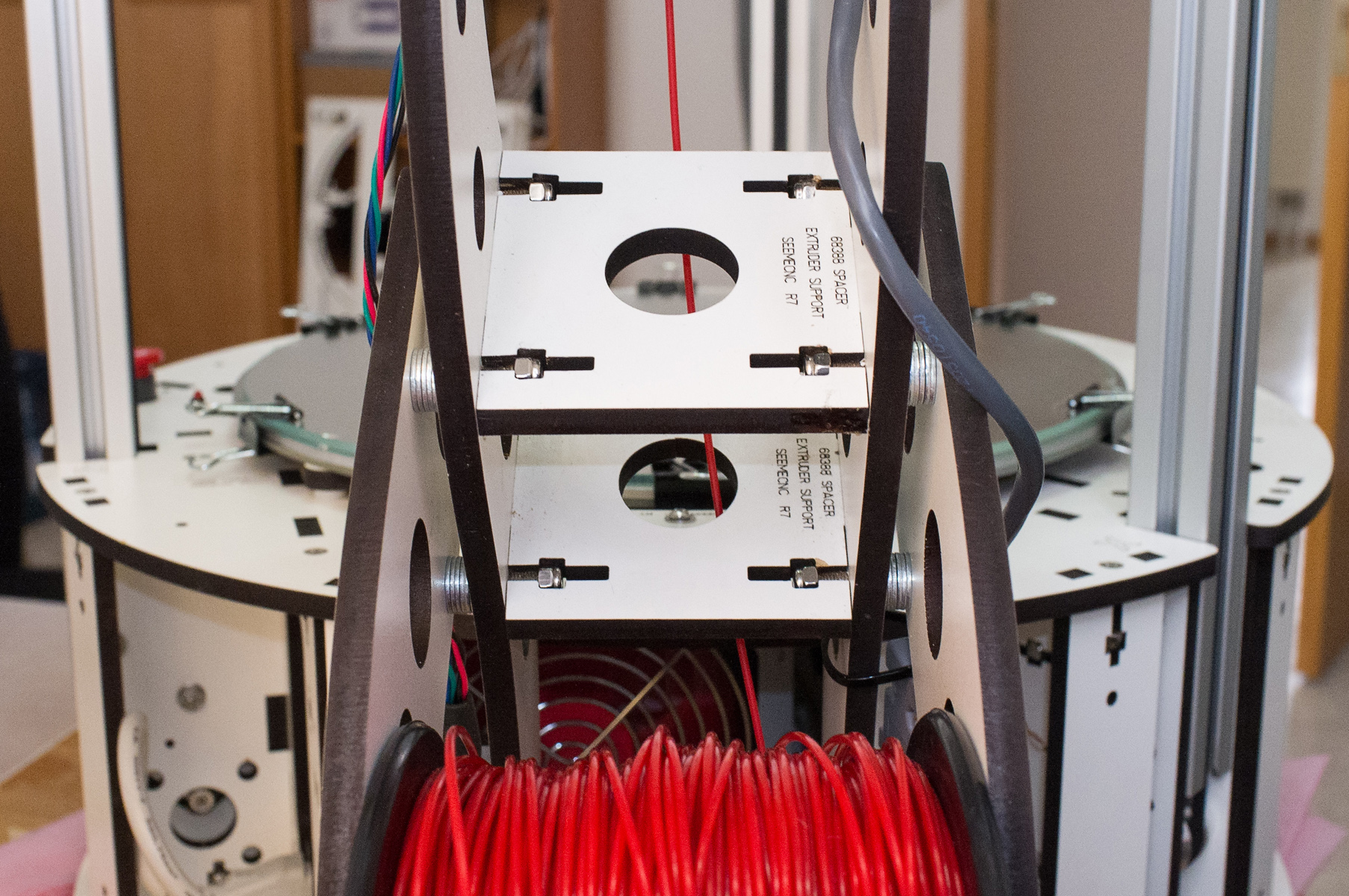

Spool holder extension
My spools where not fitting, so I added some longer screws (guess what, metric ones ;) ) and spacers.

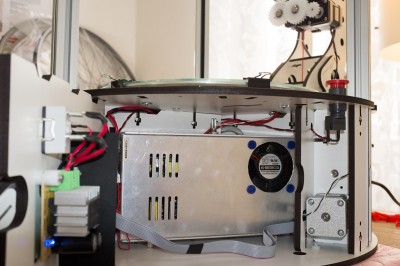

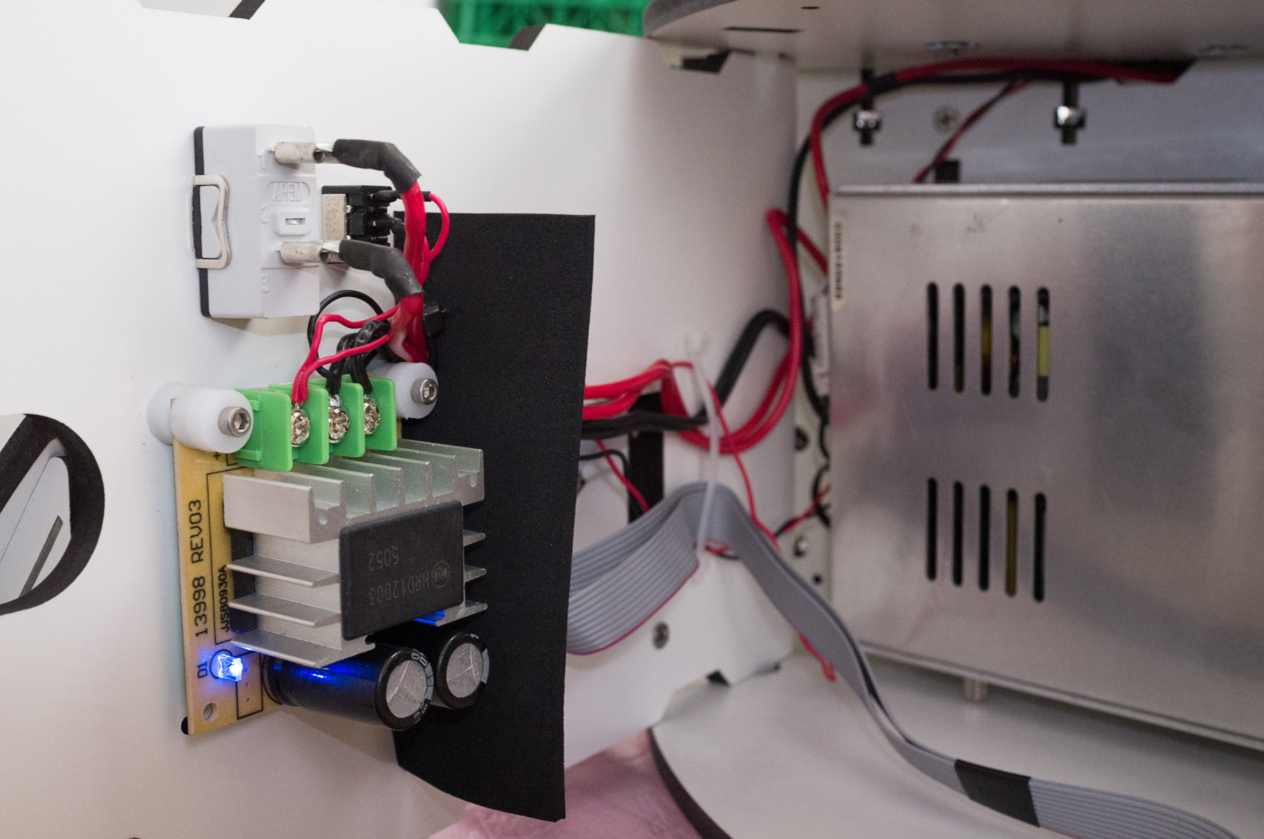

Additional 24W 300W power supply
I decided to add an additional power supply just for the heatbed. It's running at it's limits just with the heatbed and I didn't want to have unstable voltage for the steppers depending on the heatbed load, so I decided to let the original PC power supply in place (for the steppers and hotend). I cut out the opening for the fan, added rubber decouplers and a potentiometer to control the fan. I added also small feet so I'm not covering the air openings. The supply fit's just behind the LCD door.
12V step down voltage regulator
Now I have light even with the emergency switch hit. But the biggest advantage is, that the lights are not flickering when the hotend/heatbed doing their PWM.
The black foam is to guide the air which is coming out of the power supply through the finger hole of the door.

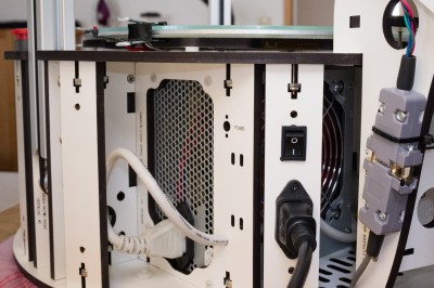

IEC socket and central switch
..to connect both power supplies.

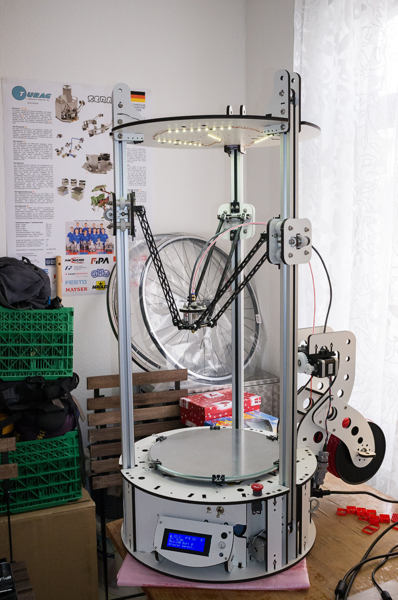

Overview picture
..with unsorted background ;)

For the drivers, they are designed for heats sinks on the back side not on top of the chip, so you did the right thing.

is your whole electronics setup run off of 24v? The steppers that seemecnc uses are rated at 12v. Are you noticing them getting any hotter at 24v if so?. I'm asking because I might do 24v setup myself but might run dedicated power to the onyx and seperate for the rest.
edit: nevermind i see u used a converter and the original power supply. looks good

I really like how you handled the spool holder! I've got some PLA from RainBot3D and they're too wide for the existing structure. I may get some new screws and print me up some spacers! :D

Post by Av8r RC »
I too just bought some material from RainBot, went and picked it up from them since they are local for me.
I just uploaded a kit of parts to widen the spool holder to Thingiverse. http://www.thingiverse.com/thing:60322

Markus, how has the Onyx been doing on 24v? There is no apparent trace lifting due to the increased current?
How fast does it get to your set temperature? Have you given any thought to running your hot end at 24v also?

Hello Carl,
it's doing well ;) Actually I can't see it, because it's under the aluminium plate. It gets to 100°C in about 5 minutes.
I adjusted the power supply to 23V, because it can not deliver enough current for 24V (at least when the bed is cold). Thats why I'm pulling the power for the hotend out of the other supply. But it's not necessary anyway. The hotend is much faster at temperature than the heatbed.
