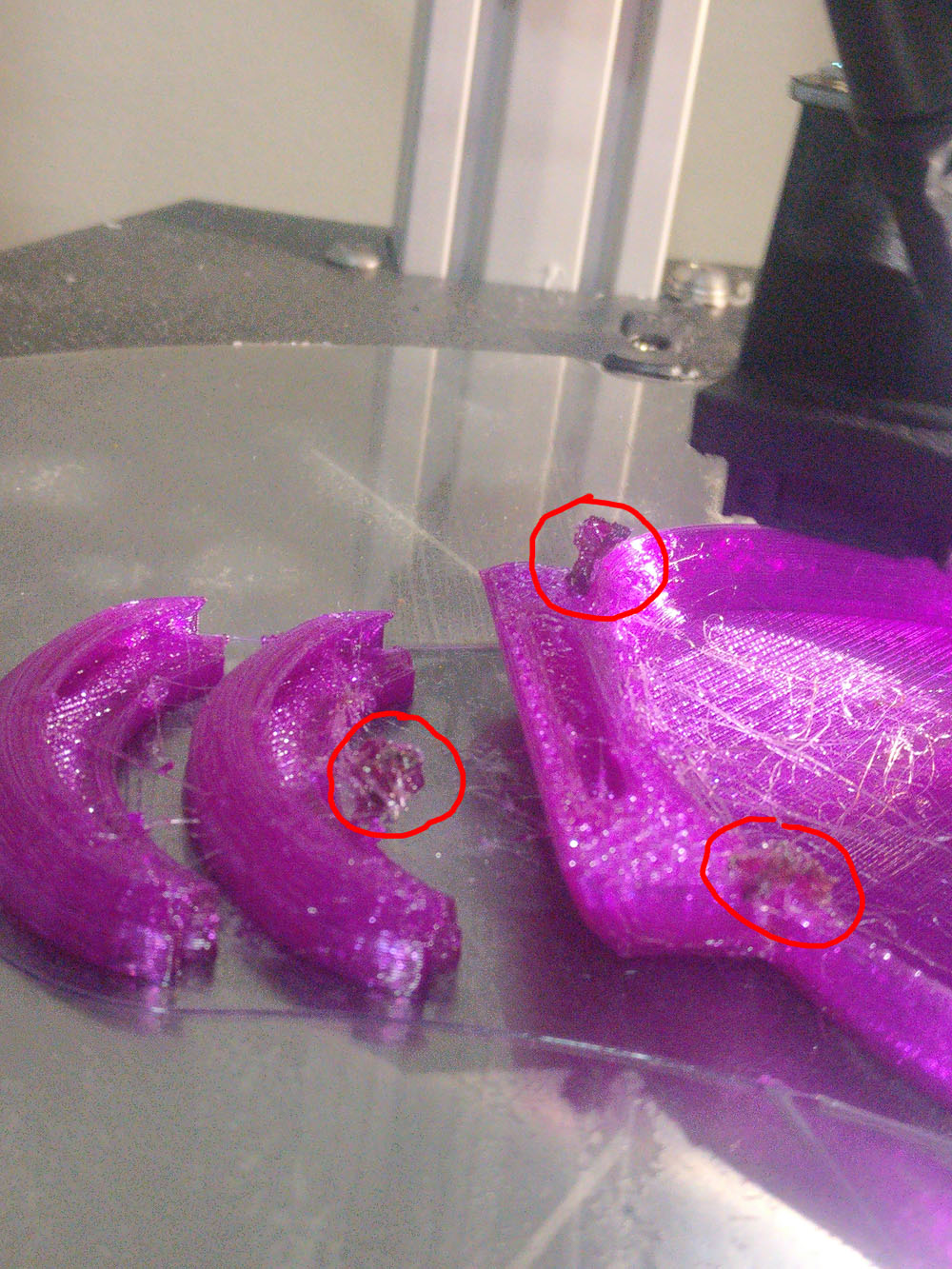

The big issue I'm having now are these random giant zits. They're huge and I've never seen anything like them before (maybe it's related to it being a bowden?).
The print is super stringy because it's TPU but I've had the same giant zit issue on the test print with PETG.

I wish I could help you out, but I've never printed with PETG before. I have heard that it can be quite stringy. You might want to check into the SeeMeCNC Facebook group (yech!) as there might be someone there that can help out with PETG.

I've figured out the issue - that filament was TPU, but the problem is that I think I had retract enabled, so it would keep piling up.
