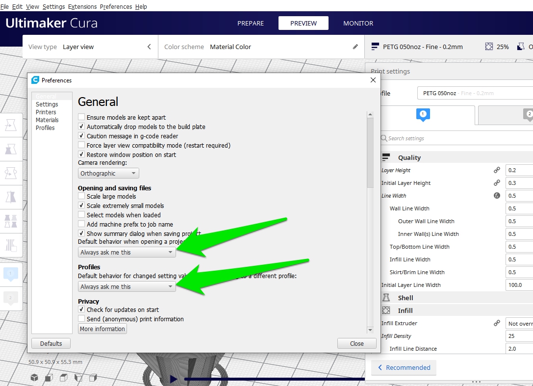

Now that I have the Artemis online and awaiting instructions:
1. The Artemis profile that is in Cura already only has 1 extruder and I can't seem to change it. SeeMe says to instead go into Add a printer and hit Next instead of choosing a printer model. But, 4.8 only has an Add button and forces you to choose a model, rather than having a Next button. I've added it as a Custom FFF Printer instead, so hope there isn't anything hidden or tricky I need to do further.
2. The 3MF file provided by SeeMeCNC is supposed to set up the printer profile as well as a sample dual-extrusion model on the bed, but you're supposed to "Open as Project" and 4.8 apparently doesn't have that option either. I have it set in general prefs to always ask when opening project files, but when I try to open this 3MF file, Cura does *nothing* at all.

Just double-click on the .3mf file and Cura should open it.

geneb wrote: ↑Sat Jan 23, 2021 12:38 pm Just double-click on the .3mf file and Cura should open it.
That just opened another instance of Cura with nothing in it.

Cura 4.8 won't work. It won't likely be fixed until the next release. We don't make software, we only advise customers to use what is proven to work, tested, and solid.
Take another look at your email from SeeMeCNC technical support Saturday at 4:20pm.
no YAT, no USB connecting. We do not run our printers through Cura. Cura only is used to generate Gcode and upload to the printer or run over an SD card inserted in the touchscreen.
We stopped recommending any USB connection in 2016/2017. Only this information:
https://www.seemecnc.com/pages/seemecnc ... tart-guide
Cura 4.6.2 is solid. In our guide (link below), STEP 5 has show you how to open the 3MF project file. This sets Cura 4.6.2 completely up in one step. The 3MF file would be downloaded in STEP 2 of our guide.
From the above Quick Start page of our website, you will end up at this Cura 4.6.2 setup guide. We are not supporting any other version (because they have defects and Cura 4.6.2 works perfect)
https://seemecnc.dozuki.com/Guide/Clean ... 41?lang=en
In Cura 4.6.2
  • go to Preferences.
  • On the "General" screen scroll to the bottom.
  • (see picture below) select "Always ask me this"
  • then close the window and try "File > Open Files.." in the menu bar again
  • Choose "Open As Project"

PartDaddy wrote: ↑Tue Jan 26, 2021 11:43 am Cura 4.8 won't work. It won't likely be fixed until the next release. We don't make software, we only advise customers to use what is proven to work, tested, and solid.
I just always keep my software up to date, is why I'm on 4.8 now - what differs in the newer versions that makes them unsuitable?

I did finally find the blinky batarang 3MF file, which I *was* able to open and get the profile into Cura with. If Cura will let me downgrade or double load 4.6.2 alongside then I can definitely try it, but I'll have to see.
