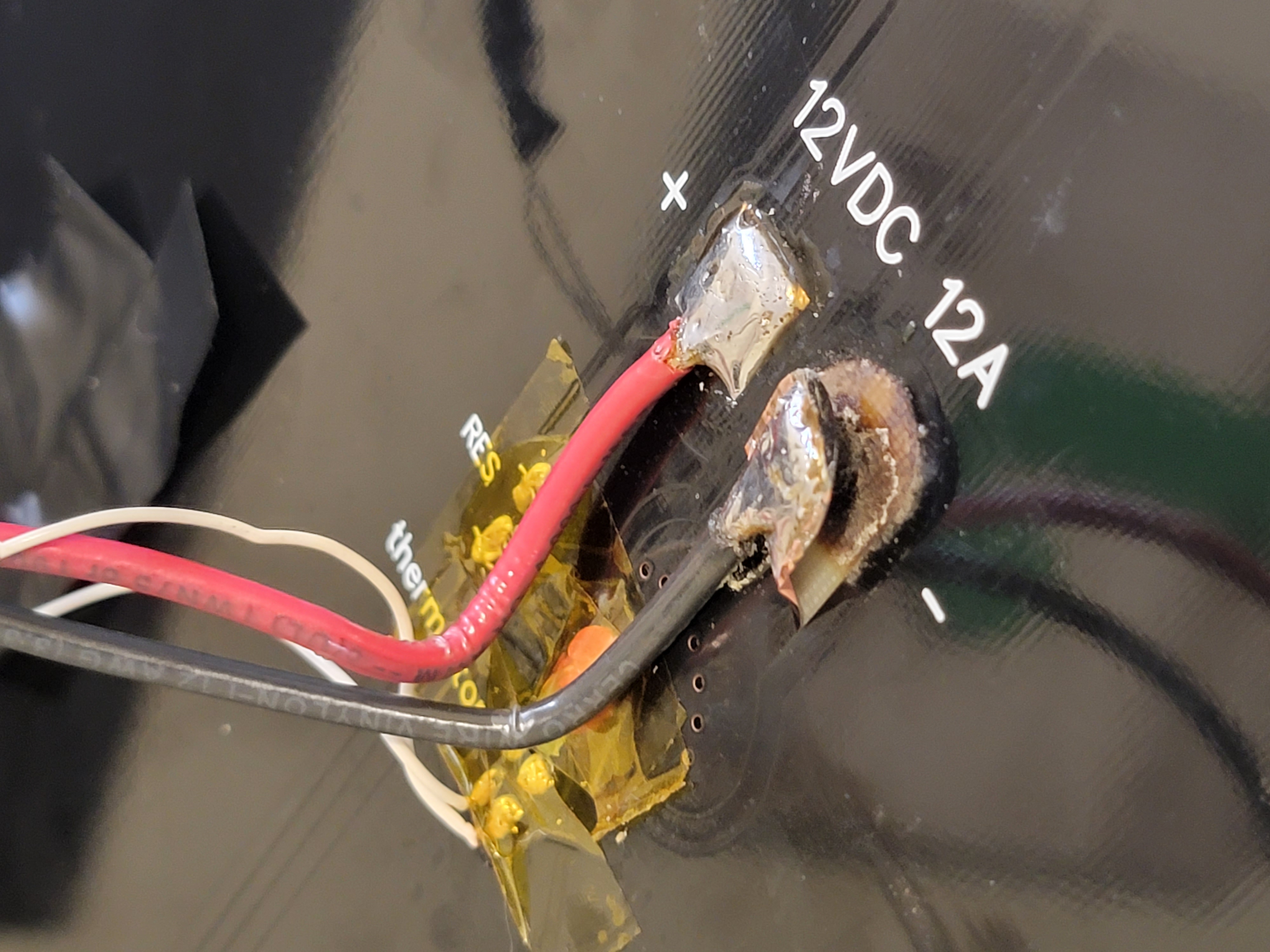

Rostock Max V2 Preheat Causes Software Crash
Posted: Fri Nov 05, 2021 3:22 pm
by srgntforest
Hi, Ive had my V2 since 2015, its been a wonderful time together, but lately im having an issue i cant solve. If the bed gets a current put to it ( to preheat) the software crashes. This is not random, it happens every time. the fuses on the RAMBo are fine, the wiring is not decaying. I recently updated the firmware from SEEMECNC's repository, and have a bone stock EEPROM.
Any Ideas?
Is my board tater'd?
Re: Rostock Max V2 Preheat Causes Software Crash
Posted: Sat Nov 06, 2021 11:34 am
by geneb
I would attach a voltmeter to the power supply and then try heating the bed. I suspect the power supply isn't capable of putting out enough power (or the heated bed or its wiring is shorted) and the power sag causes the controller to crash.
Posted: Wed Dec 01, 2021 11:50 am
by srgntforest
Hi. Thanks for the reply. It was indeed a broken curcuit at the bottom of the heated bed. Is it possible to buy a replacement for the onyx rev7?
Posted: Sat Dec 11, 2021 1:08 pm
by geneb
Thanks! Helped me remember a few things. ;)
