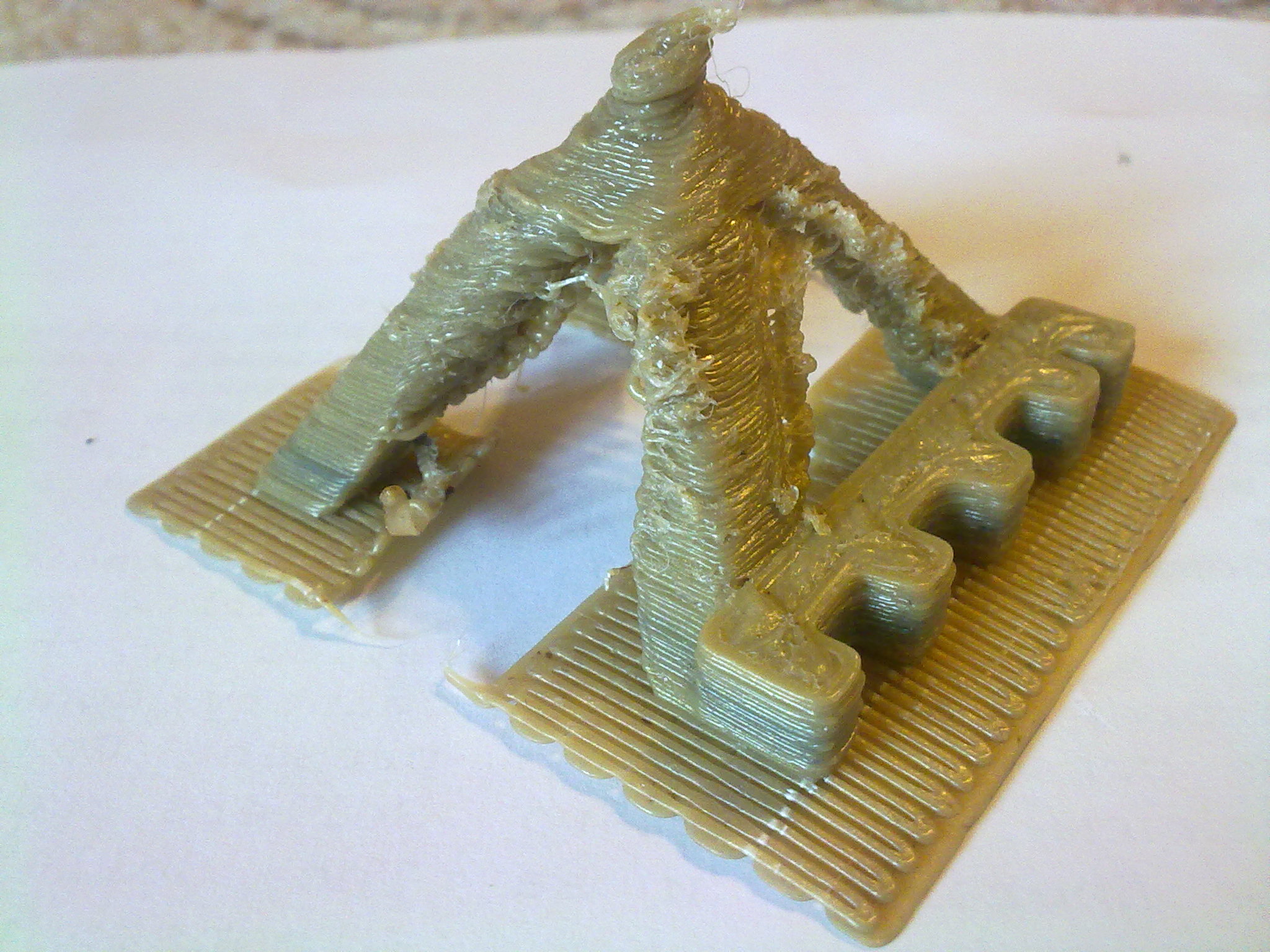

Hello everyone,
I'm beginner or first time user of 3d printing machine (just assembled Rostock MAX). Now I'm trying to print calibration pyramide object and need help on slicing settings (g-code generation). How to get rid of defects shown in the picture. Probably it's connected with retraction or z-lift settings.
I tryed slice3r, skeinforge, kisslicer and cura 13.03 to generate g-code. For now I stopped on cura (even I have some question with black screen).
Now I have following slice/printer settings

Thank you in advance.
