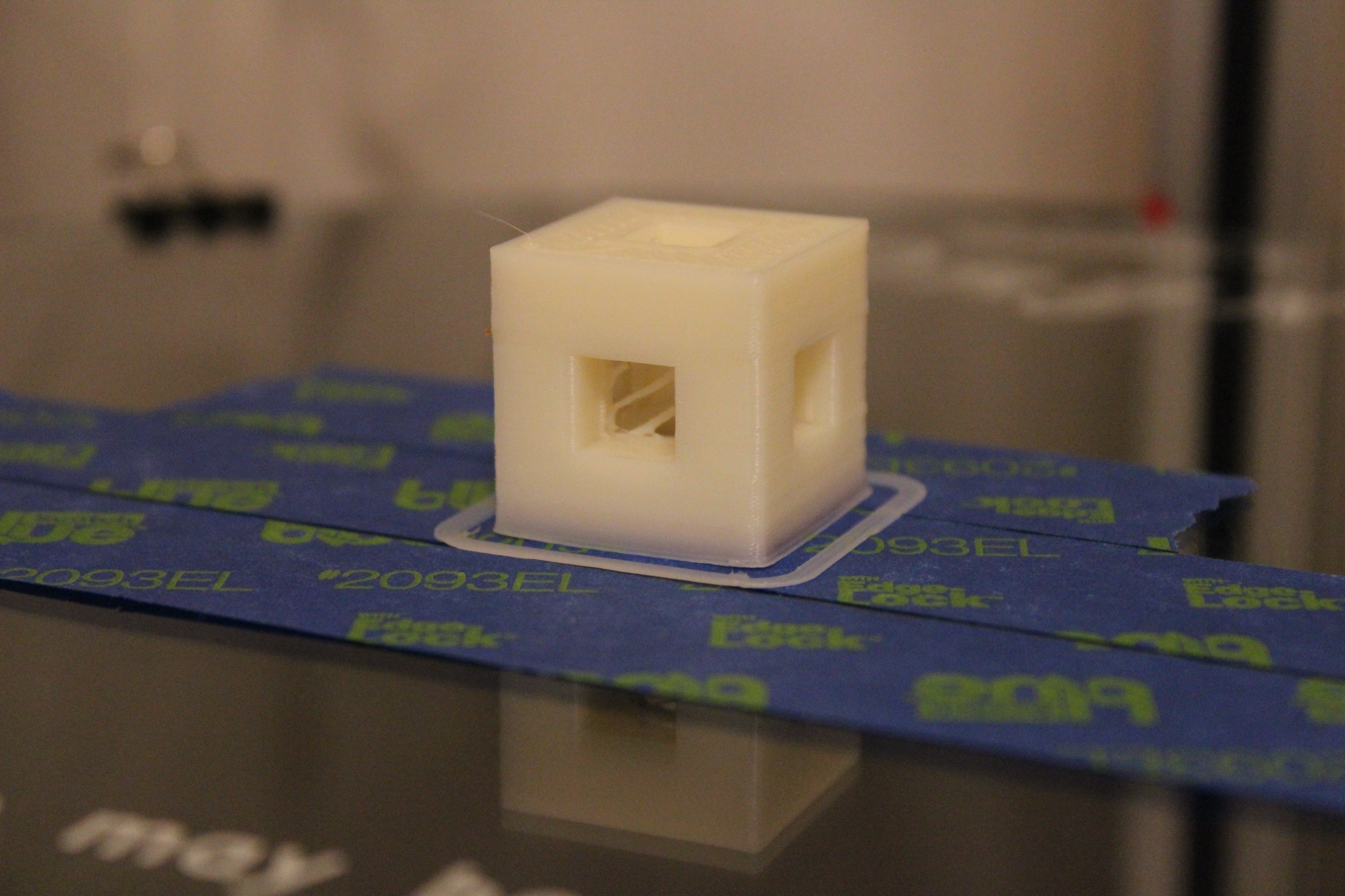

Last night I ran the first print on my Rostock MAX. My printer build was done almost completely "by the book." I did have custom build plate glass cut at a local glass company (cut in a D-shape to clear the electronics parts/soldering pads on the back of the Onyx Heater) and I also did all of the wiring "my way" (overkill-lite).
After performing all of the calibration steps in the Assembly Guide and on this forum I finally started the print. I set Z Zero using a piece of .004" thick paper and this kept the heated filament from sticking to the glass (?) when I first started printing. (Perhaps hair spray would have helped?) So, I killed the job, quickly added painter's tape to the build plate, and ran the job again. Here's a quick snapshot of the result:
For a "total newbie" at the reprap world I'm very pleased! With just a touch of tweaking I believe I'll be ready to go.

Congrats Bill!
Re: First Printer, First Build, First Print...
Great job! That looks really good for a first print, it looks really good for any print!

what type of glass did you use? certain glass types are known to crack under heat stress
Firstly, that's a great looking first print! Now some comments:
.004" is .1mm - that's too high above the glass. .001" is best. Use an automotive feeler gauge or thin paper (gum wrapper or cigarette paper is great)
What material are you printing with? PLA and ABS have very different methods for sticking to the bed. What temps are you running the bed, again this is dependent on filament type.
