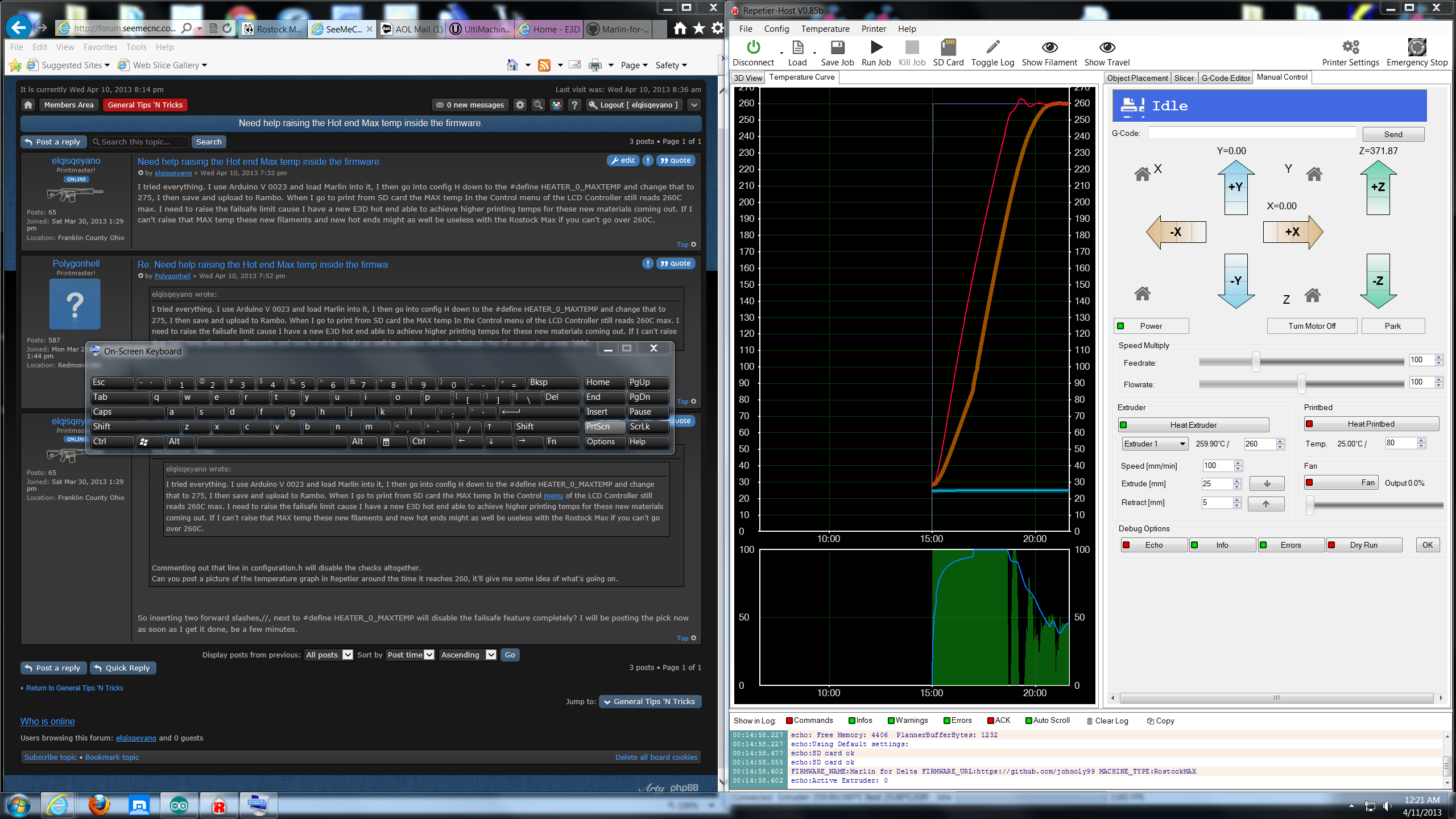

I tried everything. I use Arduino V 0023 and load Marlin into it, I then go into config H down to the #define HEATER_0_MAXTEMP and change that to 275, I then save and upload to Rambo. When I go to print from SD card the MAX temp In the Control menu of the LCD Controller still reads 260C max. I need to raise the failsafe limit cause I have a new E3D hot end able to achieve higher printing temps for these new materials coming out. If I can't raise that MAX temp these new filaments and new hot ends might as well be useless with the Rostock Max if you can't go over 260C.

Can you post a picture of the temperature graph in Repetier around the time it reaches 260, it'll give me some idea of what's going on.

Here is that image you requested...Polygonhell wrote:Commenting out that line in configuration.h will disable the checks altogether.elqisqeyano wrote:I tried everything. I use Arduino V 0023 and load Marlin into it, I then go into config H down to the #define HEATER_0_MAXTEMP and change that to 275, I then save and upload to Rambo. When I go to print from SD card the MAX temp In the Control menu of the LCD Controller still reads 260C max. I need to raise the failsafe limit cause I have a new E3D hot end able to achieve higher printing temps for these new materials coming out. If I can't raise that MAX temp these new filaments and new hot ends might as well be useless with the Rostock Max if you can't go over 260C.
http://imageshack.us/f/854/tempcurve.png/
Thermistor reading 260C but I put temp probe on hot end peek area inside and it reads 248 true temp. I am going to need more heat, I ordered hot end able to withstand temps up to 400C, not that I need it to go that high, I do need a max of 300C for these new Nylon materials that print at true 250C to 268C. It's the reason I want to disable the failsafe feature. I am not going to burn myself up.

At true 248C I can barely do ABS.

It seems to get there, but when I put my temp probe inside hot end area it reads 248C but repetier and LCD controller read 260 and hit the failsafe. So, I tried increasing the HEATER_0_MAXTEMP to 275 C so I can raise it to about 265 and get a good 250C. But the MAX Temp setting in the LCD MENU under CONTROL TEMPERATURE reads 260C. If I try to raise it passed 260C it won't let me, neither there nor where you control the actual temp, I turn dial on LCD controller clockwise but it maxes out at 260C. Not letting me get passed that temp to reach a good true 250CPolygonhell wrote:But you're setting it to 260 in the screen shot and it seems to get there.elqisqeyano wrote://#define HEATER_0_MAXTEMP 350

I just set mine to 275 which is my firmware limit without issues.
I just looked at the Marlin code, it doesn't clamp anything I can see on input, and all it does is busy wait if the temperature is higher than the safety number.
If you load up Repetier Host or and type
M104 S275
what happens?
M104 S275
what happens?

It heats it to 275 C. So even printing from SD card directly from the LCD I should still monitor through Repetier or what ever program so I can set it to higher temps through them?
Re: Need help raising the Hot end Max temp inside the firmwa
No if you have the temp set to 275 in the GCode file it would do the same thing.elqisqeyano wrote:Polygonhell wrote:I just set mine to 275 which is my firmware limit without issues.
M104 S275
what happens?
You'll have to re slice the object and change the temperature in the slicer to change the temperature to be higher.
You can watch the graph if you want, but it does you no good.

Oh my finally some one understands what I was experiencing. Thanks a bunch Poly, gonna be sending you a cracker. LOL Yeah I figured I could print without my computer being turned on, So everything I put in the Gcode transfers over and overwrites and prints according to my slice intructions
