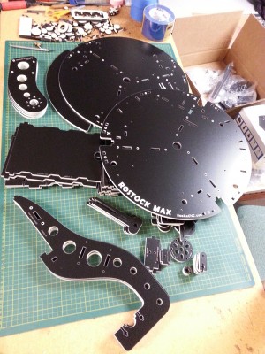

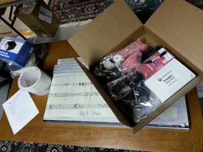

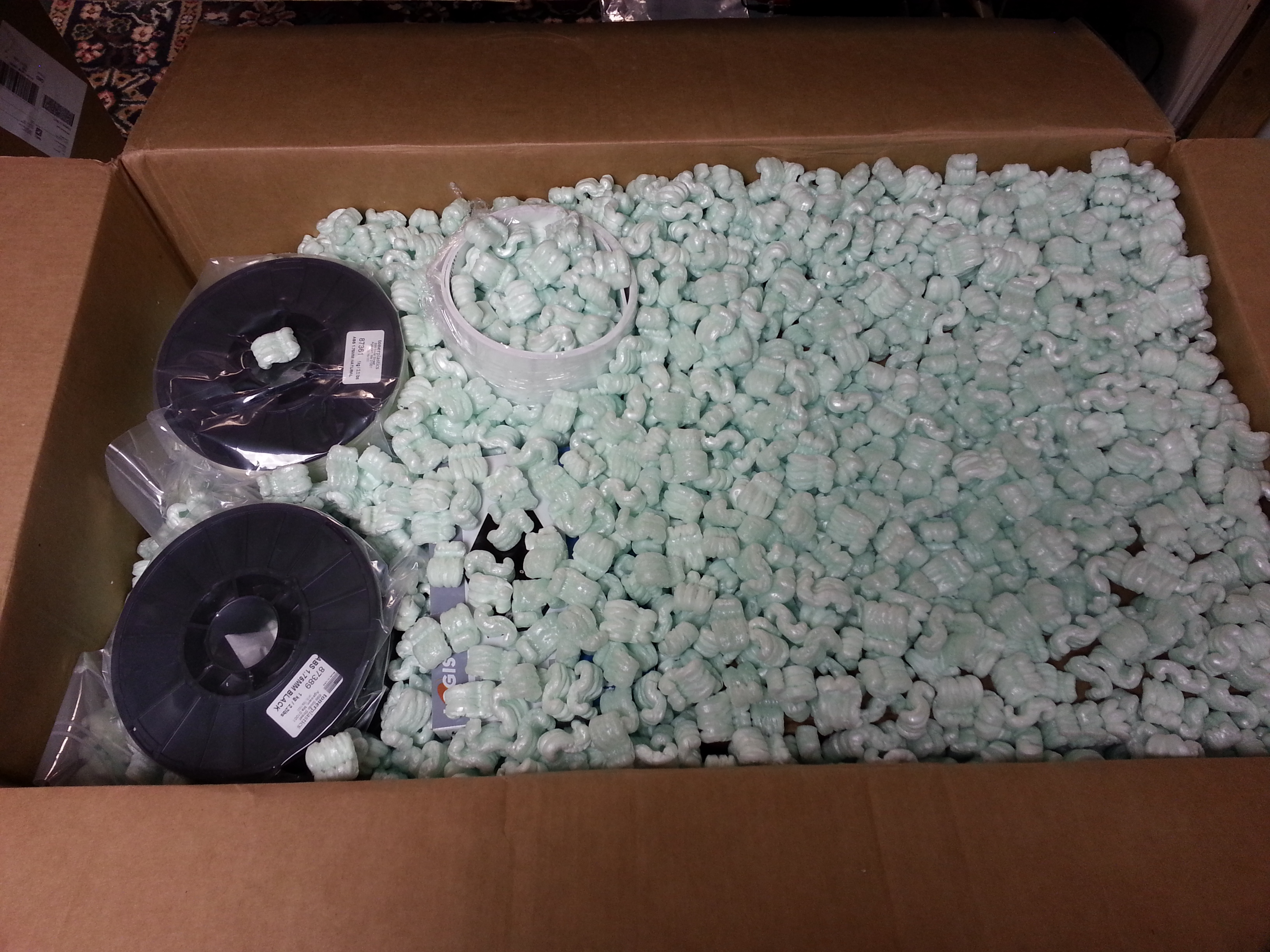

Ok, I finally found some time to post some photos of the beginning of my build. So here we go...
I have already built a Printrbot jr. That kit has been pretty successful. I have had some good prints and some failures. I only use PLA on it (no heated bed)
I do like the portability of it. It's very small! Enough Printrbot, onto Rostock MAX!
Received the box in good shape.
No external damage, always a good thing.
Nice packing!
Nice packing!
Who doesn't love packing peanuts? Thank the powers for a good shop vac.

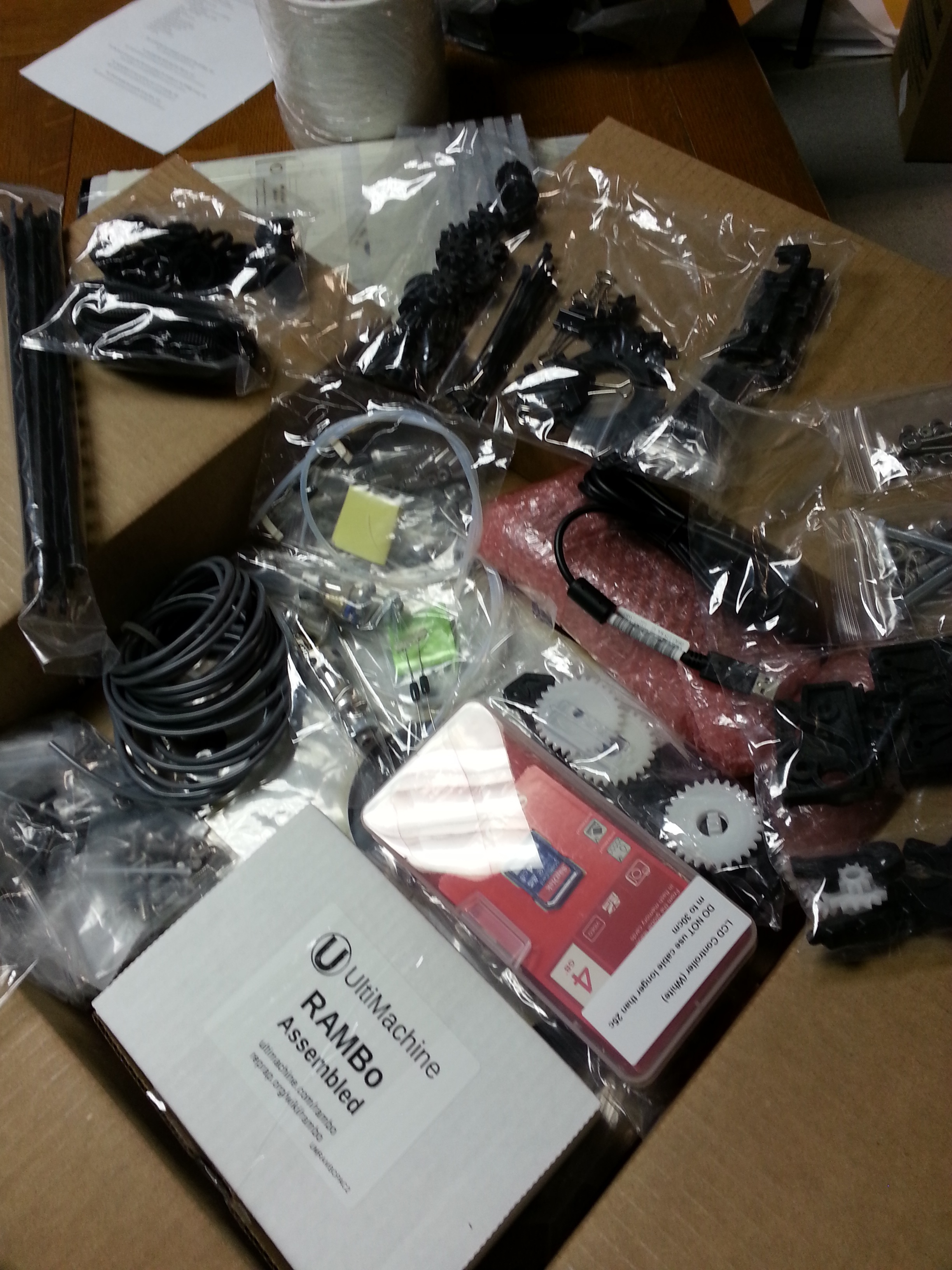

Taking inventory
Taking inventory
Lots of parts
Lots of parts
It all seems to be here. I didn't count every small piece, nut and bolt.

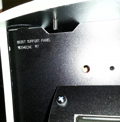

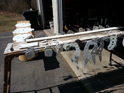

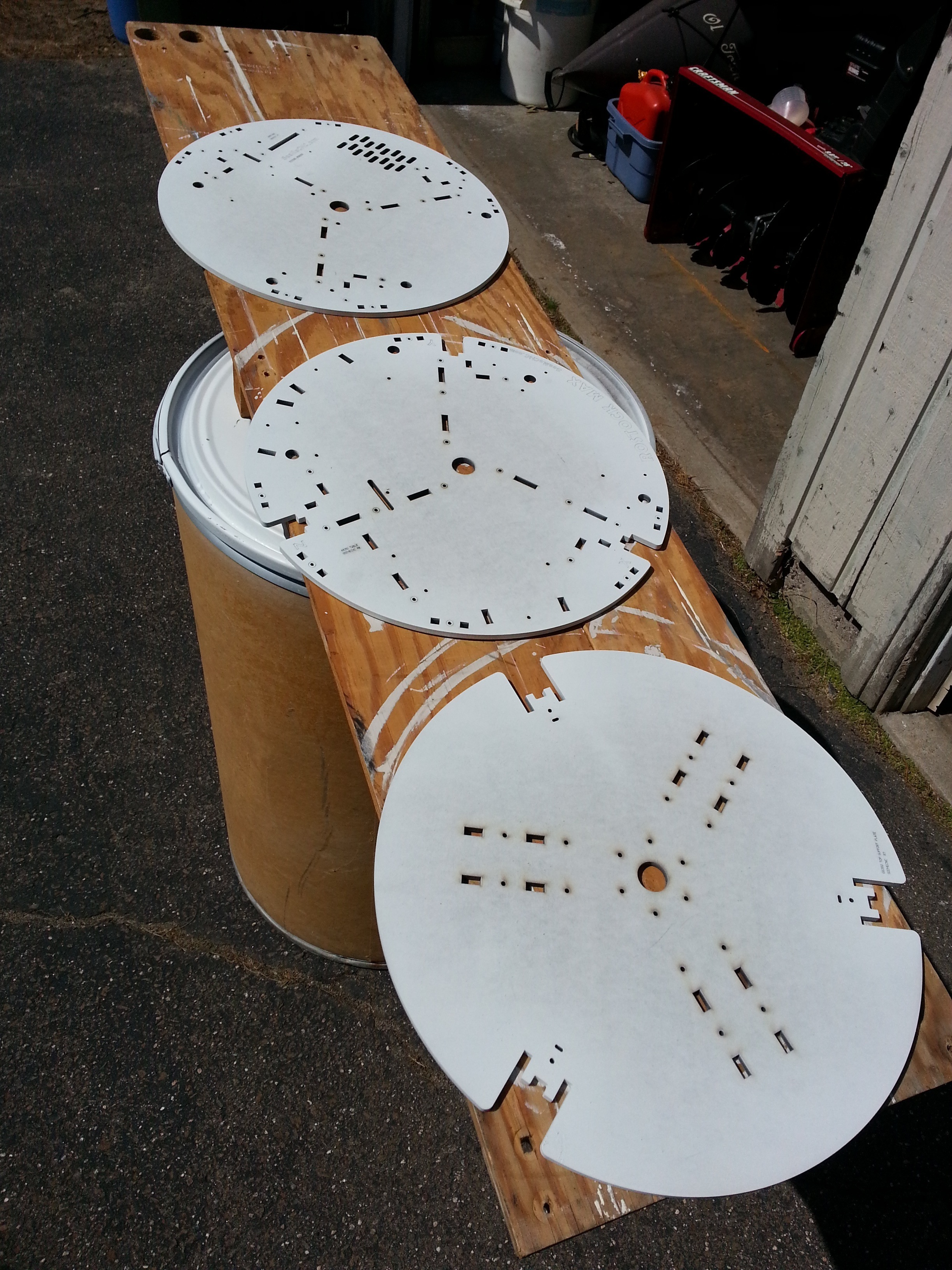

After inventory it was time to paint the edges. My daughter suggested white, so white it is.
Thanks for the pre-mask on the parts!
I read a lot of complaints on removing the masking on the forum. I would like to thank SeeMeCNC for giving me already masked and ready to edge paint parts.
Edge painting on a nice day.
Parts unmasked and ready.
A trick I learned from working in the sign industry- Use a hair dryer or heat gun to heat up masking tape and paper before/during trying to peel it. I peeled almost complete pieces off of the large bottom and top circles.

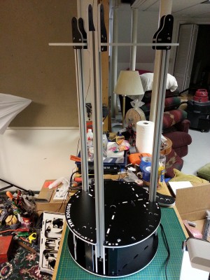

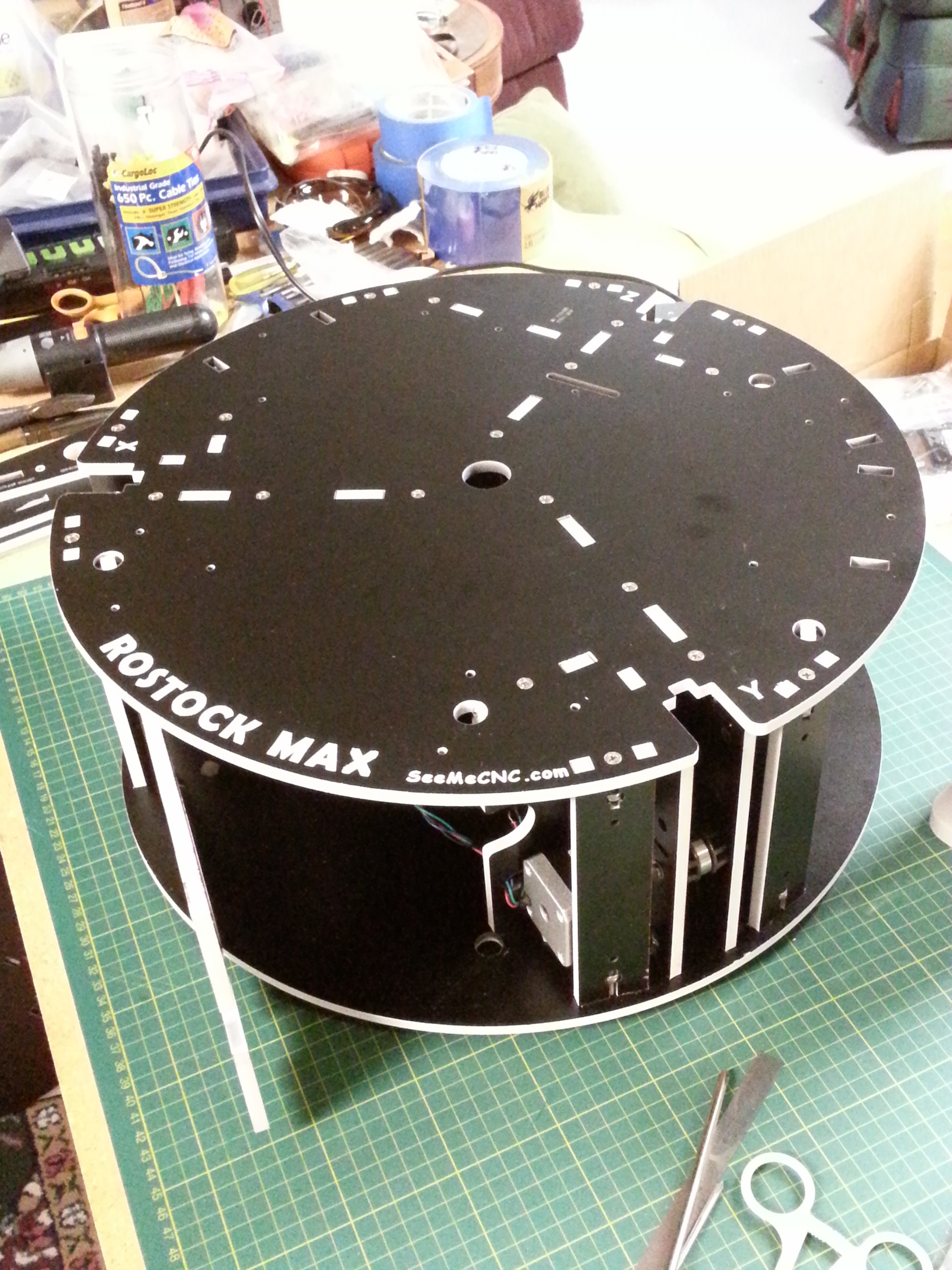

The base construction.
Having done my share of eletro-mechanical assembly, I think this part of the build I can handle. I will have some ?'s on electronics though. I'm still learning there.
Basic structure complete.

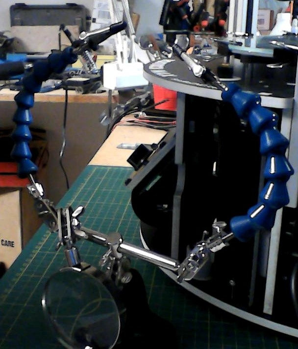

Basic struture done. Moving onto the bearing surfaces of the delta arms etc. My weapon of choice is this little warding file handed down from my dad.

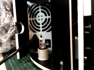

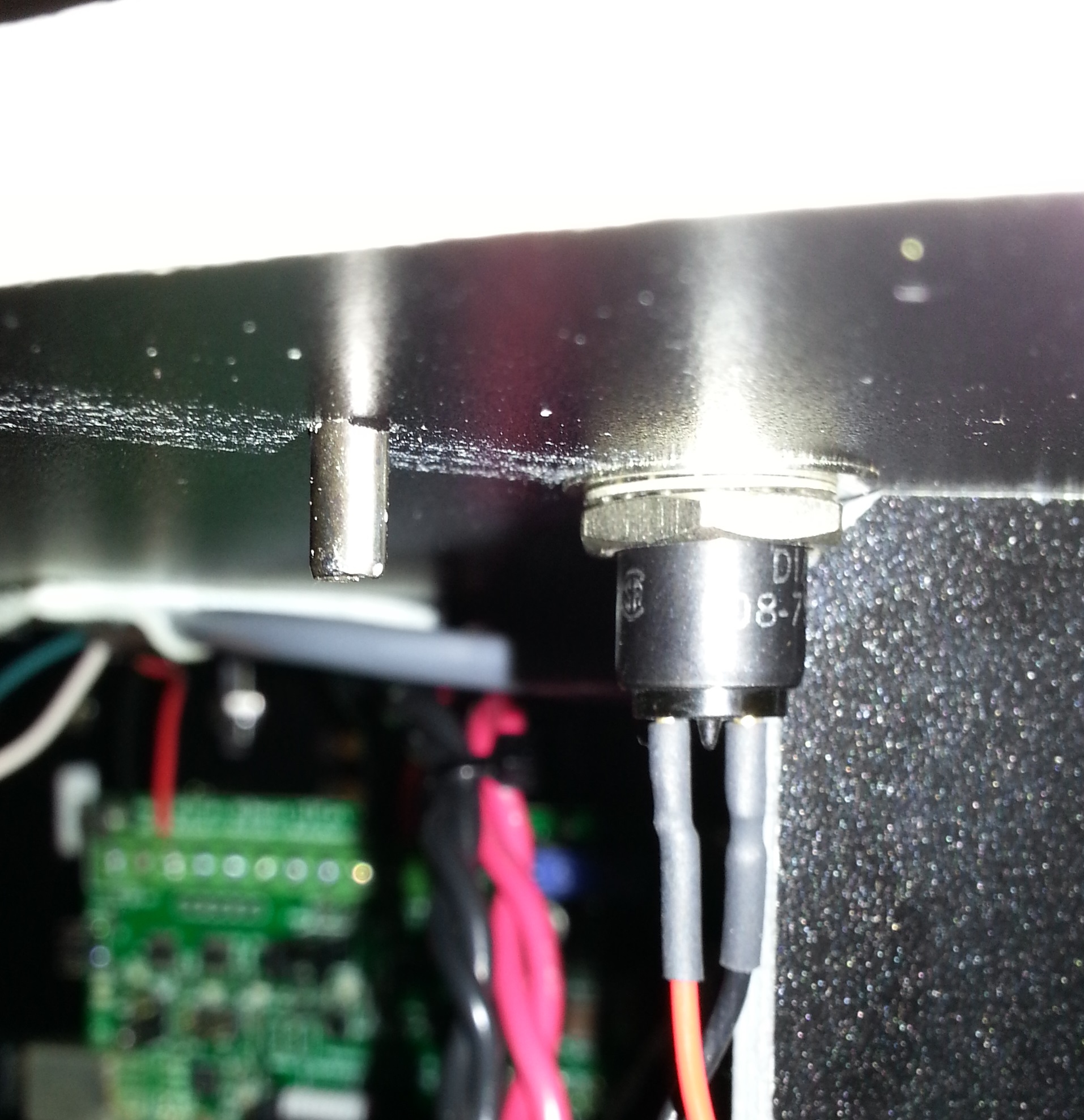

Had some interesting things happen with calibration:
-I switched my stepper pins to get the movement direction correct. That worked fine.
-I wanted the lcd/Rambo to be powered by the psu, so I moved the jumper pin. That caused an issue. My lcd stopped working? I was back to white boxes? I puzzled over it for hours and I was about to change some config settings. Then I noticed the "TX and RX" lights flashing yellow on the Rambo? Not sure, do these mean-transmission and reception? Anyway, I was looking at them and noticed my lcd adapter looked unplugged a little. It was. When I opened the electronics bay door. I must have strained the lcd cables enough to loosen the adapter. My fix uses a trick I learned in the sign industry. Use a roll pin as a stop. Fortunately the holes in the top of the MAX are perfect for 1/8th" pins. I have one in the hole over the "e" in "ROSTOCK MAX SeeMeCNC.com" logo. It keeps the door from closing the whole way, that keeps it from interfering with my mod of the heater bed caution light mounted there. The other is to the left of the "R" in the logo. It keeps the door from opening the whole way. I'll remove it if I need to do maintenance in the bay. Lesson learned-Always check your connections!
I'm getting ready for my first print, hopefully tomorrow. I'm sure I will be posting my progress, good or bad:)
roll pin that keeps the door from hitting my caution light.
roll pin that keeps the door closed, so I don't yank out my lcd cables.

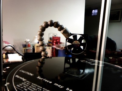

I think my calibration pyramid would have done better with a bed fan. So this is my addition:
locline fan
locline fan

Re: Batteau62's Black w/ white edges MAX build
Batteau62, I meant to ask you this before but I forgot, is that fan on the end of the flexible arm a Thingiverse item?
Batteau62
Posts: 389
Location: Connecticut
Post by Batteau62 »
No, but this is the same thing. http://www.thingiverse.com/thing:9457 And if you search "loc line" on Thingiverse you should find more. The fan is out of an old psu. The connecting piece from the line to the fan is custom by me. It's just a piece of pvc pipe machined to fit the corner of the fan. I love this stuff, it's great for a wire run, bends in any shape you need and protects the wire. I have a smaller version on my "third hand" for soldering. Attach an alligator clip, bolt it to your stand and you have an unlimited amount of motion. :)
