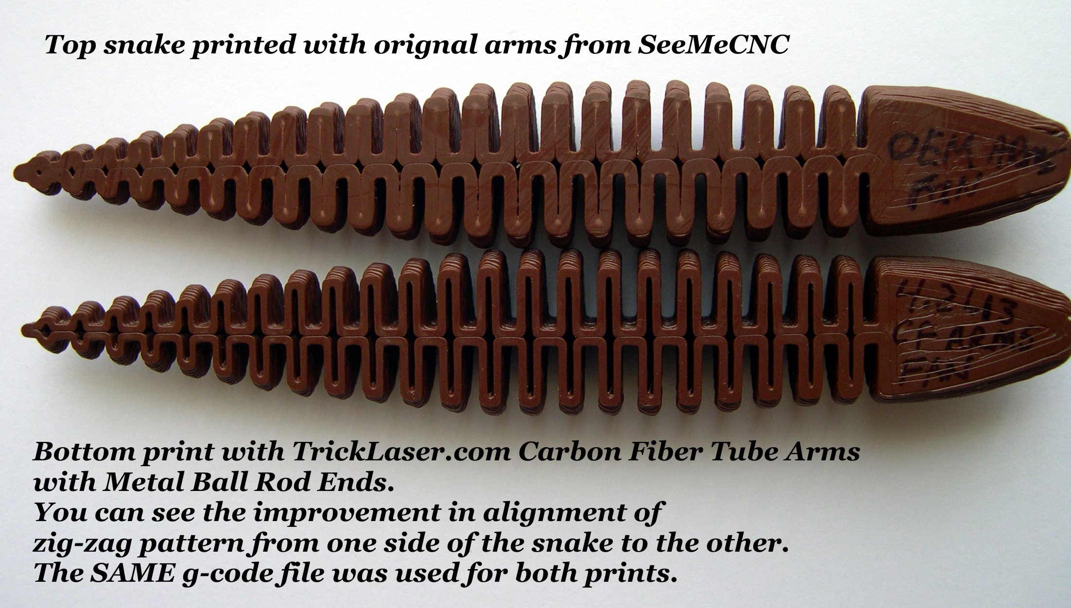

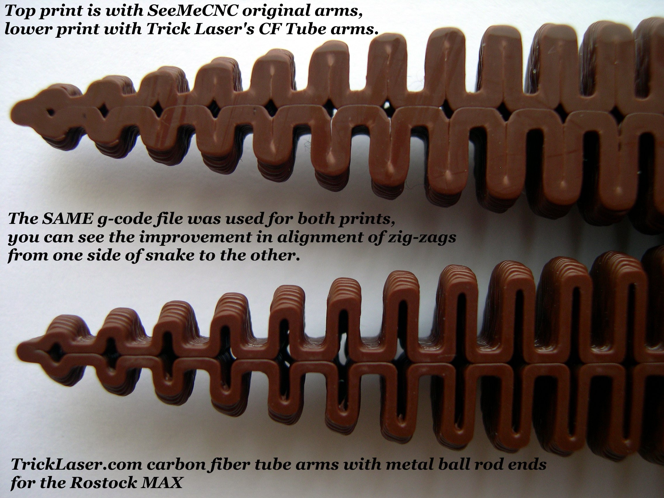

Trick Laser CF Arms print quality example
Here is a example of the improved print quality with the carbon fiber tube arms from Trick Laser.
another picture of the same prints.
(top print was hotter and without fan, that is why it is fatter) btw, I am also getting nicer prints by using a small fan beside bed, blowing over print. yes, with ABS. Also wrapped the hot-end in a bunch of kapton tape to insulate it from radiating heat onto print making it mushy.
Re: Trick Laser CF Arms print quality example
looks great..definitely worth the upgrade for a more quality print. i got mine on ready to try out.
I wish mine would hurry up and get here, it seems I have so many arm mods to experiment with these days.
Nice improvement to be sure.
And to be fair the originals don't actually "suck" but they are not nearly as nice eaither.
Can you do another print where both have the same cooling?
It would be easier to see the differences.
Huge difference there. Now we need to see if there is a difference between the Trick Laser arms and
the Chinese arms. Thanks for the pictures, remarkable difference in print quality. Everyone who sees this
will want your arms.
