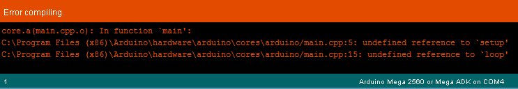

I'm running calibration per geneb manual. I am not an arduino guru or code writer. Here is the error I get:
Arduino compiling error.png (5.97 KiB) Viewed 3048 times
Thanks in advance!

What version of the arduino IDE are you using, you want to be using 1.0X

Ok, so I figured out that you actually have to choose a file to upload(duh!). I used the Repetier-master from SeeMe downloads. LCD seems to be working, that's good. Sent G28 and the Z axis (only) started down, X and Y stayed put? That's bad. Turned power off. Turned power back on. Tried moving Z axis up-it moved down. I think I need to switch some motor pins. I don't understand the G28 weirdness though? Help...
Using Arduino 1.0.5
