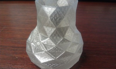

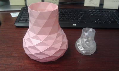

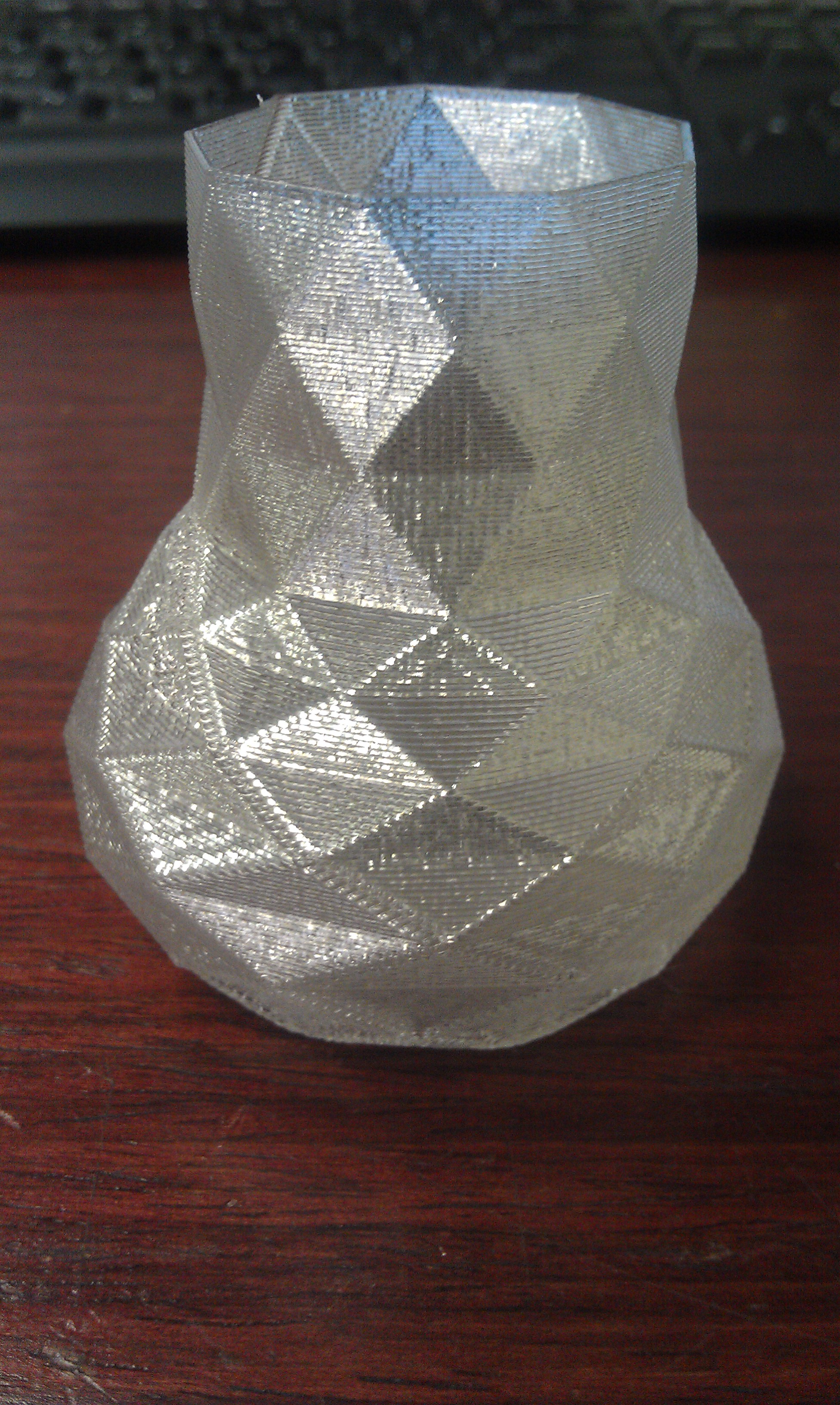

It's taken me a little bit, but I think I've gotten this new filament figured out a bit...
210 seems to work best for me.
70C bed.
I have the E3D .4 nozzle. Per Taulman, I set my nozzle diameter to .5mm and layer height to .40mm.
I have tried printing with a cooling fan, but I don't notice any difference with a fan.
It's got some very interesting characteristics. Very cool looking, and seems to be very strong. Much stronger than PLA.
My biggest gripe is that it requires very slow print speeds.
Anything more than 30mm/s, and my struder skips and the filament kinks. (The big one is spray painted pink in order to try to convince her that 3D printing has potential in the home decor world...)
I'd love a 1mm or 1.2mm nozzle, but I've ordered the .6mm from E3D.
I'll post more pics as I print anything noteworthy.
For now, my Russian doll vases will have to do...
