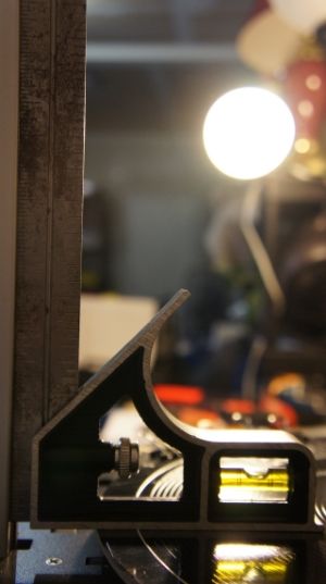

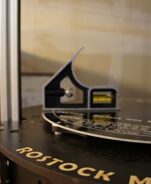

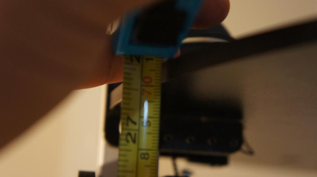

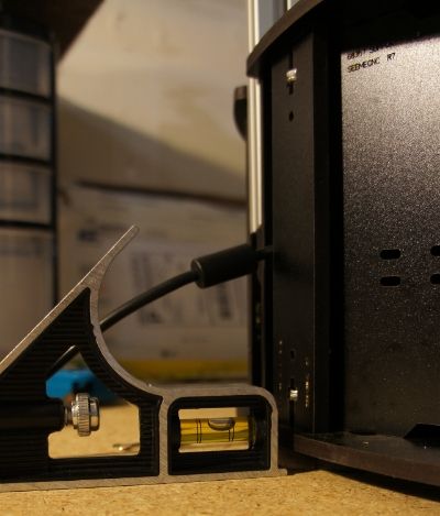

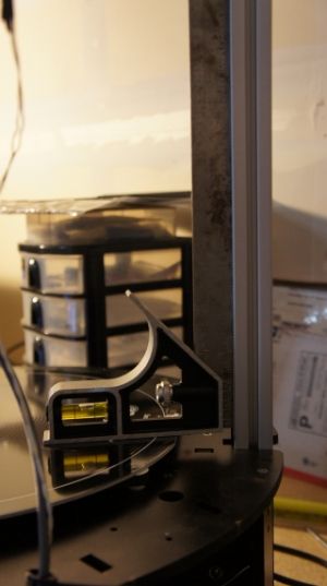

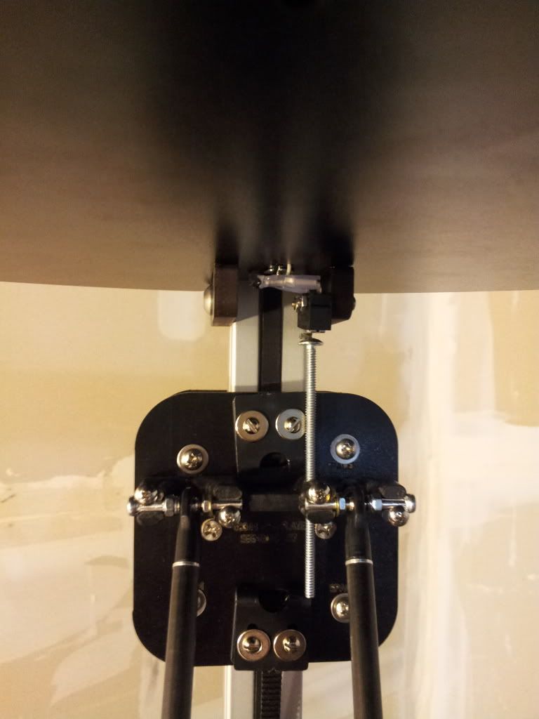

1) From the heat bed to all 3 endstops is 670mm (+/- 1mm)
2) From the base to the top "plate" is 702 (+/- 1mm)
3) "G0 Z0 F3500"= 18mm off the center of the heat bed.
This is what My X-Azis looks like at G28:
[img]http://i1326.photobucket.com/albums/u65 ... 446ff2.jpg[/img]

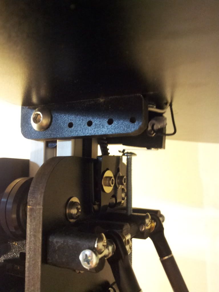

This is my Y&Z Axis on the endstops at G28:
[img]http://i1326.photobucket.com/albums/u65 ... 23bb24.jpg[/img]
At present, I am calibrating per genebs instructions:
