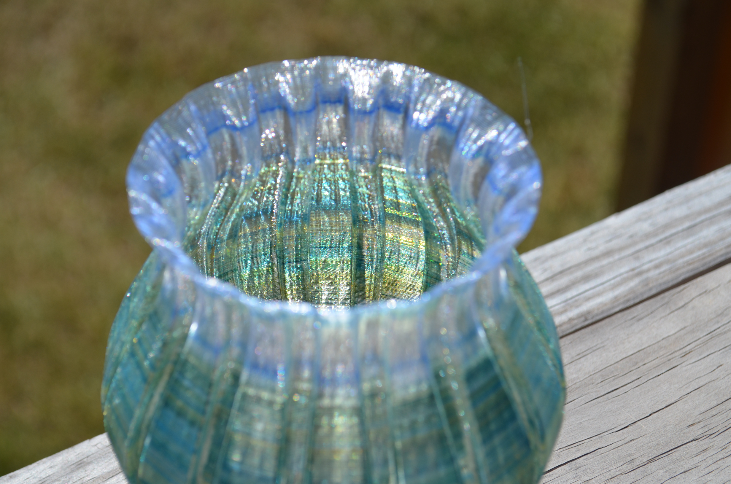

T-Glass Vase
Posted: Sun Sep 15, 2013 12:25 pm
by Zerosink
just can't get the photo to show how awesome this looks.

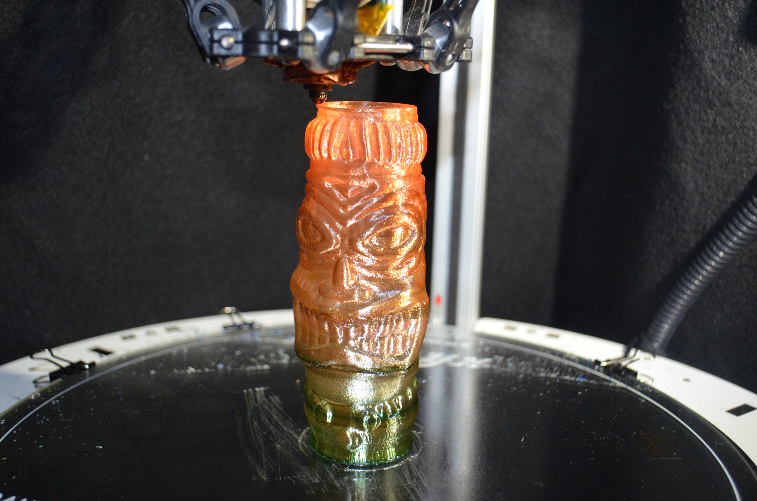

by Zerosink
30 mm/s, 215 hot end, 60 on the bed till the bottom 3 layers were down then dropped to 40 for the rest of the print.
0.3mm layer, vase setting in Slic3r.
It has a hologram effect to it, changes as you tilt/turn it.
I am very happy with it :)

by Zerosink
The larger one ... I bumped up the speed to (30mm/s) x 120% and bumped the temp up to 220.
The first 3 layers don't like the speed. Had to do them at 30mm/s and slicer slows it down to 30% of that
so 10mm/s on them. Looking at them real close I can't see any diff in what the speed or temp did.
Here is the first 40 min of the big one sped up 10 times :)

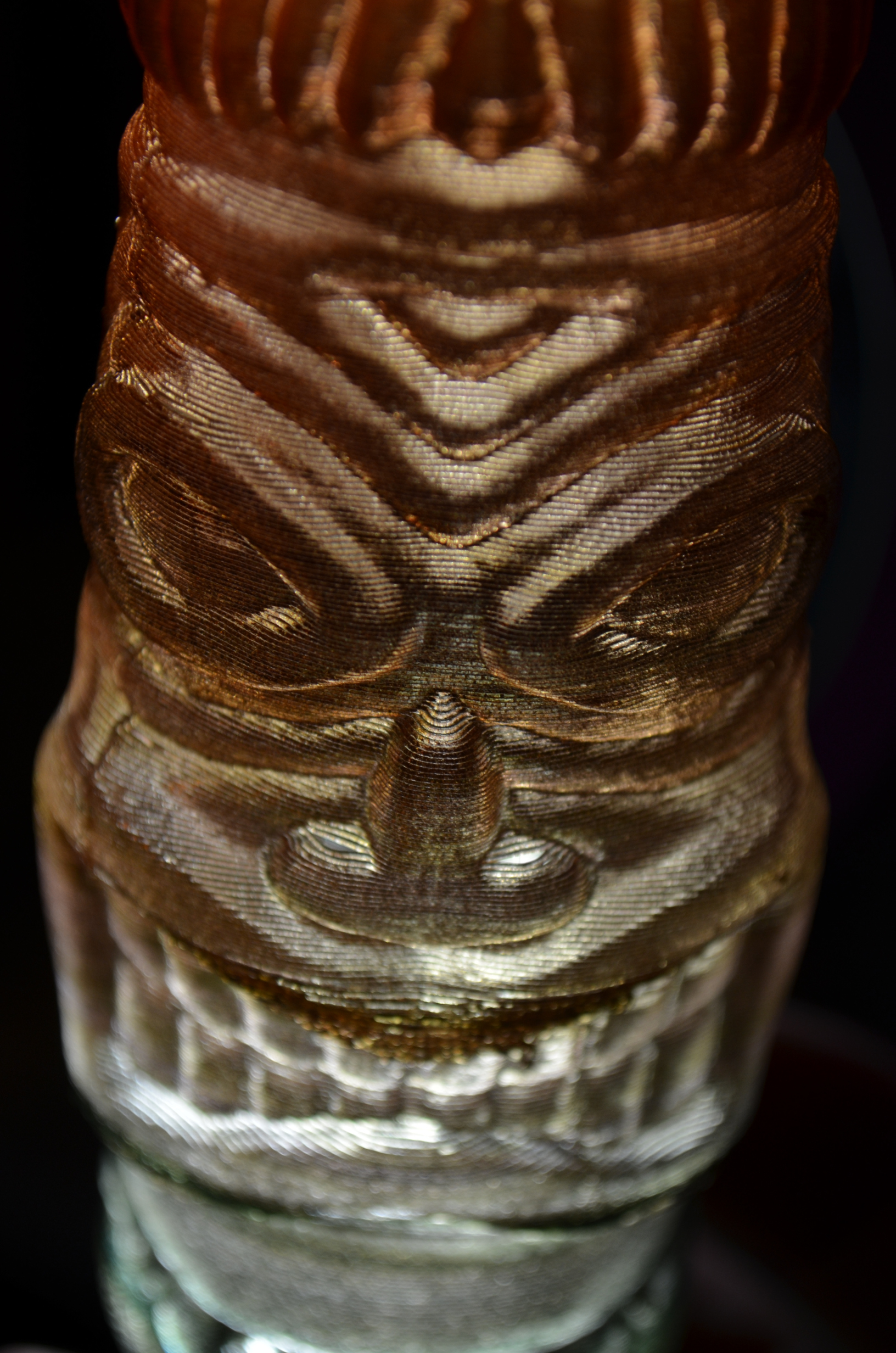

Ummm... I use a Sharpie :)
If you mark only 1 side of the filament it gives a really good optical effect as you tilt it up/down.
Diff effects depending on what side you mark. Colors may change when you print, red sharpie makes a good Gold :)
You can see the color through the clear part of each layer.
I can "see" through the tikiman... but can't make the picture show it.

OK... I just couldn't splain how good this colored t-glass looks :)
This is how I sharpie-colored the Tiki man t-glass.
In the photo I used PLA for its contrast. You can see it is a small thin stripe.
That lil thin red stripe made the gold color on the tiki man.
Now the results, a tilt-test :)
