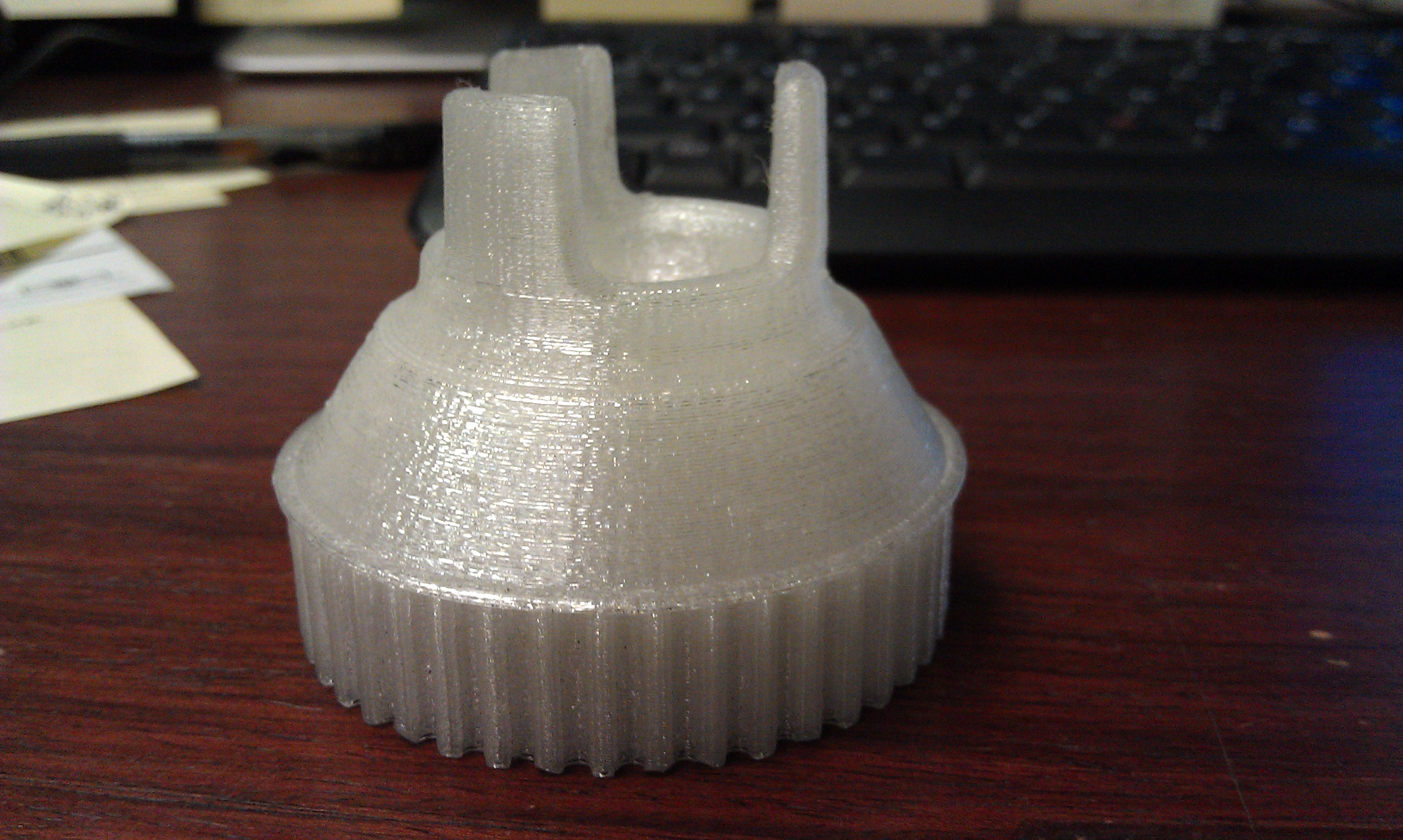

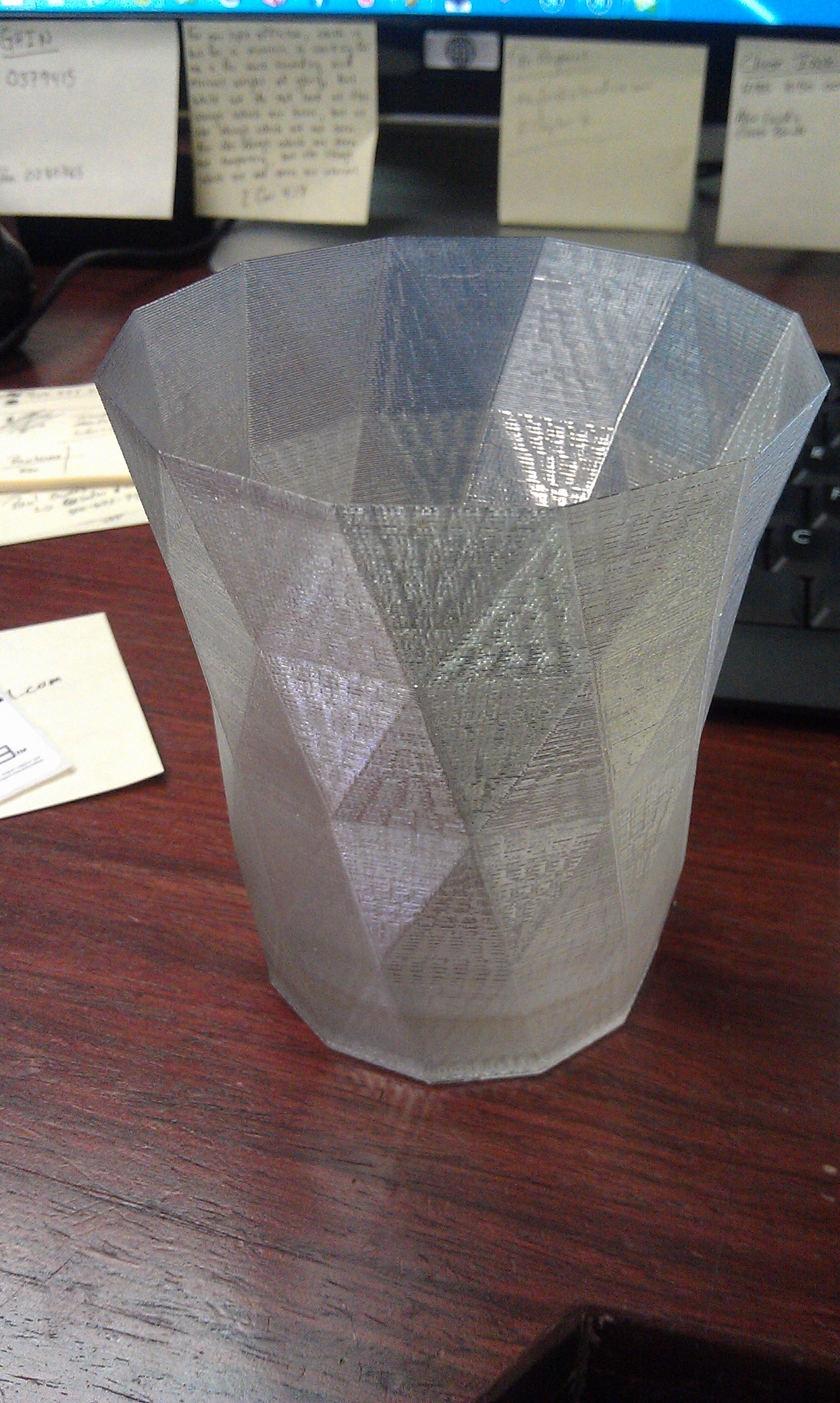

Hard to compare settings because I've got the E3D hotend.
I had virtually no issues with T-glase - other than the price :)
Does it seem to clog after retracts? After a certain amount of time printing? What speeds are you printing at? What speed are you retracting?
I don't know if PETT is subject to creep the way PLA is, but if you are able to print small items with no issue, but larger ones clog, then throw a PEEK fan on and see if that fixes the issue.
I printed at 212-214, speeds at 30-40mm/s max, .375 layer height, heated bed to 60C, retraction 10mm @ 60mm/s.
I got results like this...
which I use every day as my water cup in the office.
It's cool stuff. If it was cheaper, I'd use it more often.

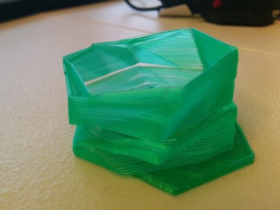

I'm having some trouble with being able to pull apart each layer pretty easily once the print is done and cooled.
I'm printing very slow at around 14mm/s @ 218 (have tried as low as 212 and as high as 222). I have a .5 nozzle but have not tried putting it to a .6 nozzle in the software. I am currently printing at .5 layer height.
DavidF
Posts: 779
Location: Delaware
Re: T-Glase Troubles
Post by DavidF »
Try printing at .3 layer height...

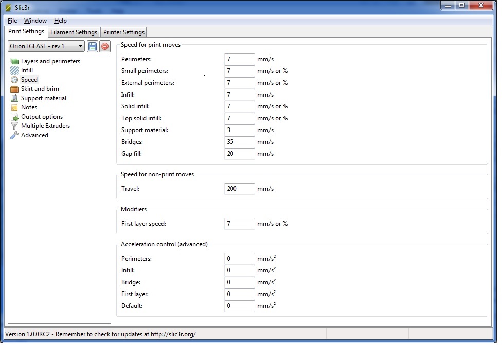

Post by cyrus104 »
I'll try and upload some photos soon.
Latest print .3mm @ 222 and 10mm/s is the best I can do. I do have a fan on and the fan turns on to around 50-100 percent based on print time.
The .3mm is looking better and stronger bonds between layers. It does not look like I'm able to print any faster though.

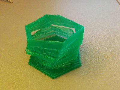

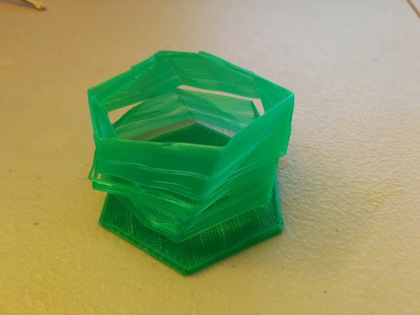

Post by cyrus104 »
Here are a couple of pictures of an object after it cooled and I played with it. I will take pictures of a fresh object. I did some of the pulling apart on these pictures but most of the splitting was done during the print. This one was printed at 7mm/s, any faster and it either won't print properly or the ezstruder gear skips. I've made sure to clean the gear and as soon as I switch to ABS it prints perfect.
This was printed at 218C or 220C.
DavidF
Posts: 779
Location: Delaware
Post by DavidF »
The pictures, that was at a .5 layer height right? On a .5 mm nozzle.... No squish with that combo.
