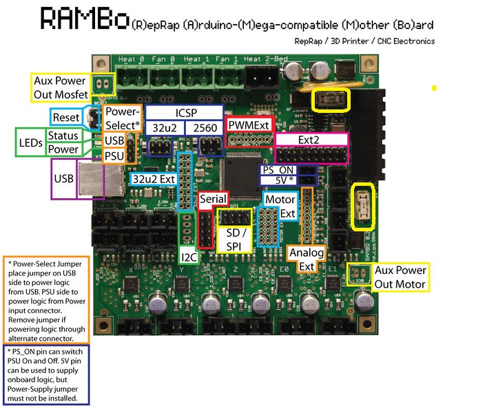

[/size][/size] hi, my school recently bought one of the Rostock max kits. the thing is now completely built. but now when we plug in the power supply and flip the switch the Rambo board does not light up, -the PSEL jumper is hooked up so that it is on the lower 2 pins (shown in manual) -power strip(input coming from power supply) is connected to board and does supply 12v on each pin(checked with multimeter ), when i attach the usb cord to it ,and that to the computer ,nothing still happens,but when i change the PSEL jumper to the top 2 pins the board lights up and connects to the computer. of course this won't help it because that would mean it was running from the computers supplied 5v. so far for me that means that the power supply is giving 12v but the board is not taking (i checked power in pins connected directly to board with multimeter=works), the fuse is not blown, no wires are detached or reversed from needed position.

There are 3 fuses on the Rambo, did you check them all? (One big fuse, 2 little ones in small sockets)david wrote:[/size][/size] hi, my school recently bought one of the Rostock max kits. the thing is now completely built. but now when we plug in the power supply and flip the switch the Rambo board does not light up, -the PSEL jumper is hooked up so that it is on the lower 2 pins (shown in manual) -power strip(input coming from power supply) is connected to board and does supply 12v on each pin(checked with multimeter ), when i attach the usb cord to it ,and that to the computer ,nothing still happens,but when i change the PSEL jumper to the top 2 pins the board lights up and connects to the computer. of course this won't help it because that would mean it was running from the computers supplied 5v. so far for me that means that the power supply is giving 12v but the board is not taking (i checked power in pins connected directly to board with multimeter=works), the fuse is not blown, no wires are detached or reversed from needed position.

where are the two small ones? are they the two tan little things and if so how do you check them?

ok I checked all three fuses(assuming the other two were the tan ones near the power supply in) the large fuse is good, but one of the other little fuses is blown(checked by continuity). do you know where we could get another of these?

The yellow boxes are the small fuses, ignore the box at the bottom where there is text, you can use your meter set to measure ohms and make sure the fuses read 0 ohms
when you connect to each side of the fuse. (take the fuse from the socket with no power applied first)
If the fuses are bad, see this link for part numbers and you can use up to 10 amp fuses, the originals are 5 amp

Given that one of the fuses may be blown, you should also first check all of your connections and wiring and make sure there are no stray wires going between connector terminals after replacing the fuse but before applying power again.
