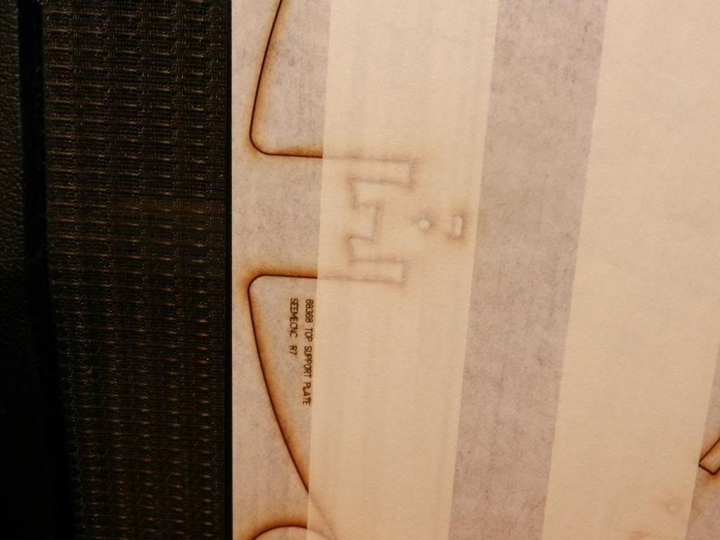

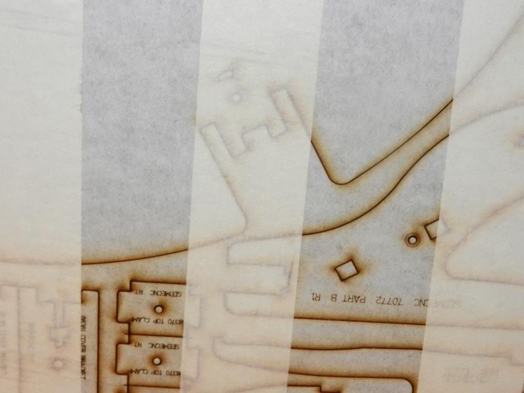

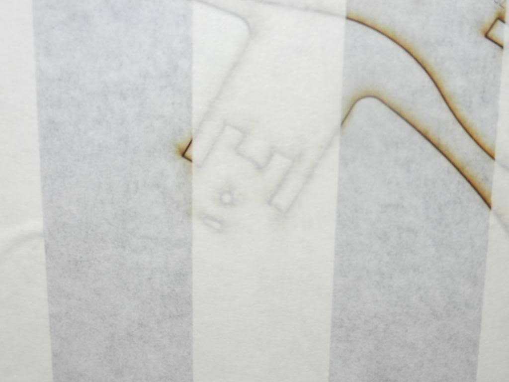

Inventorying the melamine parts has revealed a potential first problem. The Top Support Plate seems to be badly cut. Here's one of the notches:
[img]http://i243.photobucket.com/albums/ff27 ... 2f1179.jpg[/img]
Notice how out of square the legs are. Here are the other two notches on that Plate:
[img]http://i243.photobucket.com/albums/ff27 ... f92ec1.jpg[/img]
[img]http://i243.photobucket.com/albums/ff27 ... 738aaf.jpg[/img]
Those two look pretty good. I'll be emailing SeeMeCNC later tonight to see if this needs to be replaced. Now on to inventorying that box of parts!

That sucks :( You may be able to get by with it like that though, since I think nothing actually relies on that particular part to be angled perfectly. Just don't butt the tower up against it as it might give it a little unwanted twist. On the other hand, if you're willing to wait on shipping for a replacement, I'm sure SMC will replace it.

Yeah, had an email from John already and they'll send out another plate. He checked the ones they had in the shop and they looked OK, so it's just a one-off glitch. As Gene says in the manual, the laser sometimes goes off on its own. :)
Plenty to do, so I probably won't even get to the top plate before it arrives. Just finished getting all the other pieces out of the melamine sheets, while trying to keep the mask intact so I can paint the edges. That took an hour or two of careful cutting and peeling. I've done a test paint on one of the parts just to see if I like it. If so, I'll paint the others tomorrow and should be able to commence the base assembly Sunday.

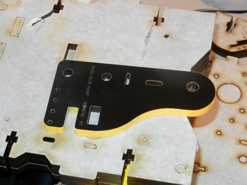

I did a quick test painting of one of the idler mounts to see how it was going to go. It looks good, but sadly my plan to airbrush them didn't work out. The paints are just too thin and the wood seems to just absorb them. The yellow would not cover at all, and even priming with white was very spotty. I ended up priming with white with the airbrush, which dries very fast, then using a rattle can for the final yellow. It looks much better but is taking a dog's age to dry. I'm actually thinking about acquiring a small toaster oven to speed drying of the smaller parts.
Anyway, here's the test piece. I like it, so this is how the rest of them will get done.
[img]http://i243.photobucket.com/albums/ff27 ... be5480.jpg[/img]

An option prior to paint is to seal the edges with a dewaxed shellac. It won't swell the MDF and helps keep the moisture out. The quick way to apply it is to immerse the whole part and quickly wipe it off the melamine. Old cotton rags work best. This completely saturates the edges quickly. Any remaining drips can be cleanup with denatured alcohol.
I did this on my build (in-progress) without any ill-effects.

When I did Blue Max, I primed the edges with an oil-based Killz primer. Works great.

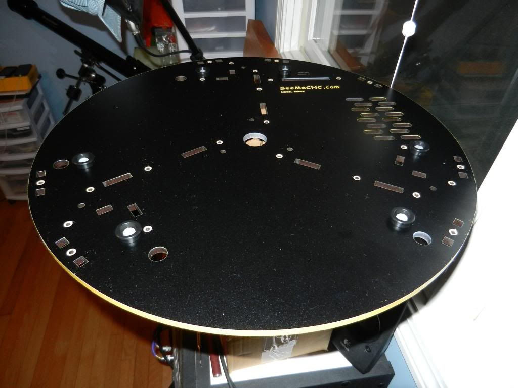

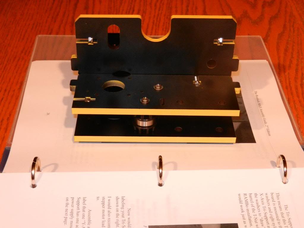

Got a little more done today. The paint around the edges and lettering is taking forever to dry. I did go buy a cheap toaster oven and baking the small parts at low temperature seems to be helping. The plates will just have to dry on their own time but I can at least work on them carefully. Got the countersink rings popped from the bottom plate and got the feet on.
[img]http://i243.photobucket.com/albums/ff27 ... a52304.jpg[/img]
I also started working on the first Tri-Support, deviating slightly from the manual by putting the idler bearings in first, as seen below, before attaching the stepper motor. I like this approach better as the Motor Support has no locating tabs and just rotates around its attachment screw. Installing the bearings first squares up that assembly and holds it in place.
[img]http://i243.photobucket.com/albums/ff27 ... a21c86.jpg[/img]

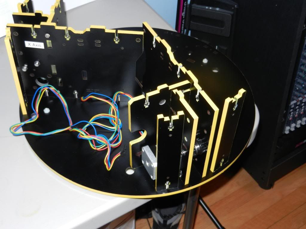

Busy day today! Got two of the Tri-Supports finished and the last one is baking in the oven. I should have them all mounted and the base plate on by tomorrow night. Here's what she looks like at the moment:
[img]http://i243.photobucket.com/albums/ff27 ... 7bf55d.jpg[/img]
Had a brief moment of anxiety when I was looking at how the doors go on. I couldn't find a small hole for the door keeper. It finally hit me that the door just covers up the large hole on the side most of the way and the keeper slips in there. Clever!

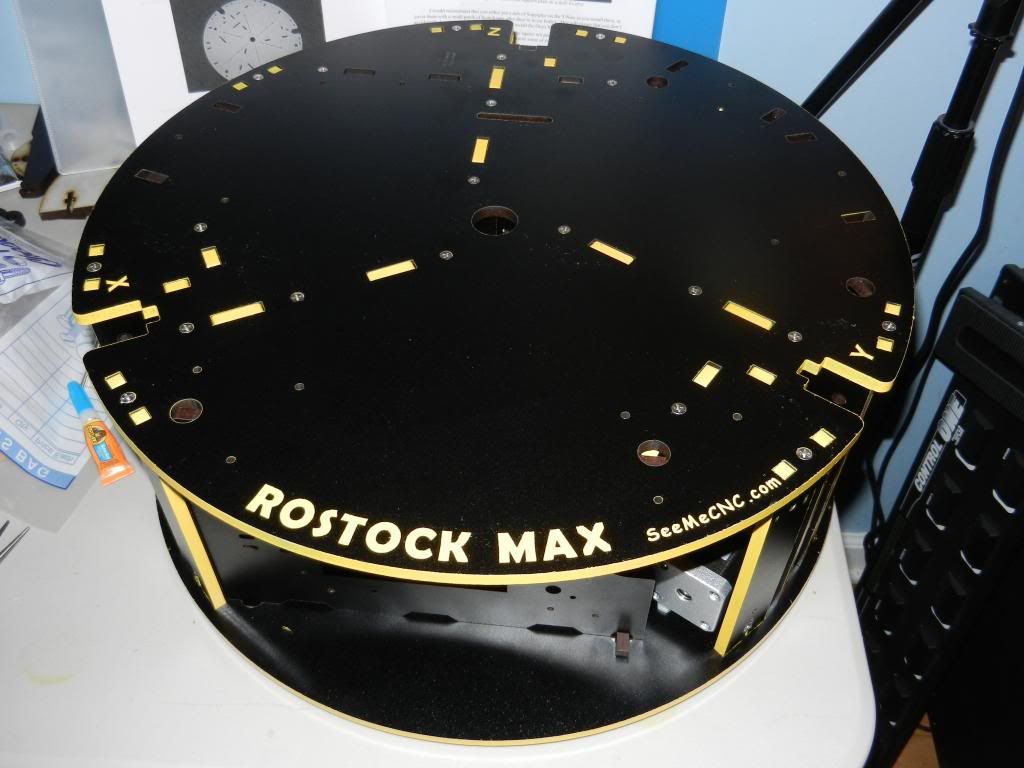

I was able to finish what I had hoped to finish today, and it's still early! I might get even more done. Here's the completed base unit. The lettering looks white from the flash, but it's bright yellow like the rest of the paintwork.
[img]http://i243.photobucket.com/albums/ff27 ... 530538.jpg[/img]
Hopefully the rest of my supplies come in tomorrow. I need the lacing cord, in particular. Oh well, back to more painting :roll:

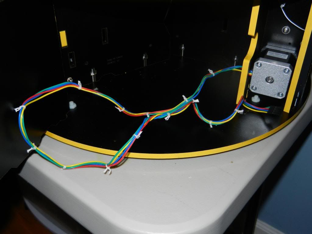

While waiting for some in-transit stuff to arrive, I've been working on tidying up wiring. Gene's suggestion of the waxed lacing cord is an excellent one. I knew about this stuff from my time in the service, but had forgotten about it. Much nicer than those plastic ties with the snagging heads. What a difference after tying up the stepper leads - from rat's nest to neat, easily routable bundle. Tomorrow I'll go get some adhesive wire mount plates and route everything neatly into the Rambo bay. Here's an example of what a nice job that cord makes of wire management.
[img]http://i243.photobucket.com/albums/ff27 ... 654dd6.jpg[/img]
I've also gotten some other small tasks done, like getting all the bearing covers installed, prepping the end-stop switches, etc. This weekend I'm planning to work on the Cheapskates and maybe get the power supply prepped and installed in its bay.
