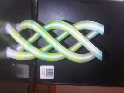

Re: November Print Challenge
Posted: Wed Nov 20, 2013 4:19 pm
by wildideas1
ok here goes 4th print at 1:45min till finished Puppy ran into computer and buffer wigged out no recovery possible.
5th print this morning and we Have a WINNER
Head 211 degrees
heated Bed 100, Glass plate Auquanet hairspray ( weird issue ran perfect till 45min left then dropped to 93 no reason but thank the 3d gremlins didn't attack)
Clear ABS ( colored Sharpies at irregular spacing to give effects seen)
No Fan
Dead on 150mm winner
LIFETWISTSYOUUP_LOWRES kiss clr grid.gcode
g-code
(6.74 MiB) Downloaded 584 times
have mini video of it finishing last 3min but dont know how to upload that??
