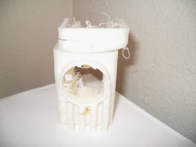

At 255C on the extruder, you're going to be replacing the hot end soon. MAXIMUM temperature for the stock hot end is 240C. The PEEK section of the hot end will fail at higher temperatures.
ABS can be a royal pain in the ass to print with due to shrinkage. What happens is that the part shrinks asymetrically(sp) and causes curling - some times so extreme that the part pops free of the bed during the print.
Have you tried adding a brim to the part you're printing? That would give additional surface area for the part to grip the bed and may help curling. Also, keep the machine out of any drafts - that will cause all kinds of problems with ABS prints.

Extruder temp is the default that the orion quick start guide detailed (thx geneb), so I think like anywhere from 210-220 for the ABS, depending on layer. I actually printed up someparts last night, went to bed when they were 30% complete, lookin decent, wake up and it all went to hell. A mass of spaghetti on end of the bed plate and an offset part on the other, no idea how this even happened but here is a pic of the offset part:
also I had to use supports, no idea on what settings to input so I just guessed, perhaps that has something to do with it? Furthermore even with the heated glass bed AND the super hold aqua net my parts started to curl, I'm going to close the vent in my office tonight and see what that leads to. Also, because I did not want to give up on the prints that I had wanted for so long, once they started curling at the edge I furiously applied superglue gel to them, this held until the spaghetti plastic and offset parts started printing, at which point i shut it down. All help is appreciated as usual....

If you are printing ABS, I would not even try a part without a brim, a raft or "mickey mouse ears". Especially if said part is a lot of mass. My rule of thumb is to add one of the afore mentioned in at least the same area as the bottom of the part. I've also lately been running a small ceramic heater blowing at the level of the Onyx. It doesn't create a lot of draft and keeps the print area hot. My temps seem to stay more constant now. 230C and 80C respectively. I have a max, but I think it all applies.
