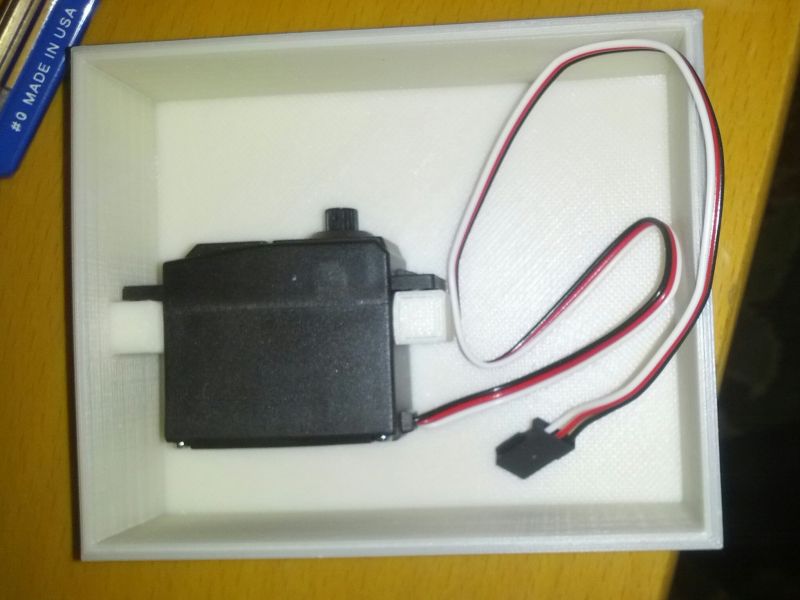

I've printed a nice box (solid infill) like so:

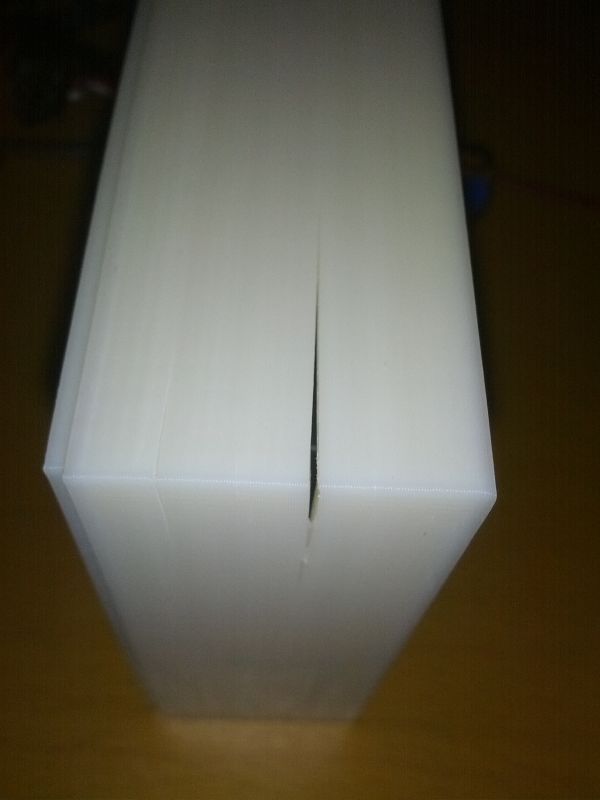

Unfortunately, this one, and others like it I've printed before started to crack soon after cooldown:
Any idea why this is?
Is this edge curling?
Something else?
(ABS; 220C extr.; 100C bed; no fan)
Edge curling?
Re: Edge curling?
It's very common with ABS, as it cools, it shrinks, pulling up the lower layers.
Printing hotter will often reduce the effect, you can go as hot as 240 with the stock Hotend, I'd try 230 then go up in 5 degree increments. The extra temperature results in a stronger bond between layers.
The other solution is less infill, less plastic means less warping force.
