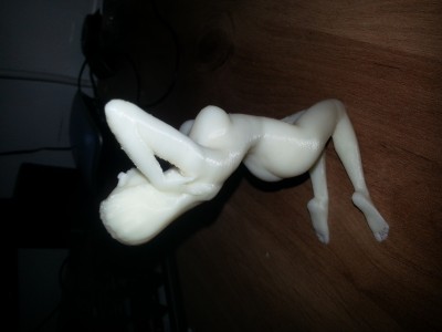

New ABS filament printing
ok. So I insert new white ABS and it's print so well that now it looks like my brown ABS isn't printing well...

Posted: Wed Jan 01, 2014 4:45 pm
by Orenfor
Sure I will. I just need to get home for that...
It's 11 cm tall... And the print went well. Just put the fan on( to cool the surface - not the hot end) ...
But that my best print till now...
Looking good?

Did you use Slic3r to slice it and I assume you had support turned on.

well yes, i did use slic3r, and you assume wrong, no support needed.
