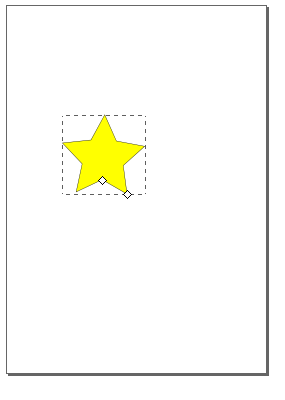

Does anyone have an easy route for taking a .svg and extruding it into a part?

I actually went ahead and installed this and it worked.
From there it can be exported and printed, or exported to the file formats in Openscad. Very useful for users who want simpler 2d designs :D
Here's the Thingaverse link: http://www.thingiverse.com/thing:25036

You might need these links too:
http://inkscape.org/en/
and
http://libregraphicsworld.org/blog/entr ... -converter
The "libre graphics world" is a "how to" article.

looks like blender can also open these .svg and convert them to .stl

I have done some converting of scroll saw patterns to stl. Most of what I did was scan, open in inkspace, "fill" the pattern, export the svg, import into blender and extrude. The tricky thing was I needed precise dimensions and it took awhile to figure out the size conversions from one software to another. And then blender changed things...
