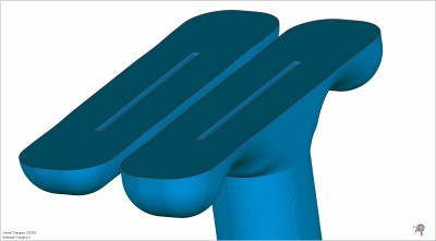

I have a somewhat complex structure I need to make a few times. For those interested, it's a bracket that combines bucket support and foot brace for an APD Inspiration rebreather in a custom stainless/aluminium case (affectionately known as the Silver Box of Death) I've been working on.
Here's a pic of the model:
[img]http://www.simonlockwood.net/linky/3dp/ ... racket.jpg[/img]
Orientation is it's laying on it's back with the top and front closest to us. The wide piece at the bottom is 150mm long by 20mm high/deep for a sense of scale.
Now I COULD just ram it through Slic3r and print it with about a million hours worth of support, but I'd rather not. Additionally, there's a good chance I'll be making a silicone mould off the part so production becomes a matter of stuffing mould with glass fibre and filling with epoxy. I vastly prefer open top moulds to closed, complex ones because it makes pulling the parts easier and avoids any hassles of distortion and unseen bubbles etc.
So, rather than attempt it as one piece I'm thinking of slicing it up into chunks which will print and pour without overhangs.
Anyone else adopt this method? If so, what are you doing to join the bits? Building plug/holes in? Holes with countersinks for screws? Just gluing them together? Dovetails?
Exciting times, interested to see what the "norm" is in these circumstances.

same boat as you. many of my models will need to be cut. i am trying tonight an option to add a 1.85mm cylinder lined up with my section cut. this will leave half on each side and am hoping to just put a piece of 1.75 mm filament in the slot and make the gluing easier. this one I ran horizontal to the split, might try adding 1 vertical as well, will see how this goes.

I printed a horse from Thingiverse that wasn't split. Basically, I just rotated it and sunk it down into the print-bed in RH and slicer sliced it just fine (the negative Z stuff didn't show up in the G-code). Then I just lined it up by eye and glued it together. Obviously, it wasn't as critical as the piece you're building :-)
For your part, I'd rotate it 90 degrees (around the long axis) and just print the two pieces (they look like they'd actually just be mirrored images). Putting two through holes the size of a small screw (e.g. M3) might be a nice idea to guarantee it lines up when you're gluing it and/or to hold it together at the end.

For this part I ended up splitting it into three parts, adding locating blocks and screw holes. Tried an offset step and a flat face but neither really held it in position with any confidence, this seems to work ok. A bit more mucking around but I don't really trust glue in an application that needs a bit of muscle.
[img]http://www.simonlockwood.net/linky/3dp/sbodsplit.jpg[/img]
Posts: 5359
Re: Splitting parts to avoid support
If you've got the room, you might want to try using heat-set threaded inserts.

lasermike wrote:same boat as you. many of my models will need to be cut. i am trying tonight an option to add a 1.85mm cylinder lined up with my section cut. this will leave half on each side and am hoping to just put a piece of 1.75 mm filament in the slot and make the gluing easier. this one I ran horizontal to the split, might try adding 1 vertical as well, will see how this goes.
Nice approach!
Try moving the up-side top-wise :)
I'm not sure how to lay this out without just needing to print a support structure... I like the multiple pieces idea, but it depends how strong you need the part to be.
