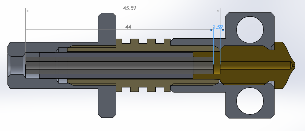

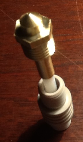

I was having some trouble printing PLA and put it over here http://forum.seemecnc.com/viewtopic.php?f=54&t=4312 because I thought some of the picture may be helpful to others. Anyway...I ordered a new PEEK from SeeMeCNC. I thought I should have one since I print close to 230 a lot. But my new peek is different from my old PEEK. It appears to be only big enough for a 4mm tube at the top of it and there seems to be some room for a 5-6mm tube around it at what I think is the bottom connection. Not sure of the set up for this. But perhaps this will fix my PLA woes from above other post.
I assume the first picture will connect to top of hot end (Bowden side) and next pic will connect to lower end (Nozzle Side). Does anyone have experience with this PEEK. I didn't see anything in the forums per say. Thank you.
Top view assumed
Top of PEEK assumed
Top of PEEK assumed
Bottom View assumed
Bottom of PEEK - assumed

My Rostock was delivered in oct 2013, and my Peek was alike your "new" Peek. It was fitted with 2 PTFE tubes, a short 6mm cut opened, and a longer 4mm in which the filament ran through.
After I melt it, I received in december 2013 2 Peeks that look alike your "old" peek design, needing only one PTFE tubbing.
There are obviously 2 differetn designs for PEEKS, but what I believe is the old one is the one you just received.

The "old" PEEK section is designed to use two PTFE liners - a small inner and a split, larger outer.
The "new" PEEK section is designed to use a single PTFE liner and is more aggressively bored to give an air gap around the top end of the nozzle to help reduce jamming issues.

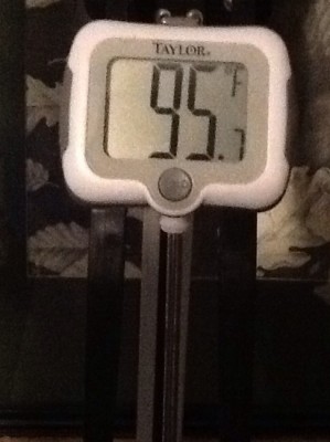

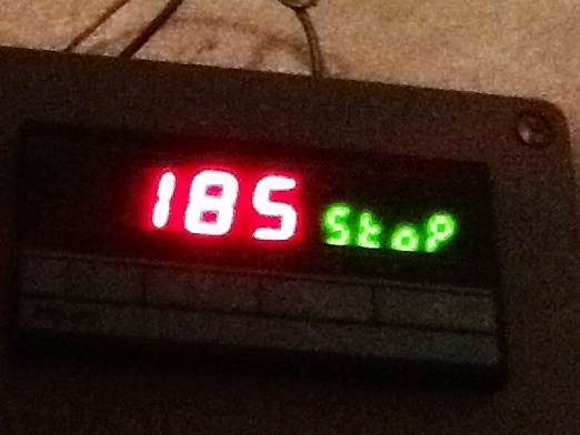

Thermocouple reading when hot end set at 230

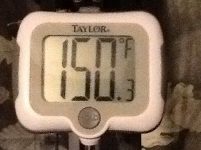

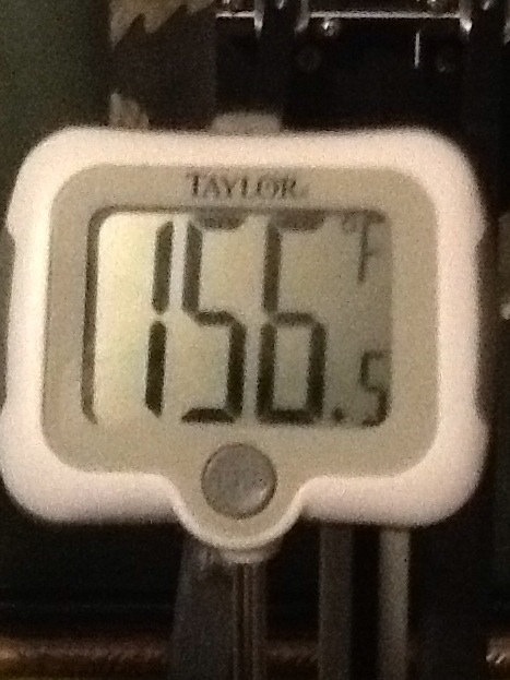

But your comment brought me to thinking about measuring the temp at the area of issue. These measurements are in F and not C.
F Temp at PTC connection with old PEEK at 230C no fan
F Temp at PTC connection with new PEEK at 230C no fan
F Temp at PTC connection with new PEEK at 230C with fan running high
PLA softens around 138 Fahrenheit
The top two are expected without the fan running. The last really surprised me showing how much the temp is reduced running the stock fan with the repable fan shroud. It was these pictures that had me thinking about my fan setup. I believe the instructions and this site have a lot of information about fans which I read but temp differences didn't really hit home till I saw above. I had it set to turn on and off with the start of a job in slicer. I changed it to the heat1 spot on the board to take advantage of the Eeprom settings controlling it with the hot end as being on or off. I made the wrong choice in setting this up and didn't fully understand the highlighted section in the manual in regards to the choice I made. Now that I set it this way I have not had any rotational jamming due to temp creep and I don't expect any in the future. thank you. And thanks Gene for continuing to answer the "usual questions"
