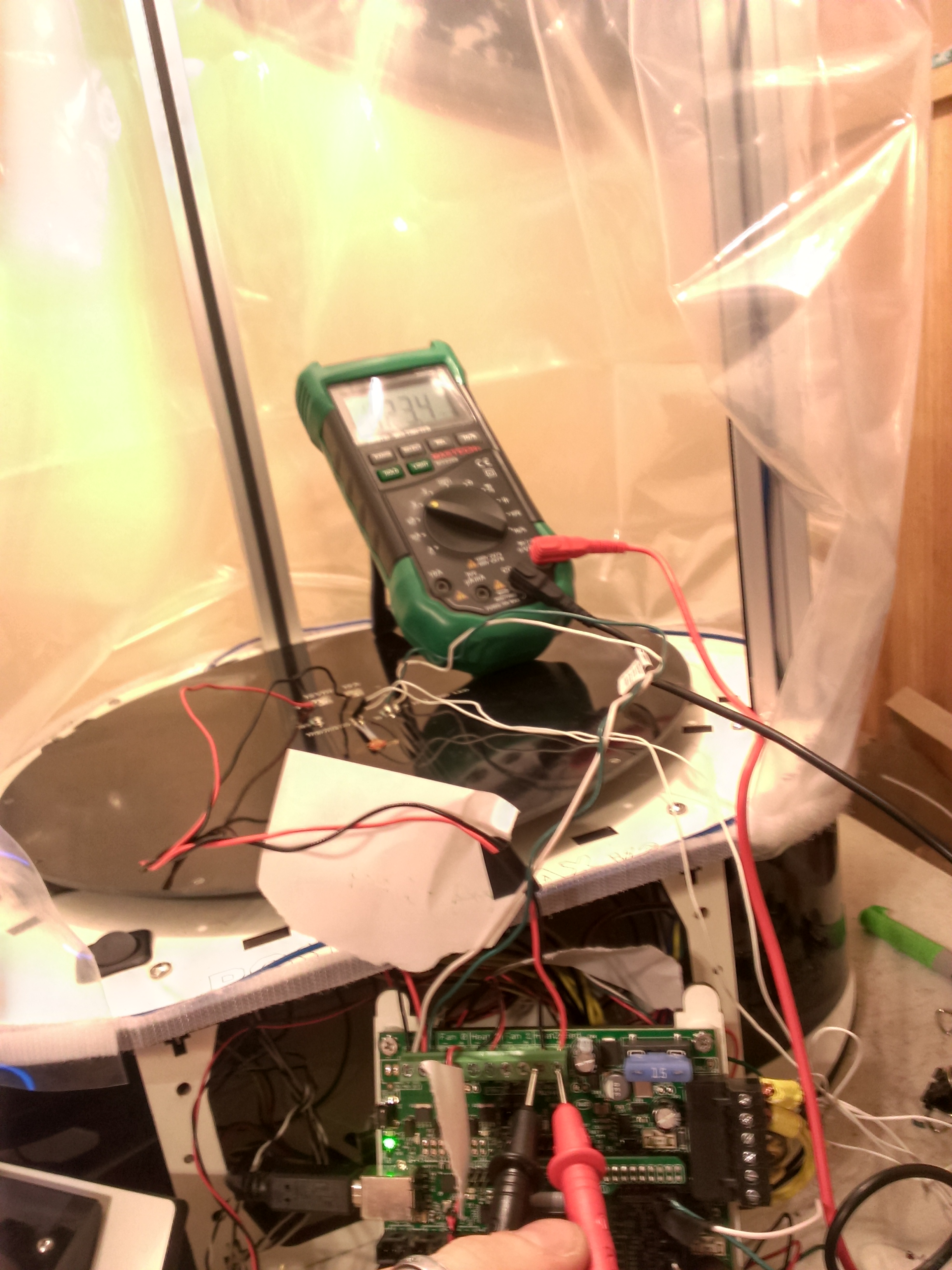

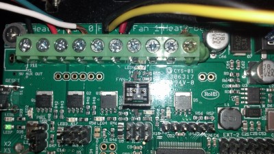

So get this Eagle, the RAMBo lights up the Heat2-Bed led, and provides 11.5v current to the output of "Heat2-Bed" on the RAMBo. The moment I secure the 12v wires that go to the large solder pads for the heating element to the Heat2-Bed inputs, the LED won't turn on. It is noticeable however, that when the heated bed is triggered within Repetier-Host to be turned on, the RAMBo does flash the LED to Heat2-Bed very quickly before turning off again.
Would this then indicate a fault somewhere in my heated bed?
The thing is, my printer has been running fine. It was warming up for a print, then all of a sudden, the heated bed LED turned off, and the temperature for the bed on the LCD started to coast downward.

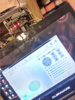

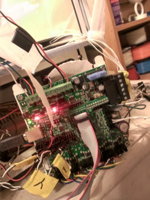

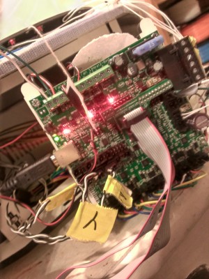

Attached are photos of my board powered up with LED's on when there is no connection to the heated bed, and off when there is connection.
EDIT: I also just tested the voltage on the RAMBo, both connected and unconnected. Unconnected, the Heat2-Bed connector puts out 11.5v. With the heated bed screwed in and power supplied, it shows 30v?! What is going on here?
Both hotend and bed turned on yields all the lights, when the bed isn't plugged into the board.
Closeup to show that "Heat2-Bed" has nothing connected.
This is when the bed is connected, and Repetier has signaled the bed to turn on.  No light :(

We must stop for a moment and diagnose how the heated bed output can go to 30V.
Do you have any other power supplies attached to the Rambo? What voltage to you have connected to the Heat Bed Input on the Rambo?
When you are measuring the voltage outputs and received the 30VDC measurement are you sure that your meter is set to measure Voltage DC and not Voltage AC?
Just trying to be thorough because what you have observed is is not logical in a 12VDC only environment. Please get back to me.

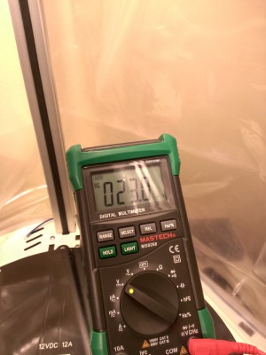

Hey Eagle, further testing proves even further inconclusive results. I'm certain I'm using the meter properly, but now I've gotten a different set of measurements than before!
Unstressed, or without the hotbed plugged in, the outputs are reading 9.5V. However, with the bed plugged in and on, it pulls 24V!
EDIT: I'll try to take photos, as I sound like a loon explaining it this way.
I have the Viotek supply shipped from SeeMeCNC and no extra supplies added. I suppose it could be drawing extra voltage from my laptop through USB, but that's somewhat unlikely I would think.
I used GeneB's instructions as per the manual and combined a few of the 12v rail wires in a bundle for the heat bed input, and duct taped them right at their neck to keep them tidy, you can sorta see this in the right-hand side of the very last photo I posted.

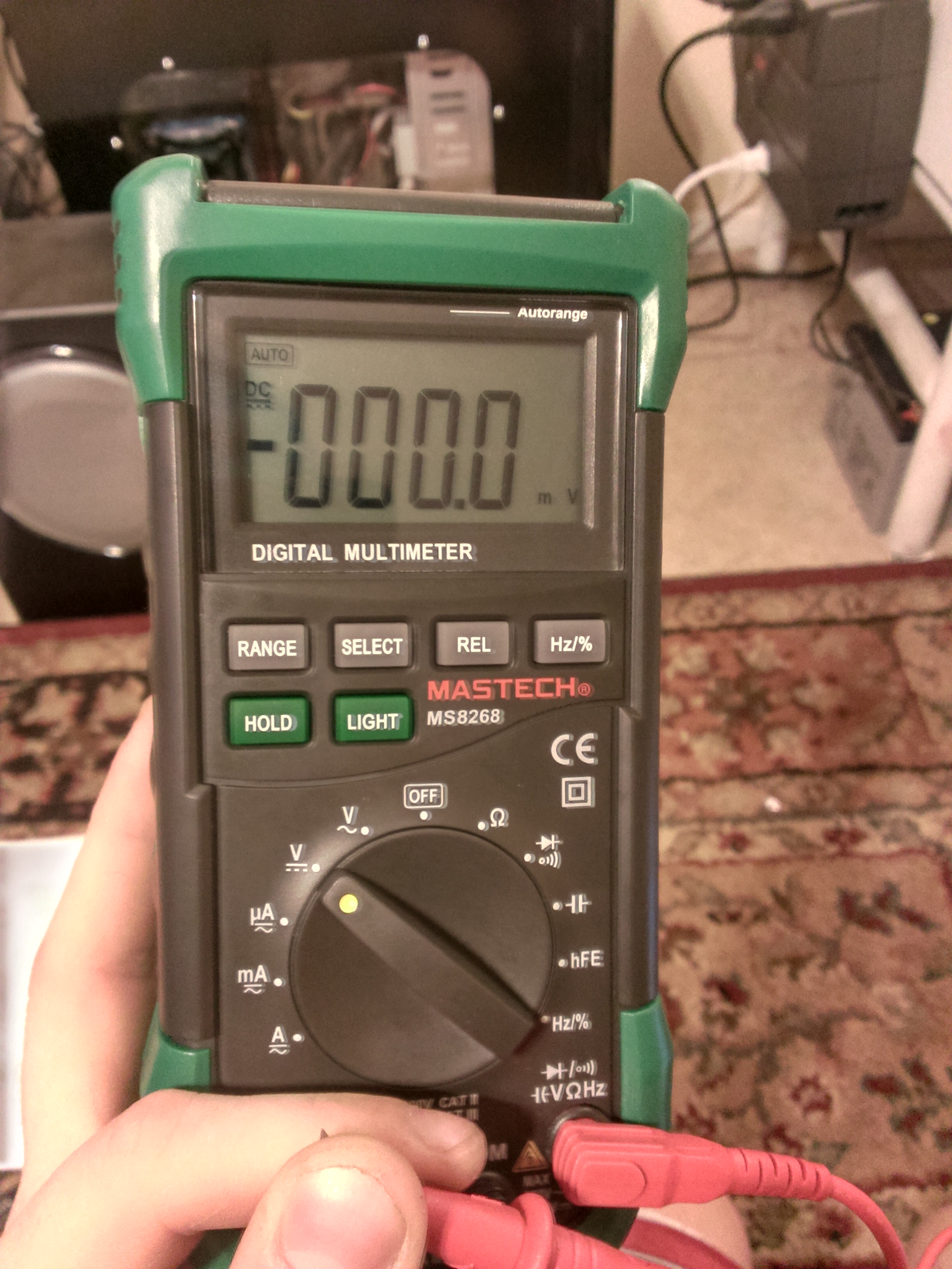

EDIT: Here are some photos to illustrate my methods. It seems like the voltage is slowly coming down. Could this be my RAMBo slowly suffering a cataclysmic failure on the Heat2-Bed output circuit? Everything else on the RAMBo seems to function perfectly except this single circuit. I've been eyeballing the RAMBo 1.3L schematics for the past hour seeing if I can pick out something that would do this.
Measuring VDC
Measuring VDC
24.3V
24.3V
Slowly going down.
Slowly going down.

Read the voltage input at the Rambo's heating bed input, directly from the power supply once with the heating bed off and once with it on.
Read the voltage output at the Rambo's heating bed output directly at output screws once with the heating bed off and once with it on.
Also, in the last photo it seems to look like the mv is indicated, is that correct?

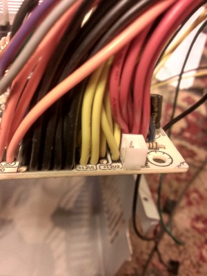

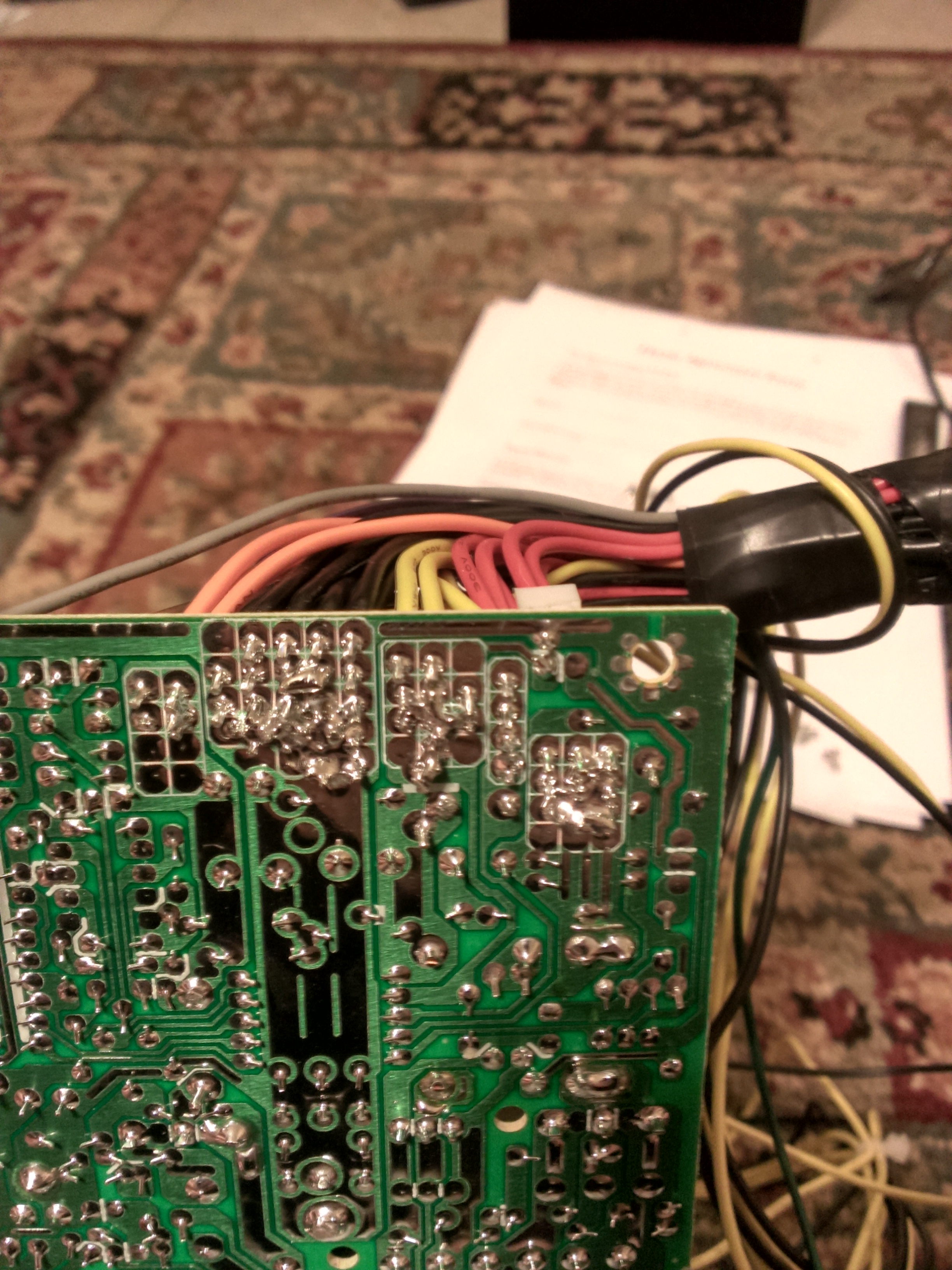

So Carl, you probably won't believe this, but by sheer chance, of all the yellow 12v wires I could've picked to wind together, I picked 4 that were all on the same rail. Yes, apparently this power supply (Viotek 550w) has two separate 12v rails, even though it is only advertised as one single rail. Attaching photos below.
As you can see, there are two areas, labeled +12v1 and +12v2.
On the back, there are even two separate trace pads for different clusters of the 12v rails.
In my wanting to keep things clean, most of the other yellow 12v wires were cut, so I suppose the one rail trying to drive the heated bed was just too much for the poor thing.
I scooted up to Best Buy before they closed and bought a Corsair CX750M (750 watt supply if you couldn't tell from the fancy name)
Right now I'm debating on making a conversion cable for the 12v rail so I can easily plug it into my printer and not void the supply's warranty :)
