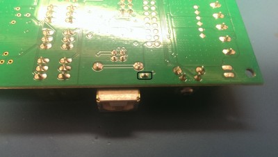

For those of you who are wondering if your board is patched and you do not see the jumper on the top of your board, there is also an SMT patch that can be done. If your board is
patched it will look like the following image. The component they used to patch your board is within the black circle.

dtgriscom is trying to get the revision information that need the patch. I posted the image where it shows where the board would be patched but if you can't get to the back of your board it would be difficult to see if it is patched. If you can get to the back of your board look to see if you have that small part soldered in by the USB connector as shown in thedinspiration wrote:Hello,
The board inside my Orion is a version 1.2e -- Does it require the jumper mod or not?
image I posted. If your board does not have the jumper or the SMD component on the back, then it probably needs patched.

Just to be clear, this is a board which, when first manufactured, did NOT have the static fix. But, as a last step, a component was hand-added to the board to implement this fix. (Right?)Eaglezsoar wrote:For those of you who are wondering if your board is patched and you do not see the jumper on the top of your board, there is also an SMT patch that can be done. If your board is
I'm guessing the board you show is earlier than version 1.2fp; what version is it?
Re: Does anybody got the static jumper mod?
I received the image of the board and the patch from Ultimachine but they did not identify the version number.dtgriscom wrote:Just to be clear, this is a board which, when first manufactured, did NOT have the static fix. But, as a last step, a component was hand-added to the board to implement this fix. (Right?)Eaglezsoar wrote:For those of you who are wondering if your board is patched and you do not see the jumper on the top of your board, there is also an SMT patch that can be done. If your board is
I am going to contact support at SeeMeCNC to get further information on version numbers effected and if the perform the SMD patch in house.
We will eventually get this figured out. Can you get to the back of your board to see if it has the SMD component installed?

Nope: my v1.2g board does NOT have a surface mount component at that location.dtgriscom wrote:Will check tonight.Eaglezsoar wrote:Can you get to the back of your board to see if it has the SMD component installed?
Haven't heard back from SeeMeCMC (either by approving my blog comment or by email), or from Ultimachine (contact form post)
My guess is that 1.2fp or 1.2g (or later) boards are OK; 1.2f (or earlier) that have the SMC mod installed on the bottom of the board are OK, and other boards (guess: those shipped before early last month) will need the external static jumper mod. But boy! would it nice to have confirmation.
