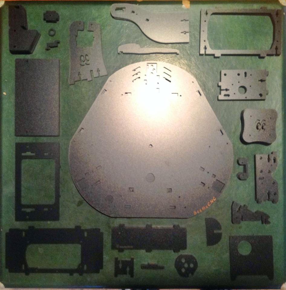

Got my box delivered today and have noted all parts, only 1 screw missing and can get it locally so not worth bothering with.
Just completed punching out and removing tape from all melamine pieces, noticed that the piece that goes under the Onyx is white whereas everything else on my kit is black... not sure if that was an oversight or if it will even be seen. All bags neatly packed and screws were in their own zip locks. Nice touch! I have used a black sharpie to mark every bag after cross checking them for easy identification during the build.
Very excited right now! Might even be up past my bedtime! :D
The black melamine punched out and tape removed... sorry the light sucks.

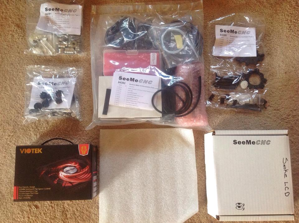

Unboxing the parts bags and preparing to check against packing list

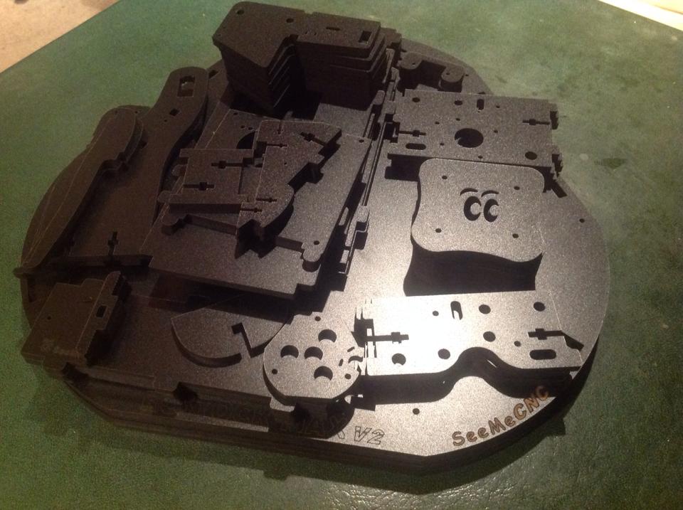

Just another shot of the stacked Black melamine parts

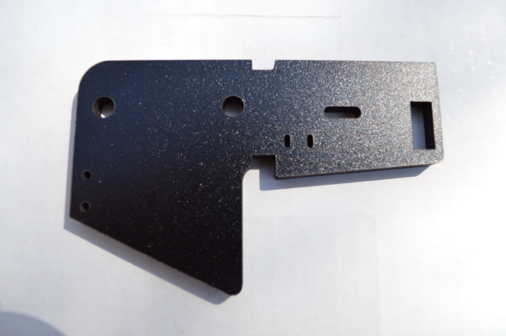

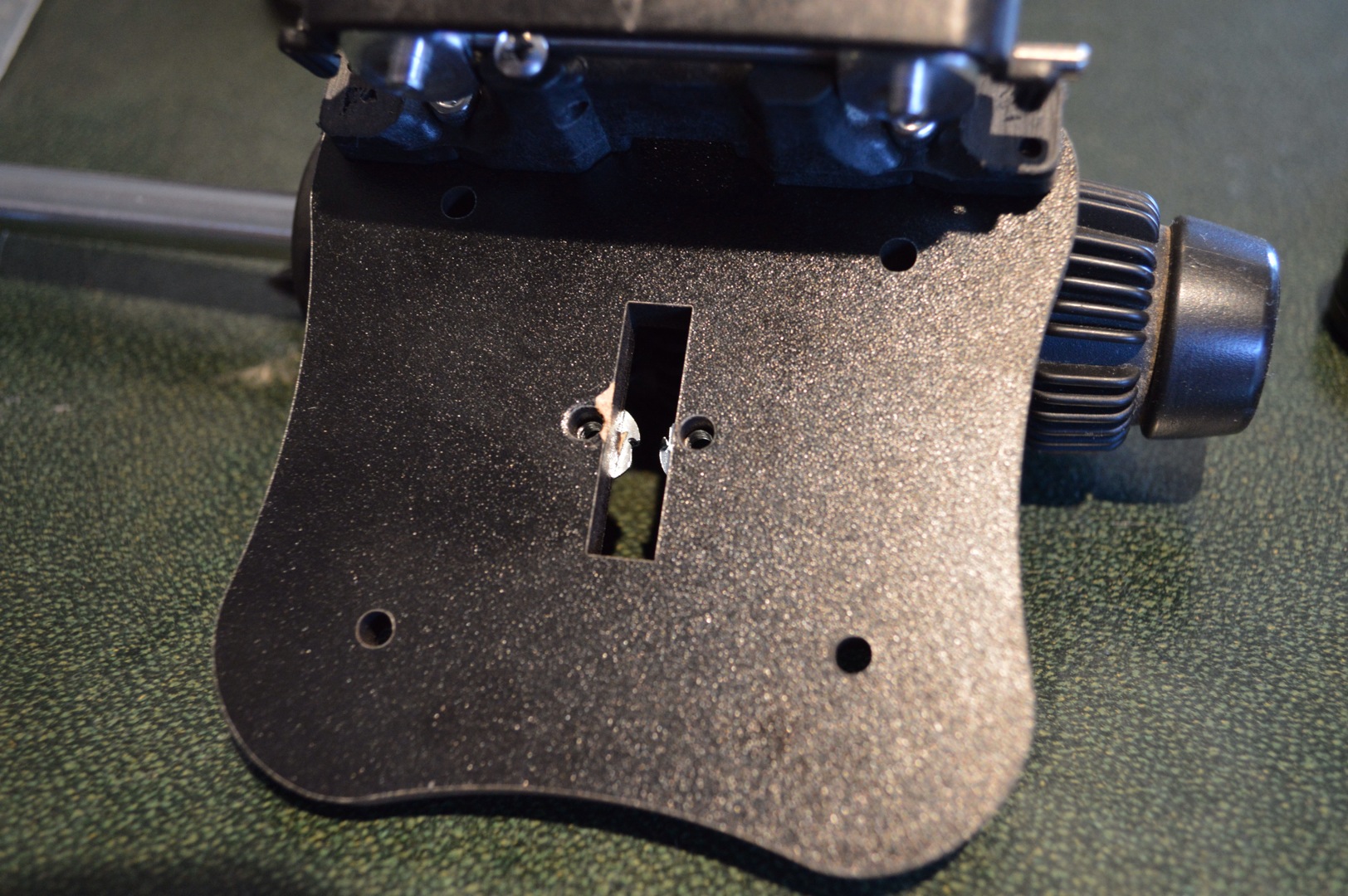

There was another user who got a V2 kit in black and he complained about the white part that goes under the Onyx and yes, it can be seen. You may want to put a couple of
coats of high temperature black paint on that part. The part is not made in black on any kit.
Re: CGBobio's V2 build
...or you can use a Sharpie on the tiny little white tips that stick out from under the Onyx. :D

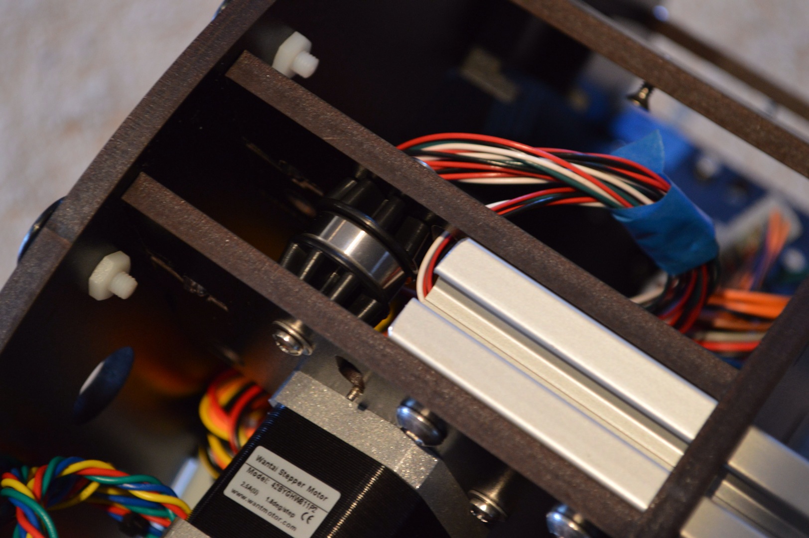

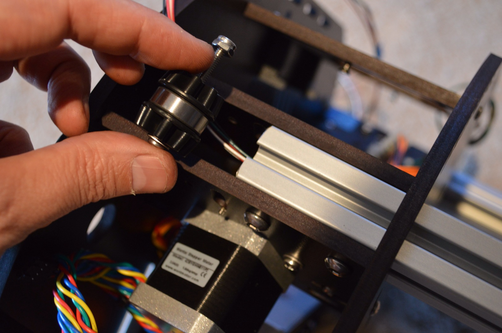

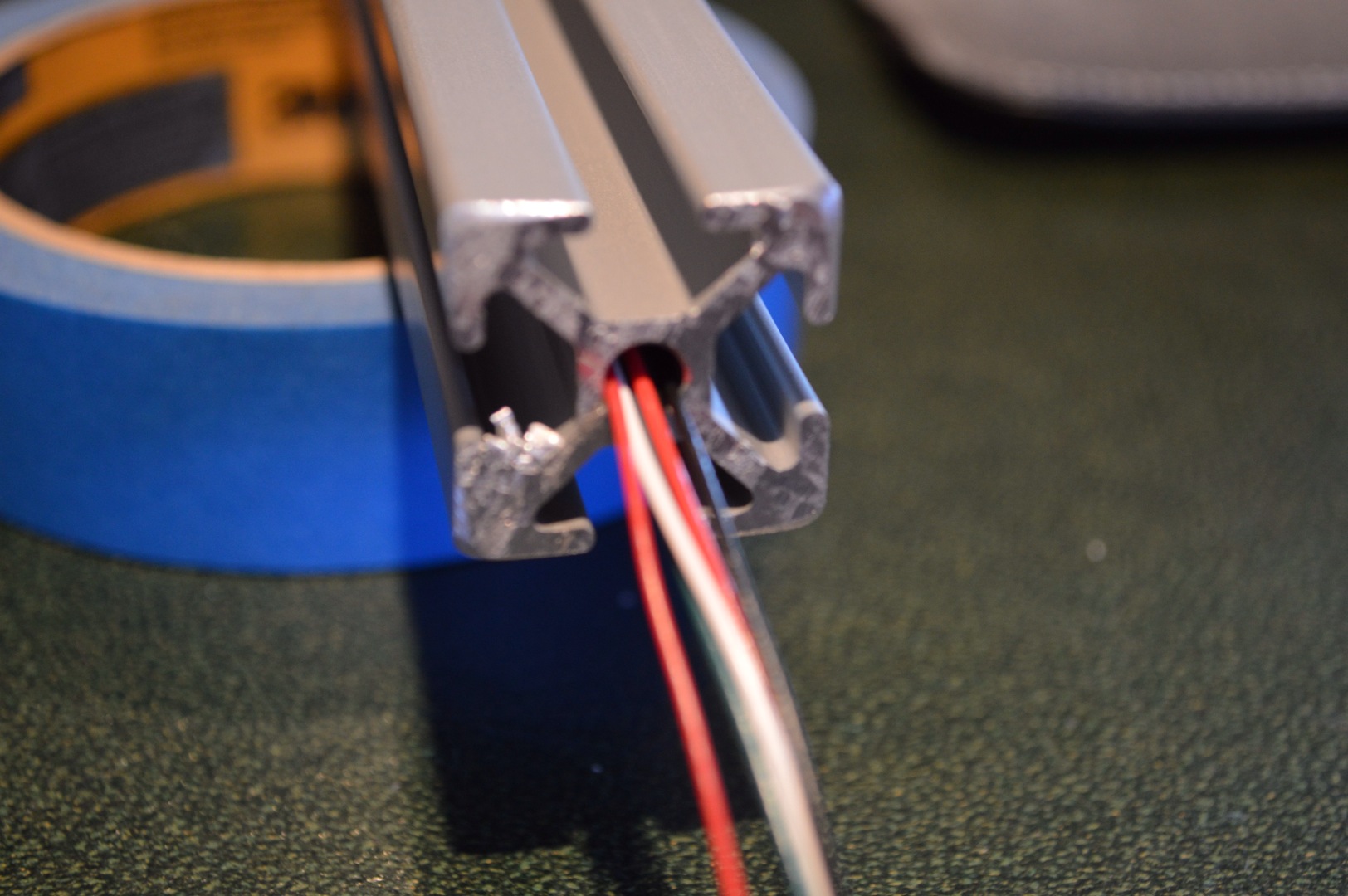

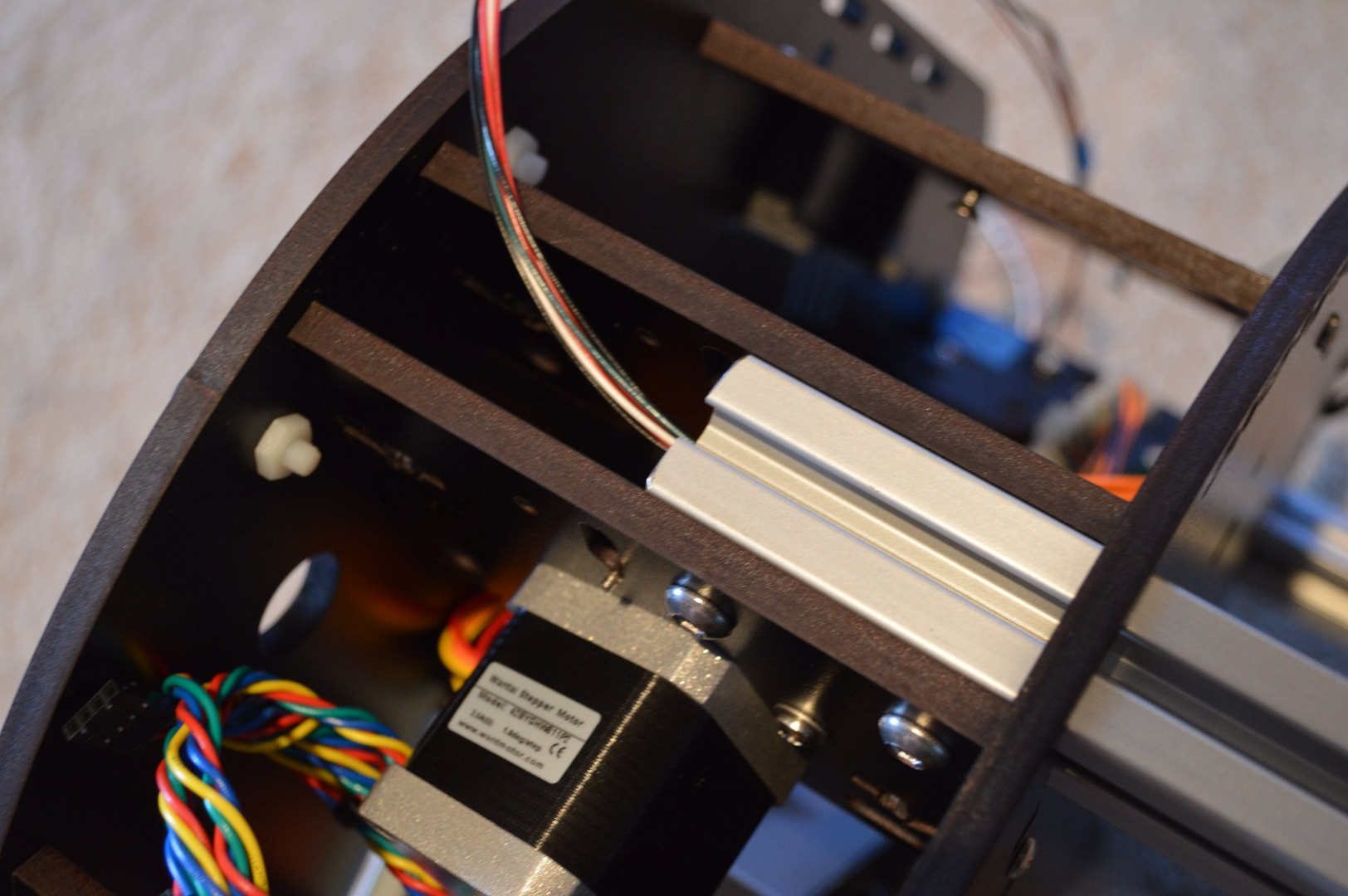

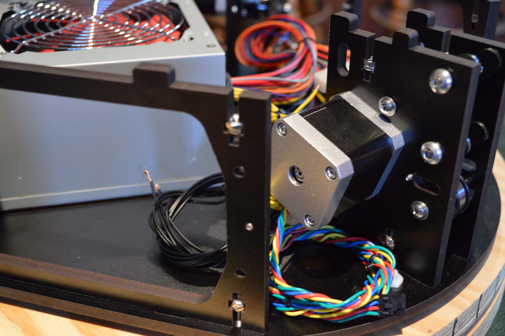

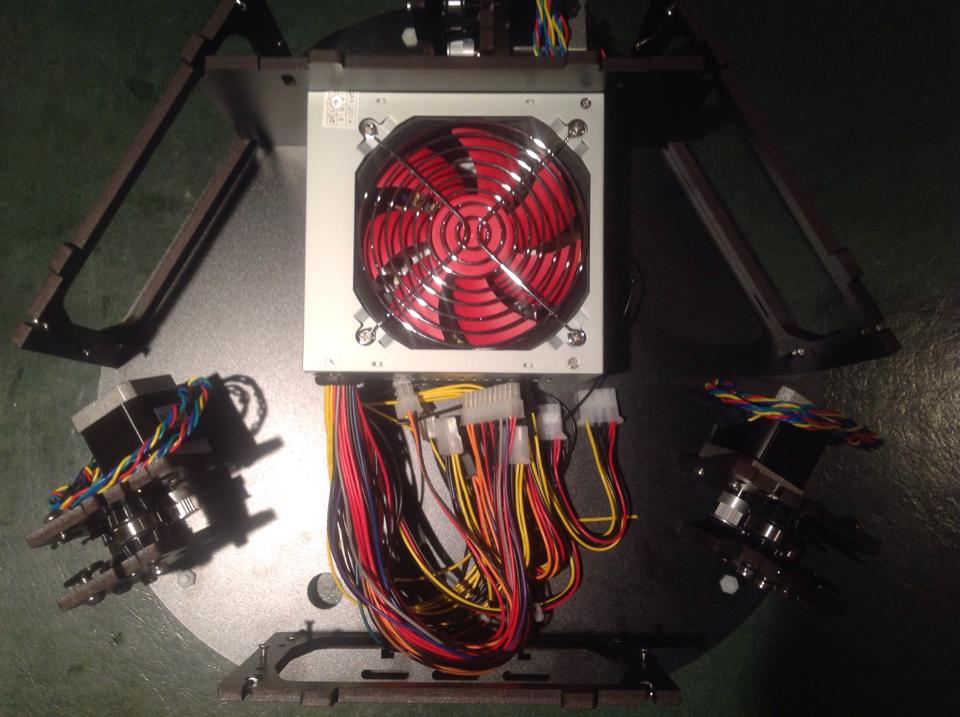

When threading the wires through the alluminum extrusions, I found it worked best to turn the alluminum in the opposite direction with one hand while feeding the wires with the other hand... this made the wires pull themselves through much easier.

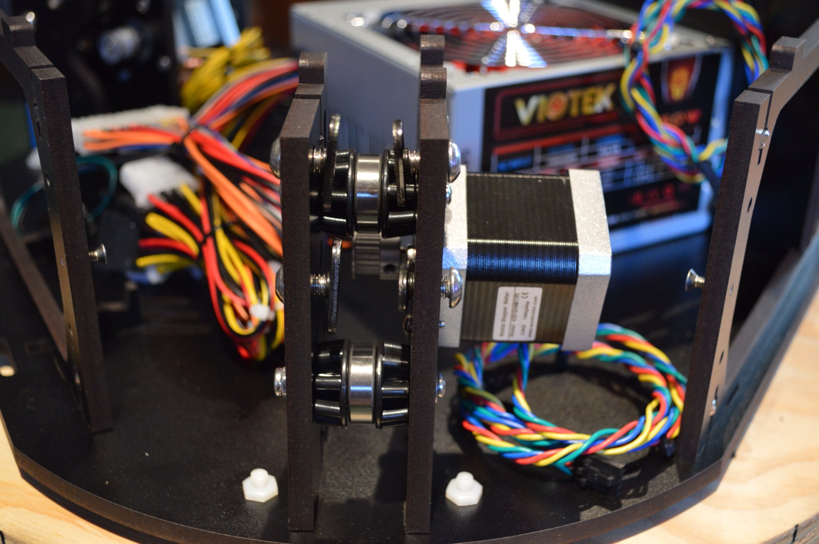

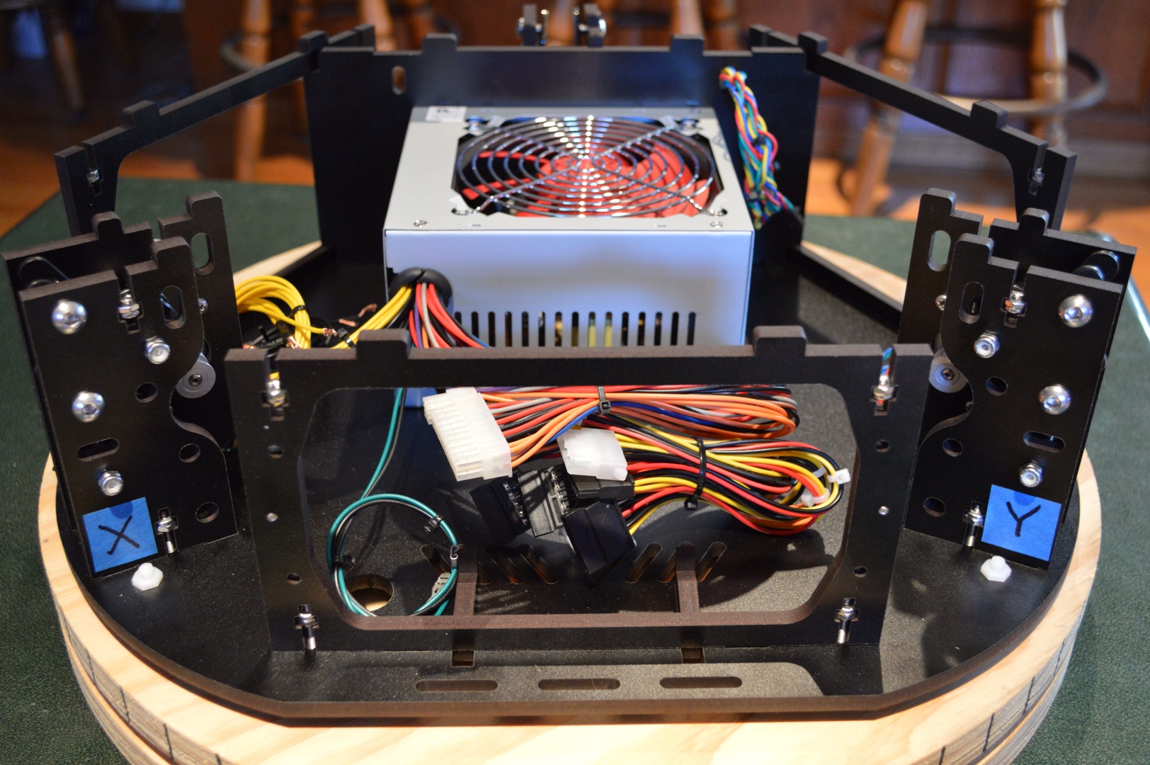

Front of the printer showing the X and Y motor positions
This is the "X" axis motor from the front left of the printer

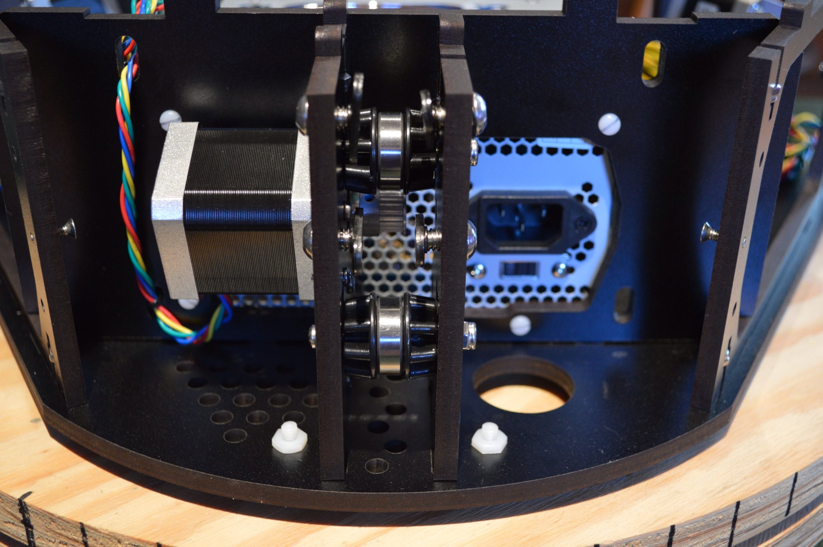

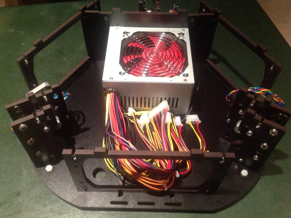

This is the "Z" axis motor and power supply from the back of the printer
This is the "Y" axis motor From the front right of the printer

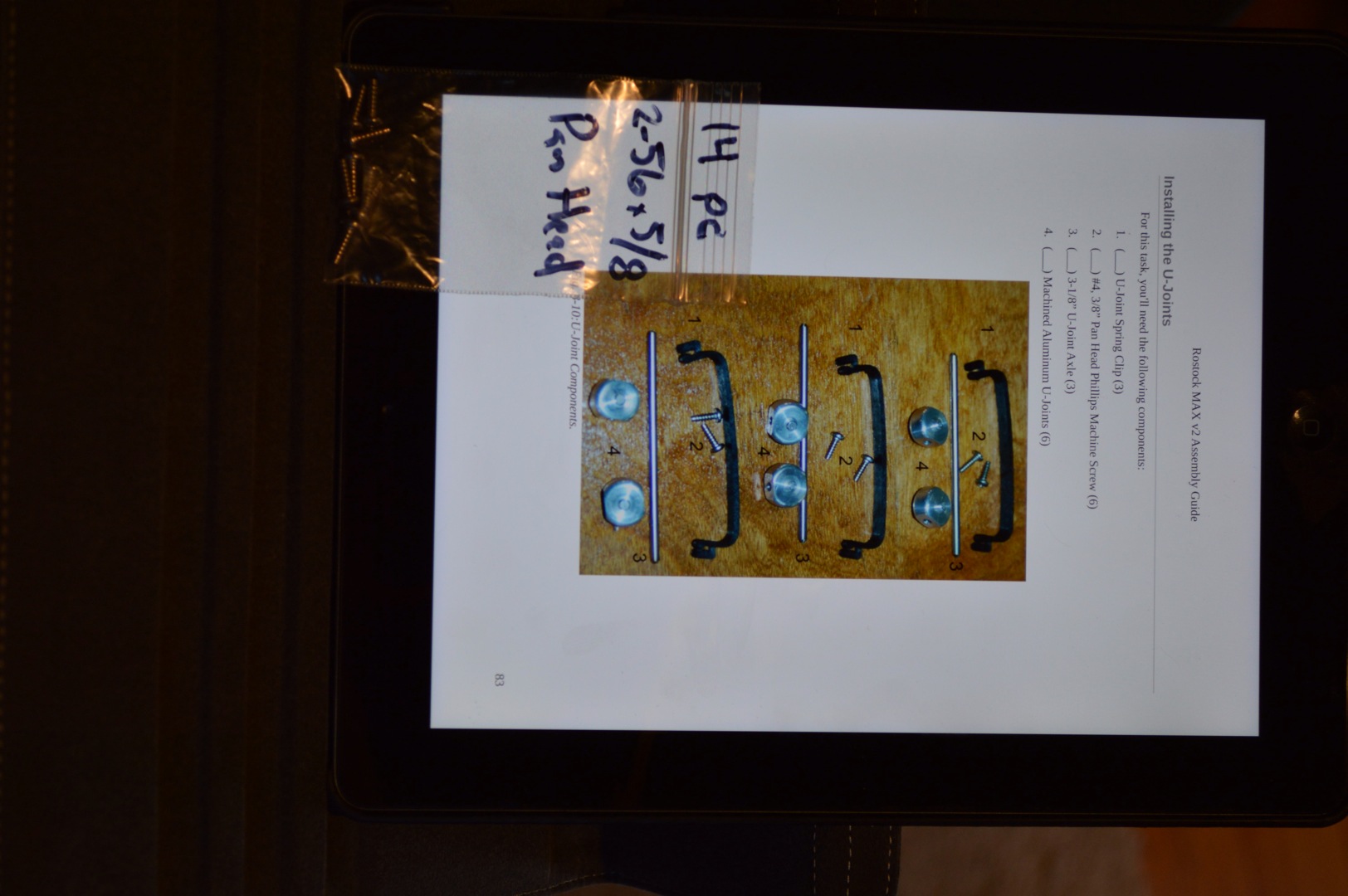

This step called for a #4 3/8" Pan Head Phillips Machine Screw. The baggie labeled here holds the screws I think were meant to be used... I labeled all the baggies when I first received the kit and never came across the size  mentioned in the documentation.

I found it much easier to route the wires (especially the 18 gauge) through the alluminum extensions by removing the idler bearing under the mount and then replacing it once the wires were through.
replacing the idler bearing once the wires were pulled through.
The wires successfully pulled through the alluminum and routed out the bottom of the mount.

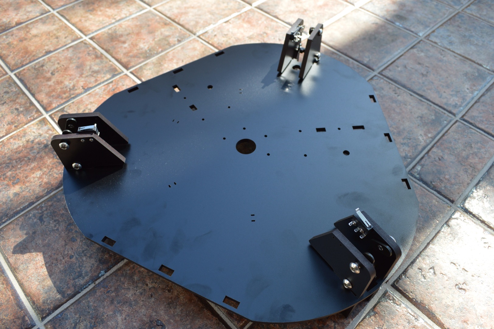

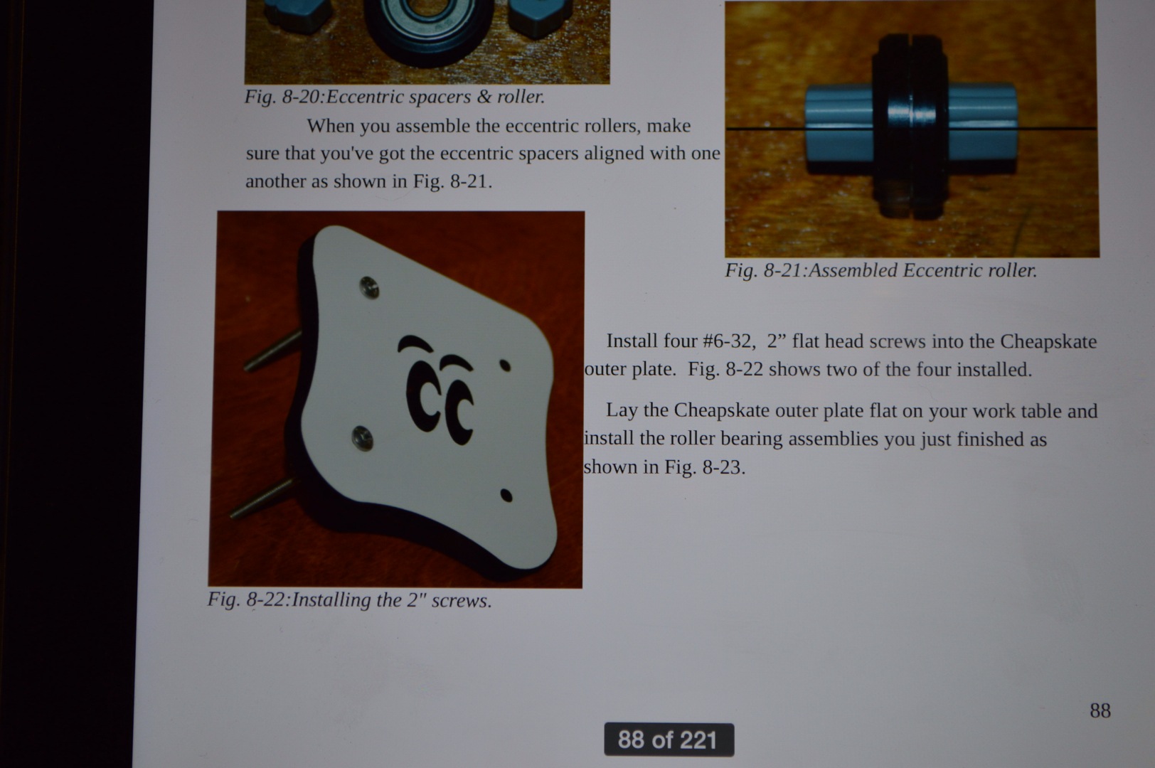

This is the "new" upper tower mount that was different than the image on page 71 of the documentation. Caused some concern at first, thought I had not been sent any of these until I matched up the remaining pieces I had with the hole patterns on the documentation image.

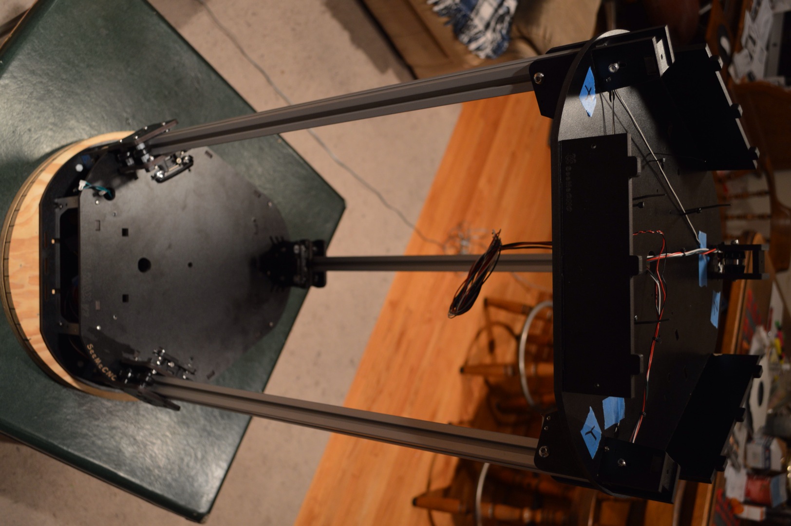

The assembled top section. I wound up reversing the large plate and had to invert all the upper tower mounts once I saw my mistake.

Not sure if this was taken care of in v2, but in V1, I think there is an issue with running the endstop wires down the same extrusion as the stepper motor wires. Not sure if this is what is done here... but might want to take heed.
the endstop wires will take interference from the stepper motors.
Though, this is recall.... anybody know If I am correct?
BTW, nice looking so far!

Thanks for the heads up! The wires in this build have all the end stops in the X axis, the 18 gauge (for stepper motors ?) is in the Z axis by itself and the 22 and 26 gauge wires (for the hot end) are in the Y axis extrusion. I'm hoping this solved the issues you are speaking of.

Yes that should take care of the issue, you dont want the end stop wires running with any other wires in such a confined space as it has a problem with picking up the noise from the other wires and you would never get your machine right.
If the end stops are all run by themselves down one extrusion you should be all set!

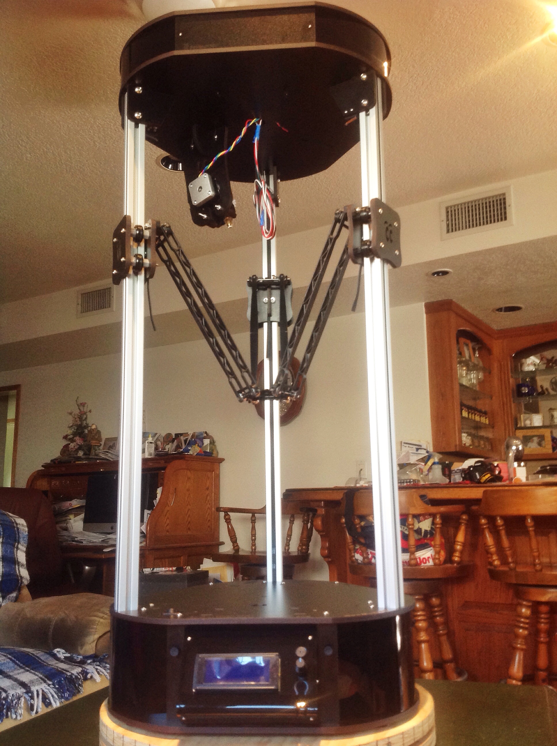

By no means the final build, I have a bunch of soldering, crimping and wire management to do today, but her is where I am at right now. Got the belts run as well, so just a few more items and. I will be uploading the firmware and starting the calibration soon.
Put the smoked plexi in, but still have to fi nish up wiring. I will post better images later tonight when I finish for the day.

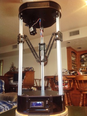

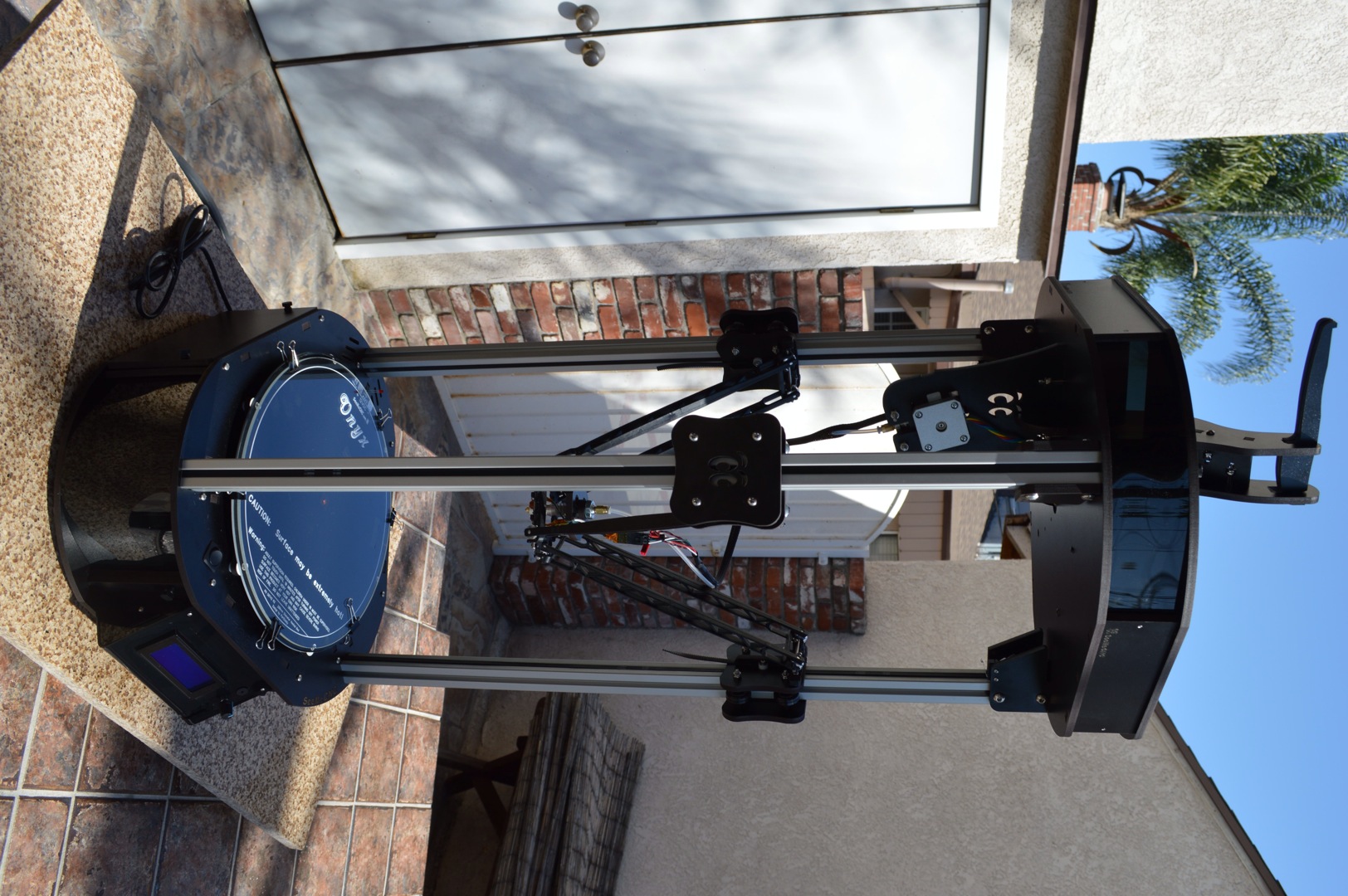

Out of box build complete! Now for the upgrades! :D
Here are some pictures of the Black V2 for all of you that wanted to see one built. The only thing I did different was add the disconnect on the hotend, everything else was stock according to the manual.

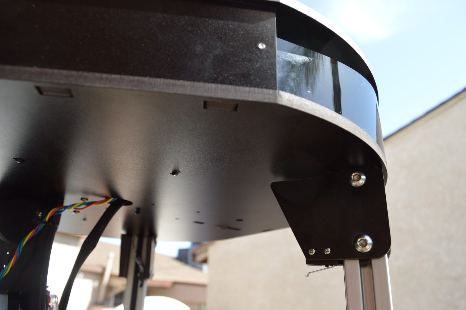

The upper part of the tower with black frosted lexan on the corners

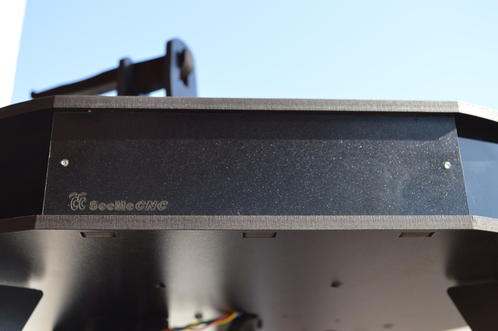

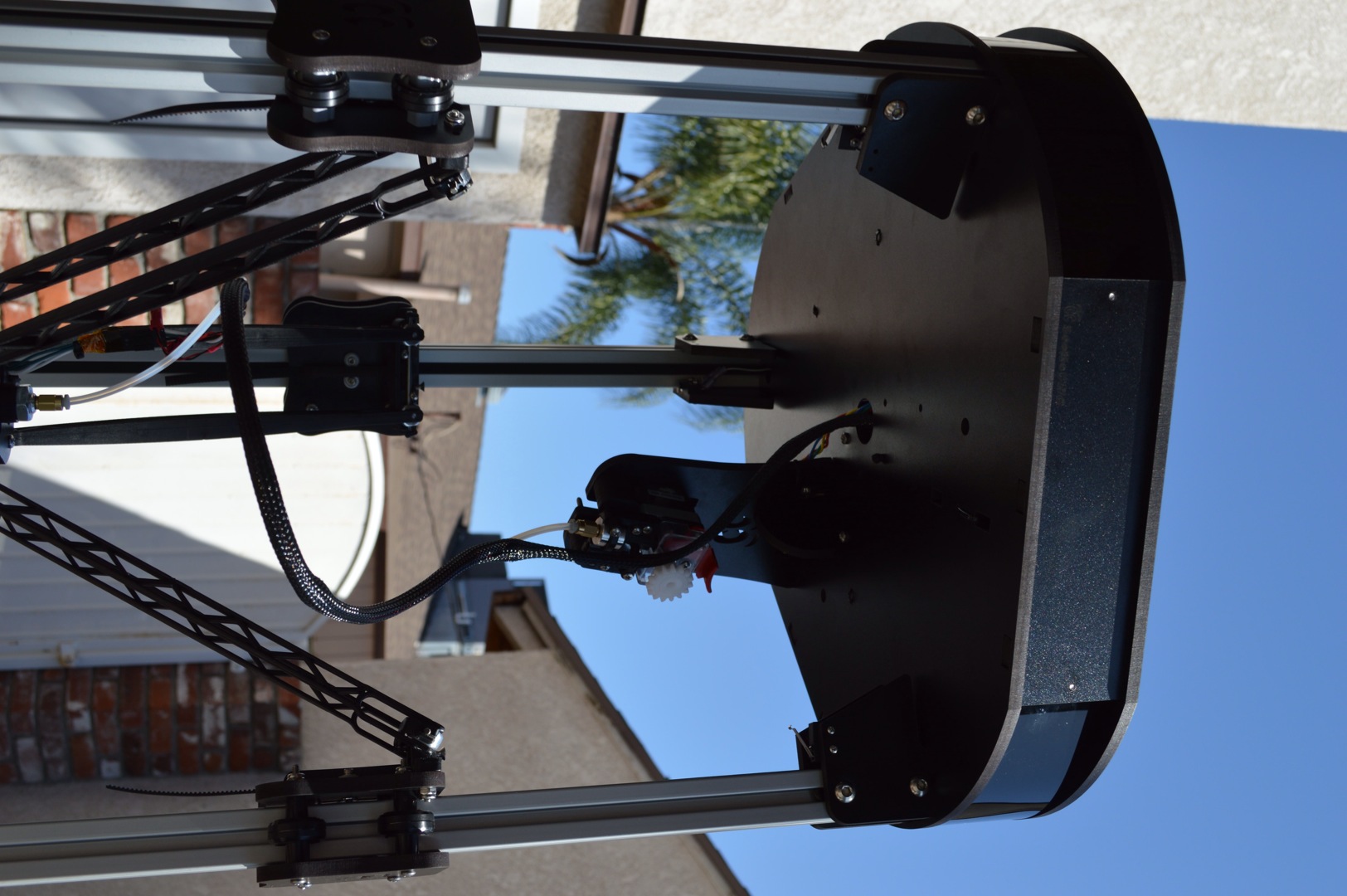

Outside face with SeeMeCNC eyes cut into the melamine

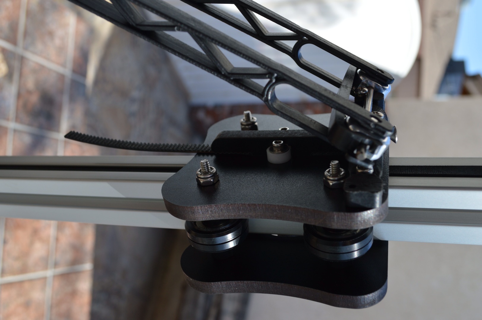

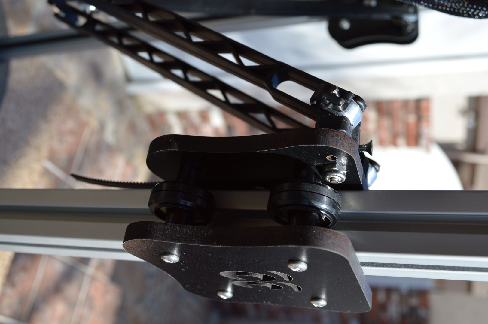

The cheapskate
The cheapskate

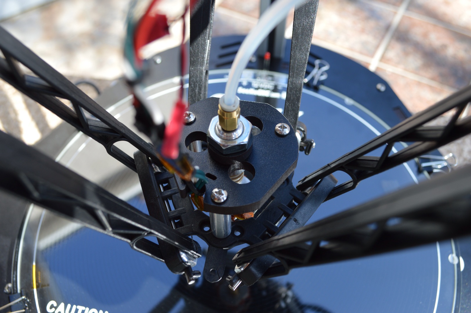

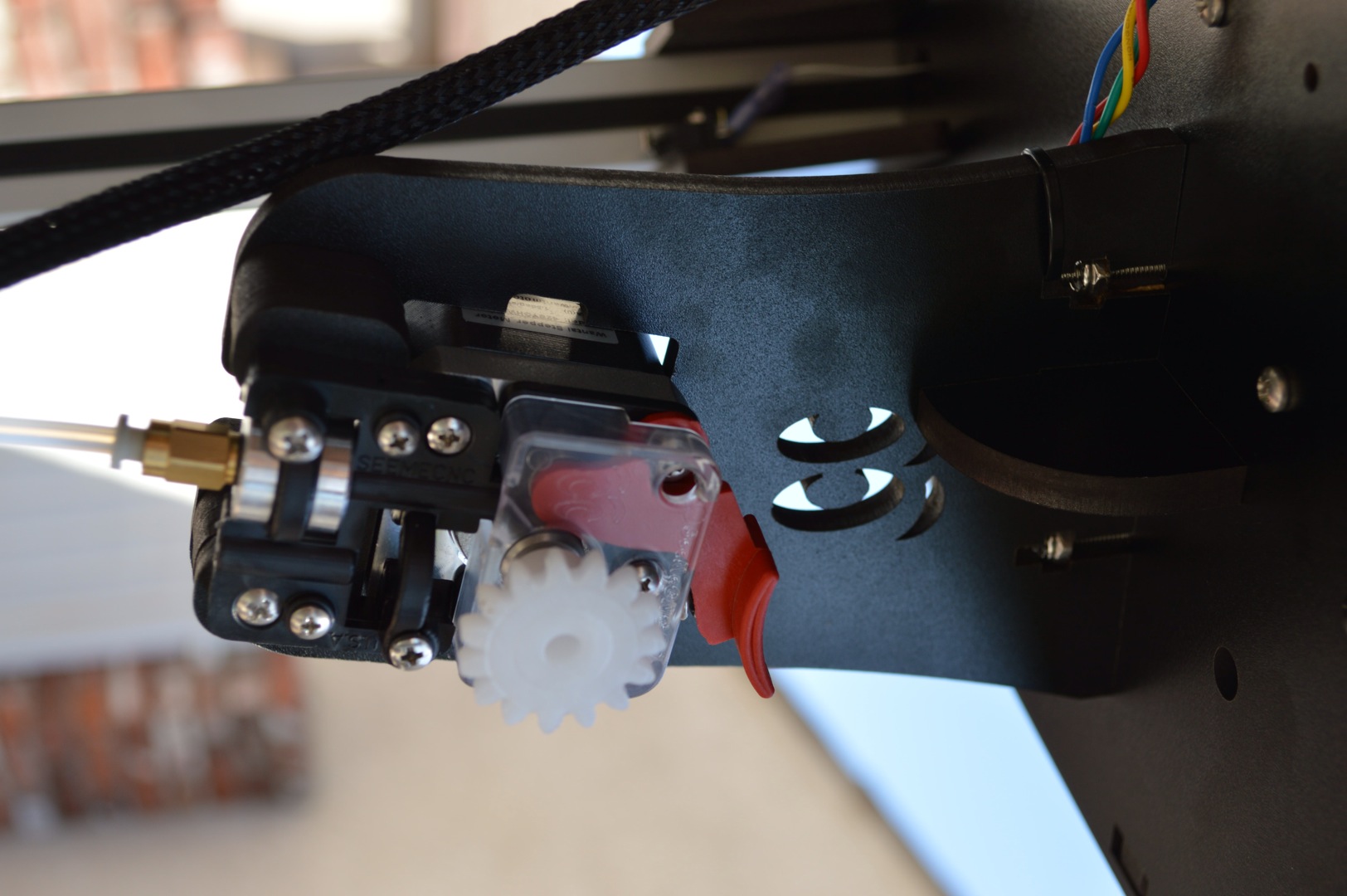

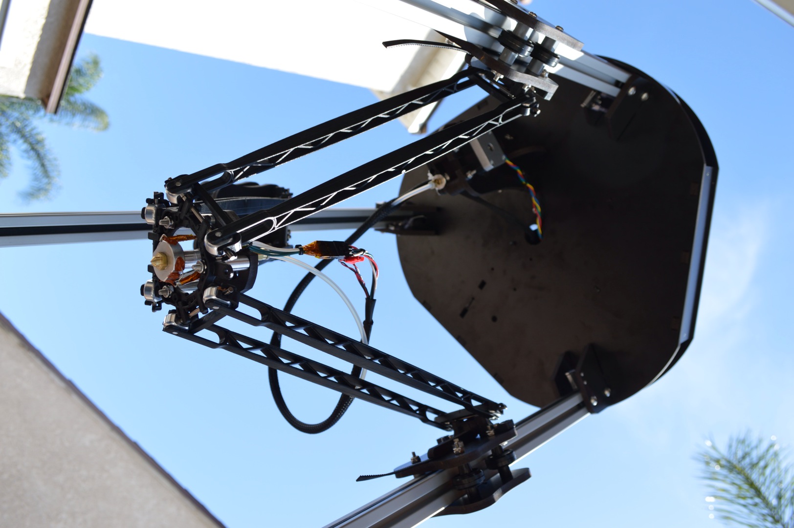

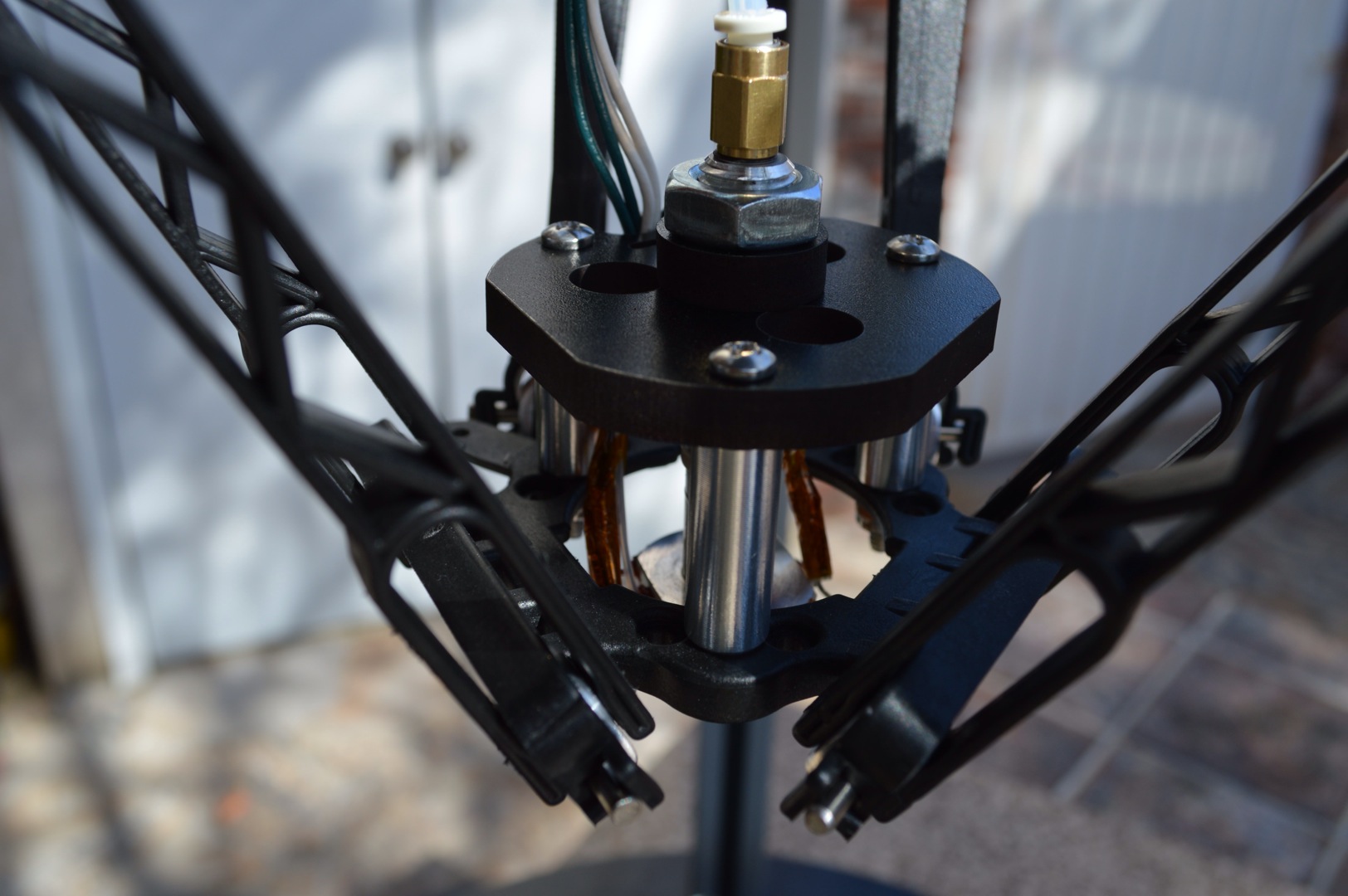

Closeup of the hotend and the hotend assembly
The hotend looking down at the Oynx plate

The new upper tower mount and black frosted lexan panels on the top cap
The EZStruder installed

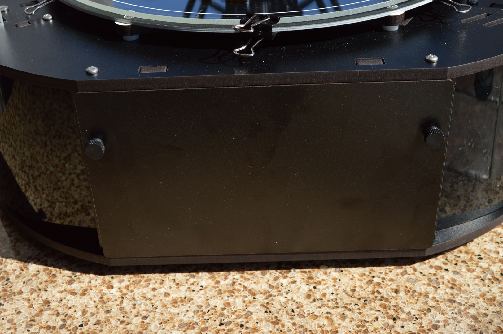

Side panels the screw on with nylon thumb screws

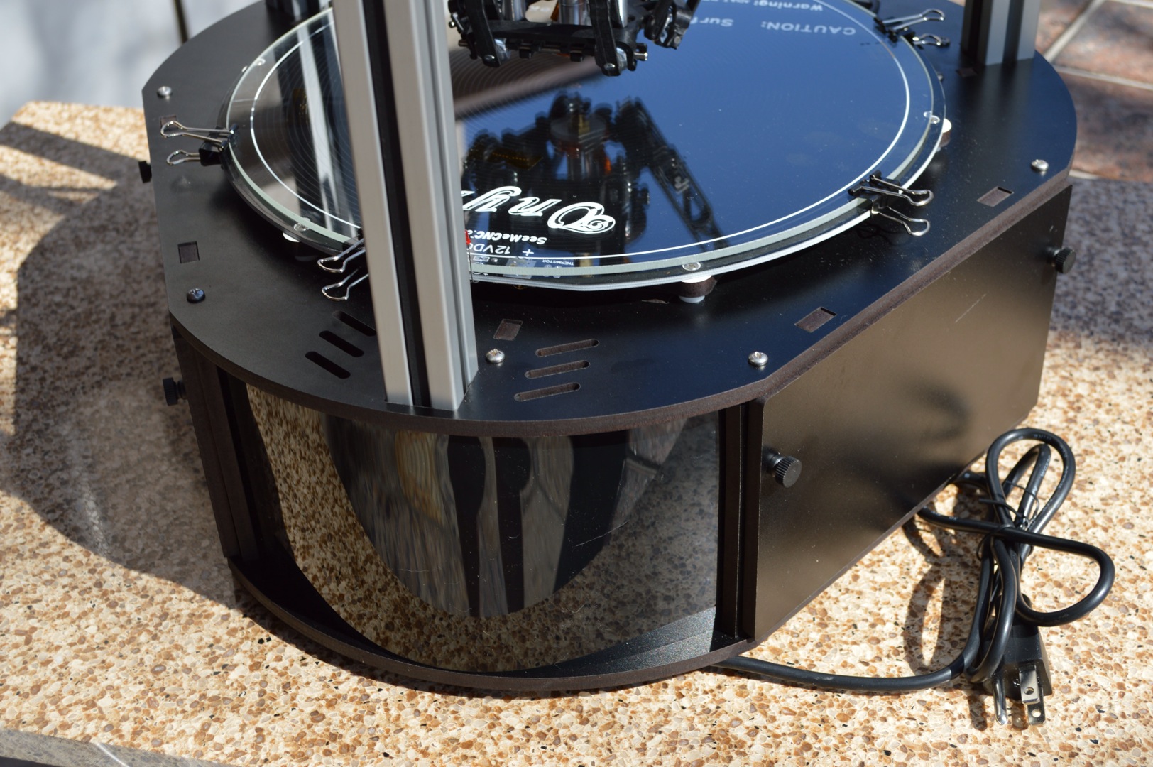

Back of the printer with Z axis tower and power cord

The hotend from below
The black tower as it stands completed

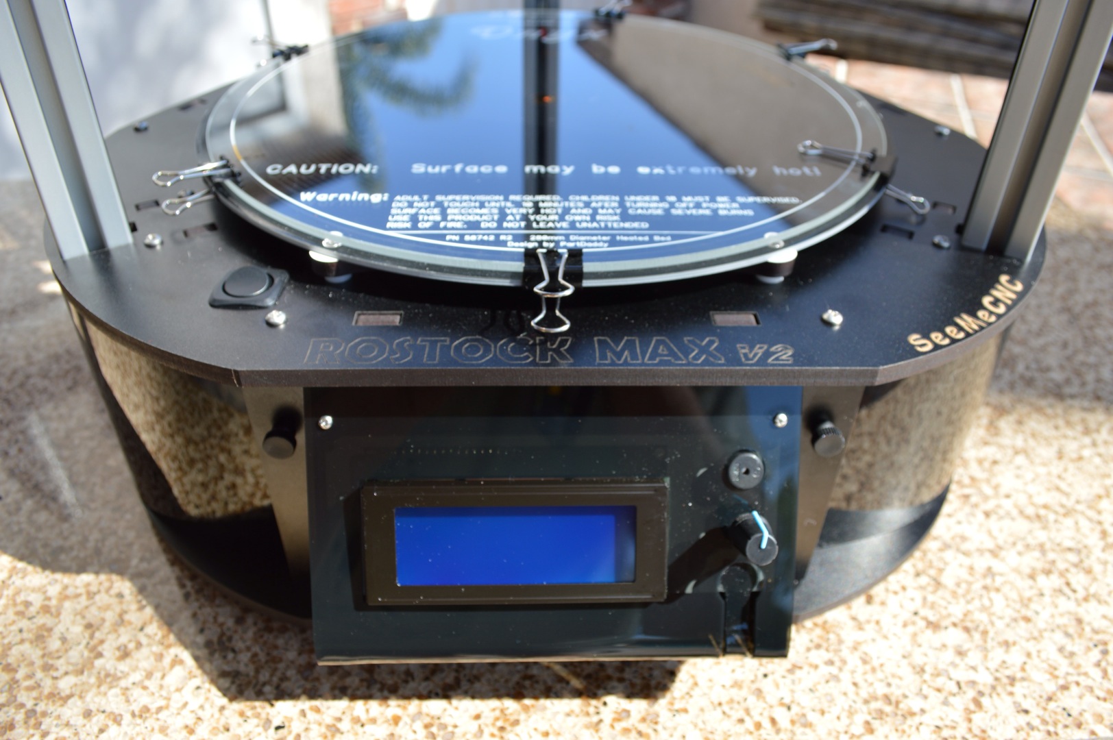

The oynx hotbed, LCD controller, on/off power switch and laser cut name and logo

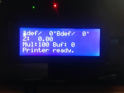

OK, so I'm getting ready to download software and firmware etc to load up my new V2, I do a test power on to make sure the Rambo fan is powing up and I get this screen... Does this mean it is already loaded and should I reload it?
LCD display on test power on before loading any software
joecnc2006
Posts: 148
Joined: Tue May 14, 2013 11:42 am
Post by joecnc2006 »
looks like version 0.81 or 0.83, the newest is 0.91.
Joe
bubbasnow
Posts: 1061
Location: Dayton, WA
Post by bubbasnow »
def/0 means there is a problem with your thermistor/wiring to your thermistor doublecheck your crimps. it will require a restart to clear the fault

Looks great! I just ordered one late last week. I love the picture titled "The black tower as it stands completed". It looks like it is 8 foot tall!
