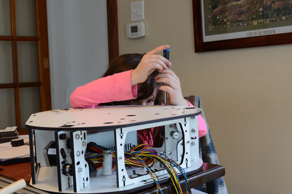

Sat morning 9 am, time to get assembling. I gathered up all the tools I figures I would need and brought them to my work area and started building. My “helper” is back and possibly more into this build that me!
In a couple hours we had the base all assembled and things were going nice a smooth.
I used my label maker and stuck an X,Y, Z sticker to each motor and on top next to each tower (this made keeping the orientation a lot easier when I was building.
I also labeled every wire as I installed them. Wiring up the RAMBo board was a breeze when I got to that point thanks to all the labels!

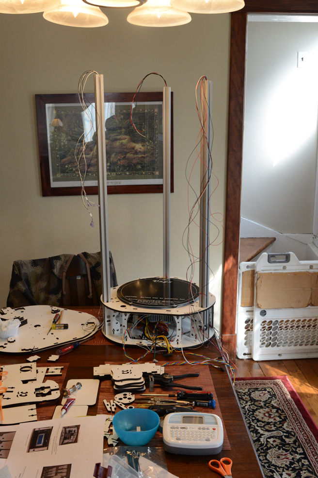

Threading the wires through the towers was one of the more difficult parts of the job. The wires are pretty snug and bind up about 2/3 of the way through the tower (all 3 sets got stuck). I tried twisting them as I pushed, but that didn’t seem to help any. I ran out to the garage and got a 3’ piece of wire (a long coat hanger might work) and used it to fish the wires through. Just push the fisher wire through and tape the printer wires to the end then using a combination of pushing the printer wire in and pulling the fisher wire out you can get the wires pulled through.
Here are the 3 towers installed on the base.

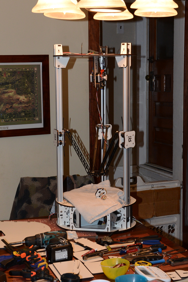

The next bump in the road I encountered was when I went to assemble the top section.
The bracket shape was different in the assembly guide and I thought I was missing them. I found something close, but was expecting there to be a hole where the screw went and not a slot.
Here is the top section in place. You can’t tell from the picture, but I accidentally sat it in place rotated 120 degrees off (this will come back to bite me later!).
I installed the belts and using 2 clams to hold things in place is definitely the way to go!
Next we installed the extruder and this is when you will discover whether you orientated your top plate correctly. I did not do I had to remove the belts I just installed and rotate it 120 degreed CC and re install. Probably 15min of unnecessary work that could have been avoided if I had of been paying attention. And yes its 8 pm now and my “helper” is still helping PJs and all!

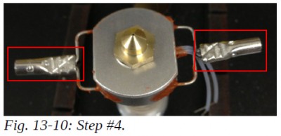

With my “helper” in bed I started setting up the hot end, but ran into a snag! My kit was missing the uninsulated barrel crimp connectors. I also had failed to order the quick release connectors in time so I got a bit tripped up at this point.
The 2 metal connectors (in red boxes) were missing : (
I skipped that part and assembled the effector and delta arms before calling it a night at 9 pm.

I grabbed 2 16-14 AWG Butt Connectors and stripped the plastic off them to use in place of the missing barrel crimp connectors on the hot end. They worked like a charm!
Part of why I got a late start was I had to ruin to auto zone and grab some 18 gauge wire to splice into and extend my hot end power wires. Mine were way too short to make it to the RAMBo Board. I went ahead and extended the red and black wire and had an extra set of white cable in my RABMo board box that I used to extend the green and white wires (used for the thermistor). The extra white cable even had the correct connector on the end, so that was a nice bonus!
