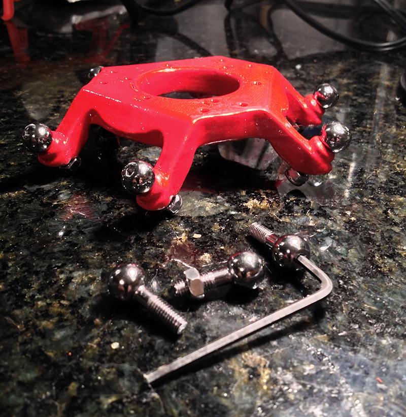

Some are having trouble with the whole jbweld adhesion thing. Or having inconsistent results which are critical for a delta printer.
Was at the hobby store the other day and picked up some of these just for testing and because I would like to have a few different effectors on the side with different hotends in them ready to go.
They are made by "TRAXXAS" part # 4933. You get 4 for 5 bucks cdn. You also get some nice plastic cups for them to ride in that you may or may not be able to use in your arms themselves.
Here is a pic!
As you can see they also have a nice allen key tip for tightening.

What is the diameter on the balls?Flateric wrote:Some are having trouble with the whole jbweld adhesion thing. Or having inconsistent results which are critical for a delta printer.

Edit: The balls appear to be 11mm in diameter which is 0.43307in. Since the cups on the Xnaron arms were designed for 1/2" balls wouldn't these
require a redesign of the printed cups?
Edit 2: The balls are supposed to be 3/8", not 1/2" so the balls listed above are a little too large.

That looks like it would be much easier to assemble. What are they made out of? All the ones I'm finding are made out of aluminum.

4933 is both steel and alum pivot ballsdaftscience wrote:That looks like it would be much easier to assemble. What are they made out of? All the ones I'm finding are made out of aluminum.

Quick research says they sell the product in both materials. #4933 is steel, #4933x is aluminum.
I'm waiting to hear if they work as well as ball bearings with magnets.

These balls are 10.9mm in diameter, the same size I have always been using since day one to be honest. Before this I was using pachinko (sp?) bearings from an old chinese style machine.
They are made out of VERY magnetic iron of some type and chrome coated.
As I say though, they also are accompanied by cups for each one that with a little modding can be made to work well with the magnetic arms. They fit nice a deeply within the cup. But the back half of the cup needs sanding away for the magnets to be as close as possible.
Overall they provide a much more consistent ball mount (height and being dead on straight), far more durable since these are one piece, and quick and easy alternative.

I've been using them on my rig for about 9 months now TBH. They work great. Mine were all steel.

Did you use this size using the stock xnaron cups? And if so, did you have to modify anything else to maintain proper part scaling?Flateric wrote:These balls are 10.9mm in diameter, the same size I have always been using since day one to be honest. Before this I was using pachinko (sp?) bearings from an old chinese style machine.

These look like an easier solution than JB weld. I wonder though if the flats from the Allen socket will cause issues with the magnetic attraction changing at different angles, and therefore different tensions. Also possible extra wear on the cups from the edge?
Or do you think these are these non issues?

My error, they are supposed to be 3/8".Tinyhead wrote:This is awesome. I've been pulling bearings apart at work trying to find 3/8 balls (Eaglezsoar I didn't realize the mag arms actually called for 1/2in) but with these traxxas joints, it might be a lot easier. Even redesigning the cups would be simple, but the length of the arms would need to change with the smaller balls in order to keep the geometry/scaling in check... I would think anyway...
Re: An easy magnetic ball solution.
In your opinion, will these work with the original Xnaron cups? The Xnaron cups are designed to use 3/8" balls.Flateric wrote:These balls are 10.9mm in diameter, the same size I have always been using since day one to be honest. Before this I was using pachinko (sp?) bearings from an old chinese style machine.

Offhand, I would wager that having the balls being dead center (or closer to than typical assemblies) will produce better results than any error introduced by the difference in attraction with the holes.* It isn't ideal, but for practicality it is likely to be trivial. Trick laser arms are good, but magnetic setups have features a fixed solution does not. For a fix it and forget it solution (for older style arms, you may see little if any difference with the latest stock arms), the trick laser arms are fantastic.whaleboy wrote:These look like an easier solution than JB weld. I wonder though if the flats from the Allen socket will cause issues with the magnetic attraction changing at different angles, and therefore different tensions. Also possible extra wear on the cups from the edge?

The effector pictured has been canned. While looking very nice and some of the design ideas behind it are great the overall issues it created are not acceptable.
The effector offset required to be put into the frmware was 64mm. So very substantial, it also introduced a bunch of play because of this large offset. The leveraging was too much if that makes any sense to you. I don't recommend it and won't use mine again after a few hours of playing with it.
The flats on the balls have been a none issue for our setups due to the small area of flat and angle of the arm contact point. I think they would work fine with the xnaron stl files but i cannot say I have used the original files for about a year atleast. I didnt like the small variances introduced with mounting and the fit of contact point between ball and plastic. I made my own hybrid steel and aluminium rod end and cup mounts long ago just for precision and consistency. I\ll post some pic of them here in a bit.
