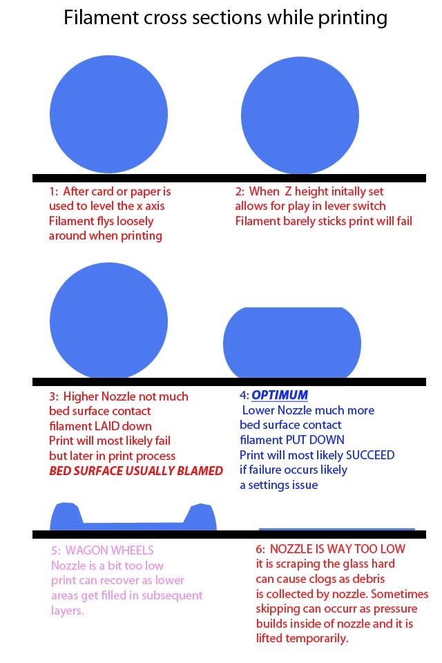

Achieving a Good First Layer - A graphic
I stole this from another forum, it makes sense to newer 3D printers...
