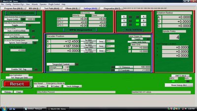

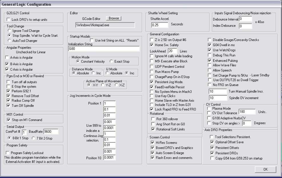

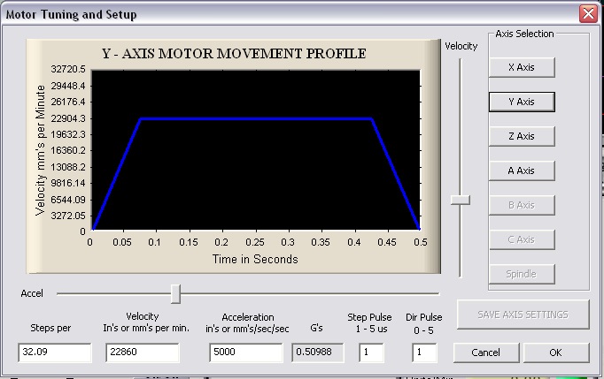

Here is my Mach configuration file for the Chinese 4 Axis (TB6560) boards. These are low cost on eBay and after correcting the opto isolator issue by removing and jumping them, they work great on this machine with lots of torque on X, Y, X AND A.
SeeMeCNC-H1-4AxisBoard.xml.zip
(31.76 KiB) Downloaded 2176 times
Note that you will have to unzip the file after downloading - the forum does not allow XML nor would it accept this if I changed the file extension to TXT.
Make sure to setup Mach for Native Units of millimeters. Also, your motor tuning may vary. I am still tweaking my A (extruder) so this one may be off.

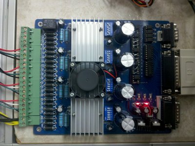

Here's a photo of the 4 axis board with jumpers installed

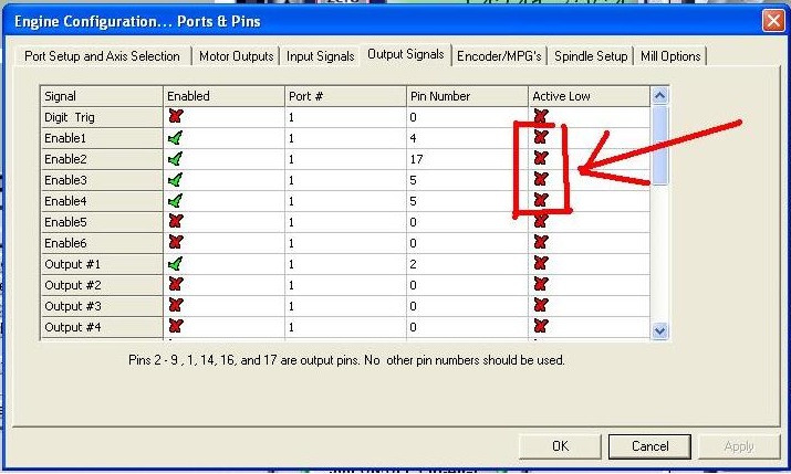

If your motors go 'dead' when you reset the e-stop, check this: Following MHackney's post screen shots above, and specifically referring to the "OUTPUT SIGNALS" tab on the "PORT & PINS" dialog box, you might need to reverse the "Active Low" settings. We had to do this on one of our PC's at SeeMeCNC headquarters. If the 'enable' pin and "Active Low" settings on these outputs are reversed, the stepper will receive power during an "Emergency Stop". Then turn off when the E-Stop is reset. Simply open the "PORTS & PINS" and go to the "OUTPUT SIGNALS" tab. Then reverse the setting under "Active Low" for each "Enable 1, Enable 2, Enable 3, Enable 4).
ports-n-pins "active low" is usually 'X'

And a photo of the 4 axis stepper control board.
DIP SWITCHES IN THIS PHOTO ARE SET to go with the 'Mach-Loader' Profile above. The A axis for extruder (not spindle) is Slic3r ready! The photo also shows jumpers installed on a HY-TB4DV-M:
SeeMeCNC 4 Axis Controller HY-TB4DV-M   with jumpered optos

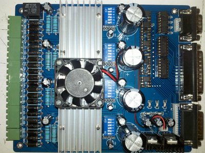

Posted: Fri Jun 01, 2012 10:31 am
by mtizle
Currently working on the jumpers settings for the 4 axis board. What did you use for the jumpers? Kinda looks like staples. Also wondering what the top jumper setting is, hard to see PIC attached.

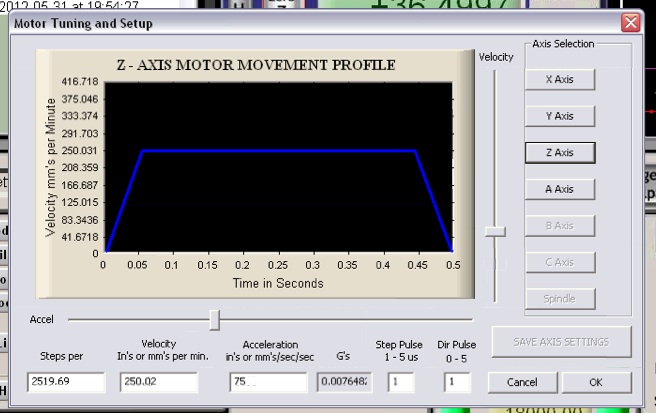

Anyone have a Motor Tuning profile for the Z axis? On the first page of this post are X, Y, and A but no Z.
Mtizle
Re: Mach 4-Axis Board Configuration
Posted: Mon Jun 04, 2012 5:28 pm
by mhackney
Ok, Here is my Z Axis tuning. It's been working great for me.
