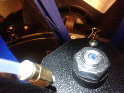

My brass fitting unscrewd during a print. I stopped everything and tried to screw it again in place. It doesn't seem to fit anymore.
I would contact SeeMeCNC support but I already tried for a different problem and got no answer.
Any suggestion to fix my problem?

Which end does it fit into, and how it it not fitting anymore? It won't thread in?
Could you take your filament out and release the bowden tube so that you can inspect the PTC fitting entirely? See if you have damaged threads or anything?

Yes, the problem is with the brass fitting that seems impossible to thread in.
I cut the filament and examined the thread with a lens but it seems ok.
Here is a picture of the opposite side

Looks like there's something blocking the hole - what's surrounding the filament there?

I was thinking the same but... who knows? I mean: I had no idea what the open end should look like. Might it be that the PTFE bowden broke inside?
How am I supposed to remove it? Will I be able to find another bowden should it be too short now? I mean easily/cheaply as I'm from Europe (Italy)

What you are seeing is a smaller length of bowden tube that stays inside hot end. When the fitting came out it must have moved up a bit so you can't see the threads. You can unscrew the nozzle and push the short Bowden out. You can reuse the short piece of Bowden again but The filament will be stuck inside the nozzle. If you were using abs the you can soak the nozzle in acetone to remove it. If it was pla then you can heat the nozzle to remove pla. The short piece of Bowden tube will fit inside the nozzle when reassembling. Hope that helps.

Try heating the hotend up first, as if it came out, and the ptfe liner raised up to where the threads are, then it might not go back in if the hotend is cold
Seems coherent with your ideas and much simpler, so I think I'll try this way first and remove the nozzle only if it does not work. I'll let you know

The simpler solution from support actually worked. Thanks once more for providing insight to the problem, I was far more confident in what i was doing.

For future information this is what happened....
When the ptc fitting came loose, there was nothing to hold the inner PTFE liner in place. As plastic was melted, the material began to push up against the base of the liner as it shifted. By the time you stopped the printer, a plastic filled gap had formed between the bottom of the hot end and the ptfe liner. In order to press the liner back in without tearing the hot end down, you just needed to heat it up and use the blunt tip of a pencil or other dull (back end of a 1/16" drill bit would work too) tool to push the liner back down far enough to allow the PTC fitting to grab the threads.
