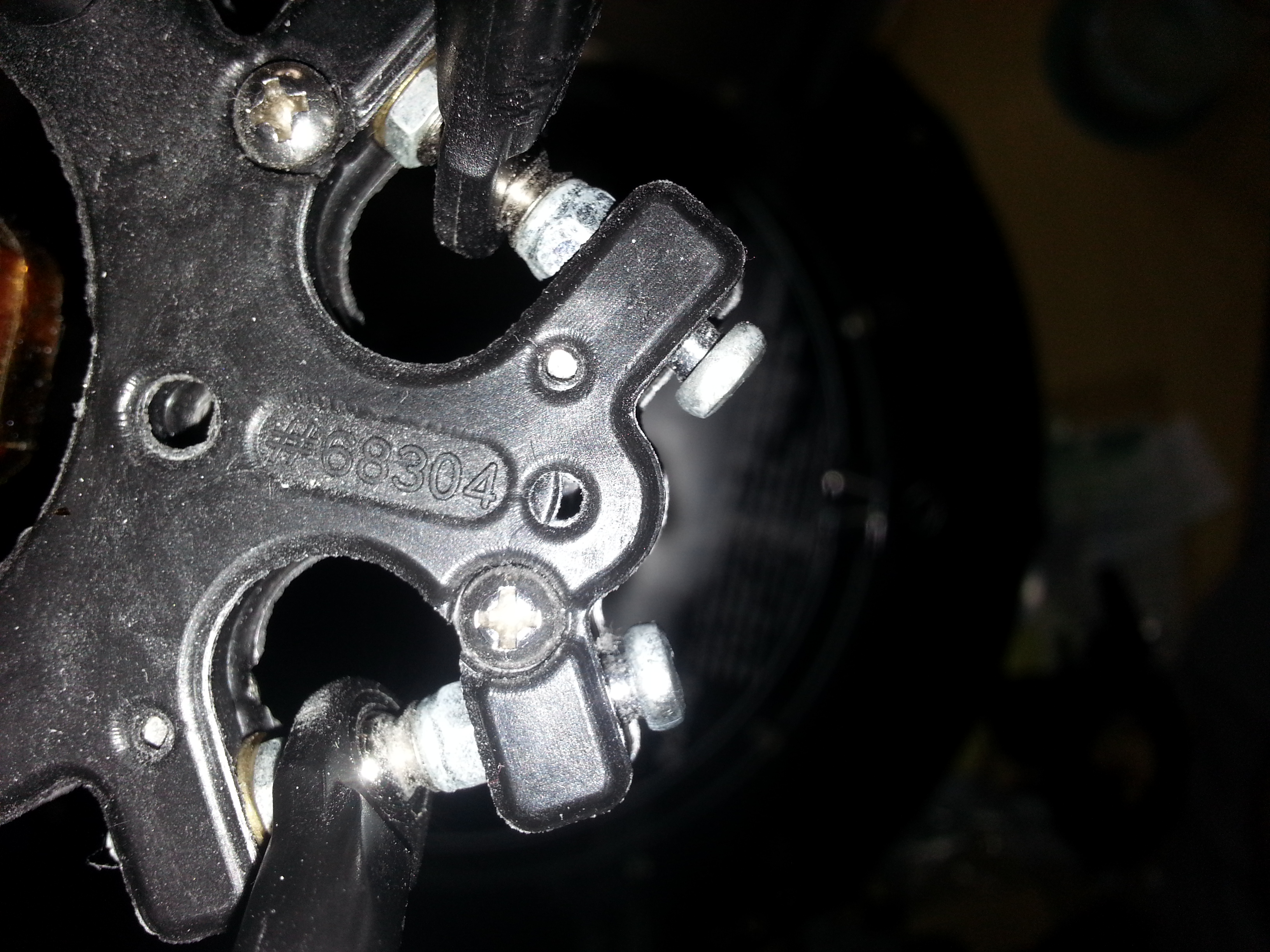

Re: Best Layer Fan Ideas?
Posted: Sat Apr 19, 2014 11:24 pm
by inventabuild
Here's the top view of the platform:
Here's the bottom view of the platform:
I cannot slip the shroud onto the platform because the screws heads are sticking out a smidgeon so they are in the way. Your help in figuring this out is appreciated.
Posted: Sun Apr 20, 2014 4:47 am
by Eaglezsoar
The red circle indicates where the fan is supposed to mount. There should be three such places.
If you have to, drill a small hole through at this point.

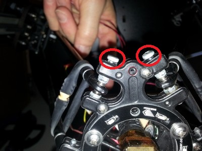

Posted: Sun Apr 20, 2014 9:56 am
by inventabuild
Thanks Eaglezsoar, I attached a pic showing the two screws that are in the way preventing me from slipping the shroud all the way on snug up against the platform and I circled the screws in red. Should these screws be screwed flush down against the platform to get them out of the way?
Effector Bottom View With Notes - 2.jpg (43.35 KiB) Viewed 15760 times
Posted: Sun Apr 20, 2014 11:04 am
by Eaglezsoar
Those screws are part of the assembly for the Trick Laser Arms. The only way that I can think of is to take a cutoff blade on a high speed tool and CAREFULLY cut the offending portion of screw off. The screw would look
like the letter D when you are done. You would have to do both screws and I think it would be easier to take apart the platform to get better access to the screws. Wear eye protection when cutting. If you think you may
need another fan at some time in the future you could do all the offending screws at the 3 points where the fans would mount. This may not be the best method for mounting the fans but it is the only way I can think of.
The original arms had a small shaft that held the spinning u-joints and the fans fit fine but with the Trick Laser Arms the Screws interfere. There are some on the forum that go spastic whenever I mention cutting something,
perhaps they have a better idea and will post it for you.
