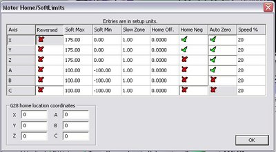

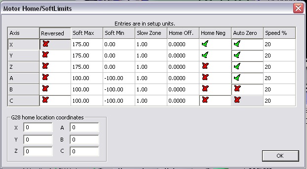

Here is a reasonable configuration for setting up home/limits in Mach for the H-1. Note that I use soft limits right now, now homing or limit switches.

So are you manually setting the XYZ zero in the middle of the table then turning on your soft limits?
I will eventually put some small home switches on mine but dont really see the need for limits.
Once you get home switches and setup your offsets its a 2 button affair, REF all home then turn on soft limits.

Almost, I position the head where I want the print to be located and zero X and Y. Then I 0 Z if it's needed. This way I am not always printing at the same place on the bed either.
I've been using my CNC'd mini mill this way for several years. The challenge with actual homes on these machines is the gawdaweful long time it takes for the Z axis to move. I wouldn't want to make Z home right at the table either since that may need to be tweaked on occasion.
