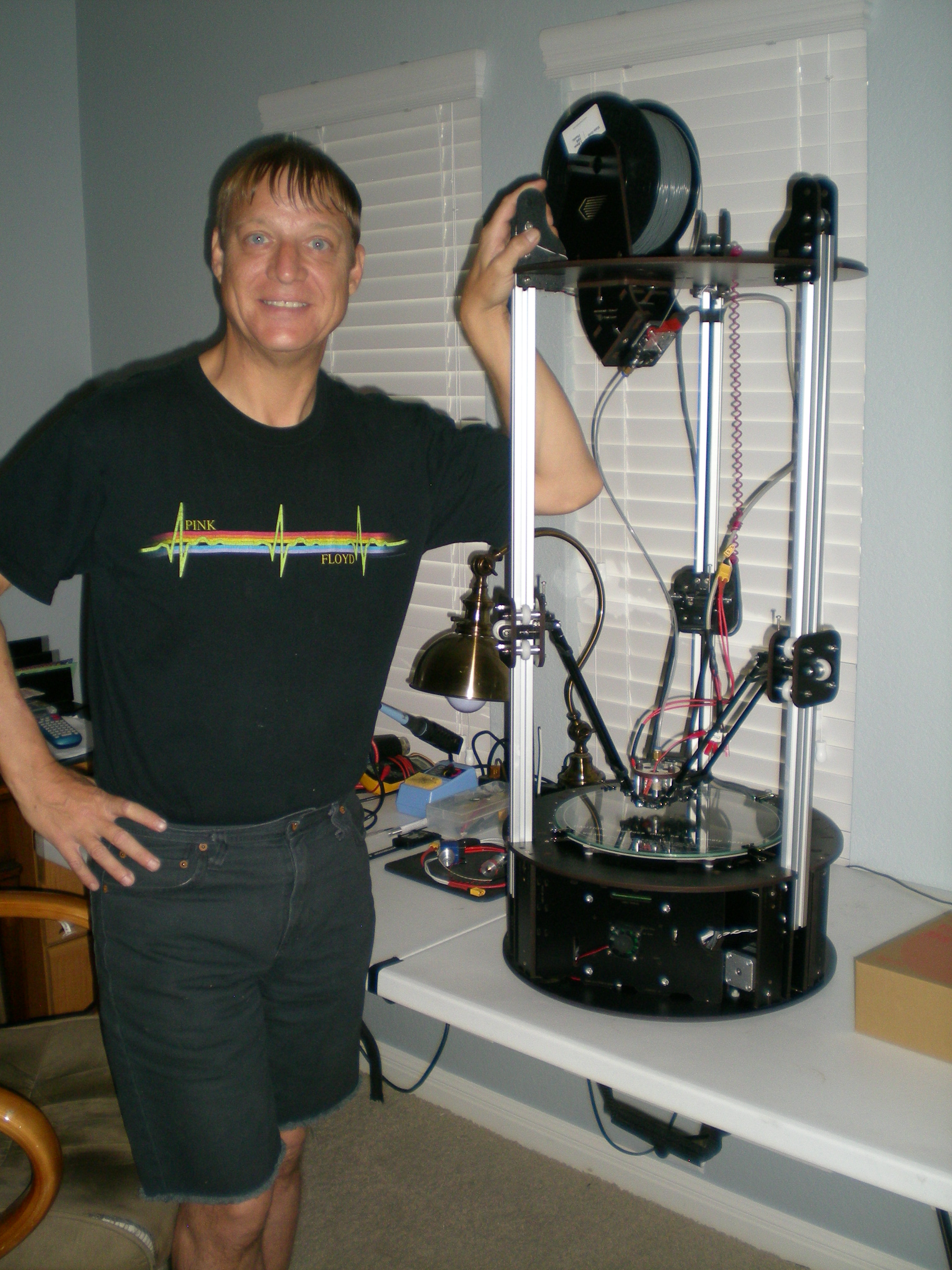

Welcome to my build thread. Ok, So what did I get and where am I currently stuck… I got me a Rostock V1 Max with (2) hotends with the original nozzles and fans, (2) Trick laser top mounts with (2) EZstruders, carbon fiber arms, zero lash straps and an E3D hot end with nozzle and fan. I also have 2 spools of exciting Grey ABS. I plan to start out using just one extruder with the original nozzle, then moving to (2) hotends with the original nozzles and fans, then multiple extruders with 2 E3D hot ends with fans. I’ve got the printer assembled and am stuck on getting it calibrated. Here are my issues and questions so far….
Questions on the Build/Assembly…
1. The Nozzle assembly seems loose; tight at the top where it’s tightened down, but with a little play at the bottom where it’s not… is this right?
2. I could not get the LCD display to work [get the dreaded white boxes]with the original firmware (Marlin) or the latest firmware (.83 or .91). Once I loaded PolygonHells hacked version of FW, the display comes right up. I’d like to get to the latest version of FW with the LCD display working, just not sure the best way to get there (like coping some code chunks.).
3. The cheapskate assembly on my Z axis seems loose, with more play than the others, but it seems tightened as much as it goes.. what more can I do?
4. Will I need a bigger Power Supply (than what comes with the V1 Rostock)to support multiple extruders and 5 accessories?
