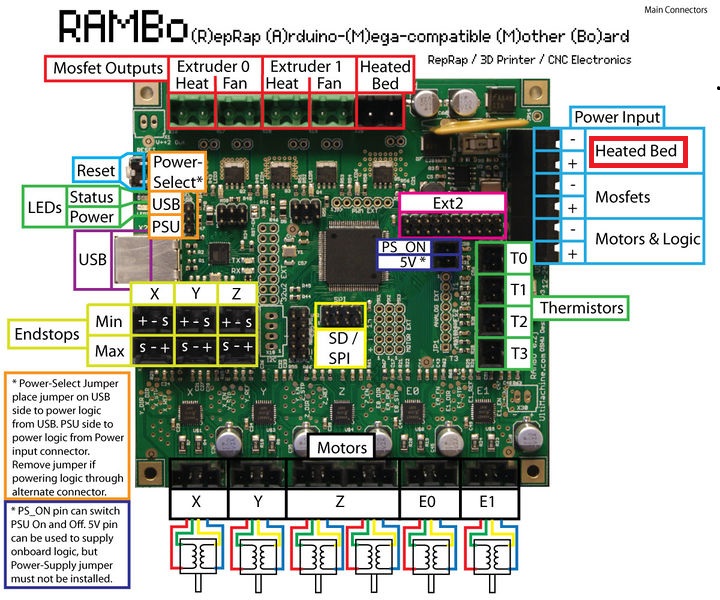

Re: Possible Overheating causing Hot End Failures?
Put the other 12V power supply in the Red circled pins.
The Bed will run off of the new Power supply the rest of the printer will run off
the old supply. You don't need relays or fuses, the card is fused.
If this fixes the problems, then I would get a larger power supply that can supply
more amps and replace the old one.

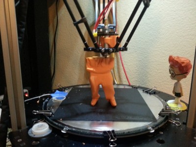

THANKS to EagleSoar!!! Started at 6:30pm PST, still going at 6:15 PST.
This is a 12-hr+ print. A solid Yoda-gangsta. Why burn half a spool on Yoda? Cause he's done it for us.
http://dropc.am/p/KhiI1a

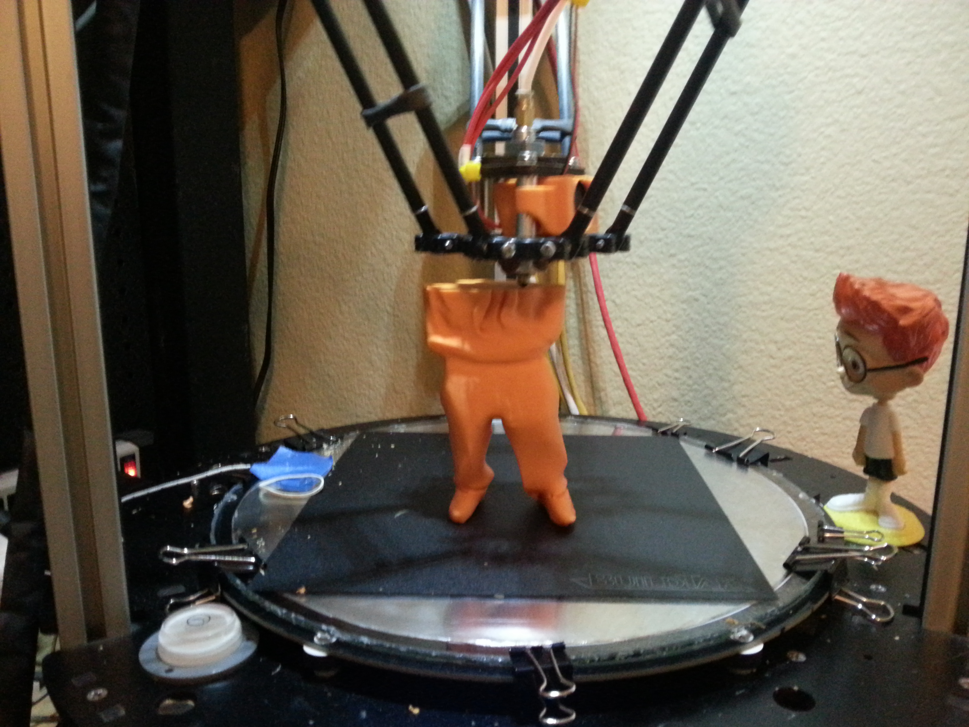

I repaired the errors in Netfab Basic, then ran Kisslicer. It's at the shoulders now. It's a solid print so I'm getting some cracks but overall, it looks good. I would definitely not do a solid version of it!!! Personally, I think it would be fine with 25% fill every other layer but I haven't tried it.
Personally, if I were to print it again, I would do 5 solid layers on the bottom because the right foot is raised up at the heel and the left foot has a canted edge on the outside. There is very little "footprint" to this model.
My dropcam is showing the print now. The printer is oriented to get a full view of the print (because I'm out of workbench space with the two printers I have running)

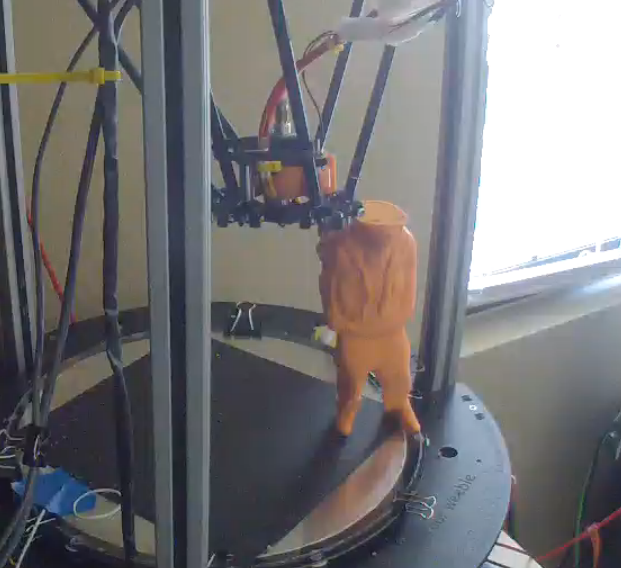

Solid form, Yoda will not take.
Got all the way to the eyes and the same failure occurred. Time to go to Fryes and buy a new power supply.
19.5 hours into it.
