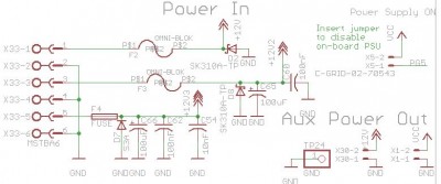

The three stepper motors used to home the Orion have no power when a G28 command is issued, nor when home on the front panel is clicked in the printer settings menu. I have found small (nano) fuses F3 and kF2 on the board and they check out OK, but am unable to find F1 to check it. Does anyone have an idea about lack of power to the 3 steppers? They worked fine before.

Did you pull the nanofuses and check them? The other larger fuse is for the heatbed.Struve wrote:The three stepper motors used to home the Orion have no power when a G28 command is issued, nor when home on the front panel is clicked in the printer settings menu. I have found small (nano) fuses F3 and kF2 on the board and they check out OK, but am unable to find F1 to check it. Does anyone have an idea about lack of power to the 3 steppers? They worked fine before.
About the only thing besides catastrophic failure on the board that would prevent 3 steppers from moving
would be one of the fuses. Please remove them and check them again.

The fans and heaters are on a completely separate circuit. Just to make sure, you have 12V going to both sets of connectors? There are 3 completely separate circuits on the board.
The first thing I would do is verify the stepper drivers are getting 12V from the board, you'll have to look up the pinouts for the drivers, they are the square chips at the bottom of the board.
My guess is they are not, the next thing is tracing back the 12V line to figure out why.
If they are getting voltage the next thing to check is that the enable line on the driver goes low when you send a movement command and stays that way.

Schematics are available at http://reprap.org/wiki/Rambo
Re: Orion towers will not home
Voltage at X33-1, and both sides of F2 were 12 VDC, but both sides of D2 were 0VDC, so the fuse holder is bad.
The fuse holder was probably damaged during my first attempt at removing F2, before making a tool to do this.

Inspect the fuse holder under a magnifying lens, there are tiny metal contacts that hold the fuse in place.Struve wrote: Voltage at X33-1, and both sides of F2 were 12 VDC, but both sides of D2 were 0VDC, so the fuse holder is bad.
It is very possible to gently bend those contacts in a small amount to make contact with the fuse again.
I would do this only under magnification because these things are so small.
Ultimachine also offers board repair for a reasonable cost.
