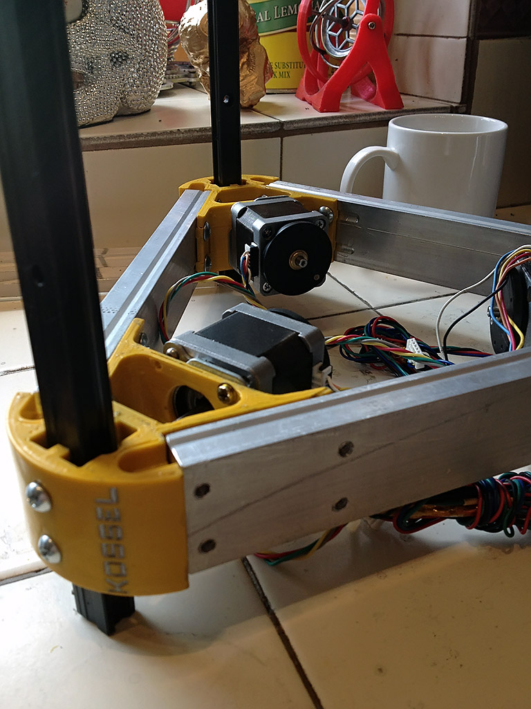

I have my Kossel nicely calibrated - seat level movement across the build platform. I've done a few test prints with mixed results all related to filament starving. When the filament flowed though, the print surface quality was ver nice. Long story short, my ezStruder is not generating enough force. I have a Kyson 1124090 stepper - the same as I used on the towers and also they are tried and true by the RepRapers. If I disconnect the Bowden and extrude say 50mm, I can easily make the stepper skip without a lot of effort. I just did this test on one of my Rostock ezStruders and I couldn't stop the filament for love nor money! I checked my config file for the smoothie board and gamma_current is set at 1.5amps. I'm running my Rostock from repeater firmware and RAMBo with a current setting of 230 (which is about 1.35A).
Of course I discover this after I have all of my wiring neatly routed and wrapped and "look'n purty". I tried testing another ezStruder and a different stepper (the ones SeeMeCNC sells) by hooking it up to the smoothieboard and it was equally anemic. Of course, this one has not been put in service so this is not a definitive test. As I write this, it occurs that I could hook the extruder up to one of the tower ports, say alpha, and test. But again, not sure if that is a definitive test given that a lot less force is needed to move the carriages.
I'm assuming the config file "1.5" setting is in actual amps but didn't actually check the web site.

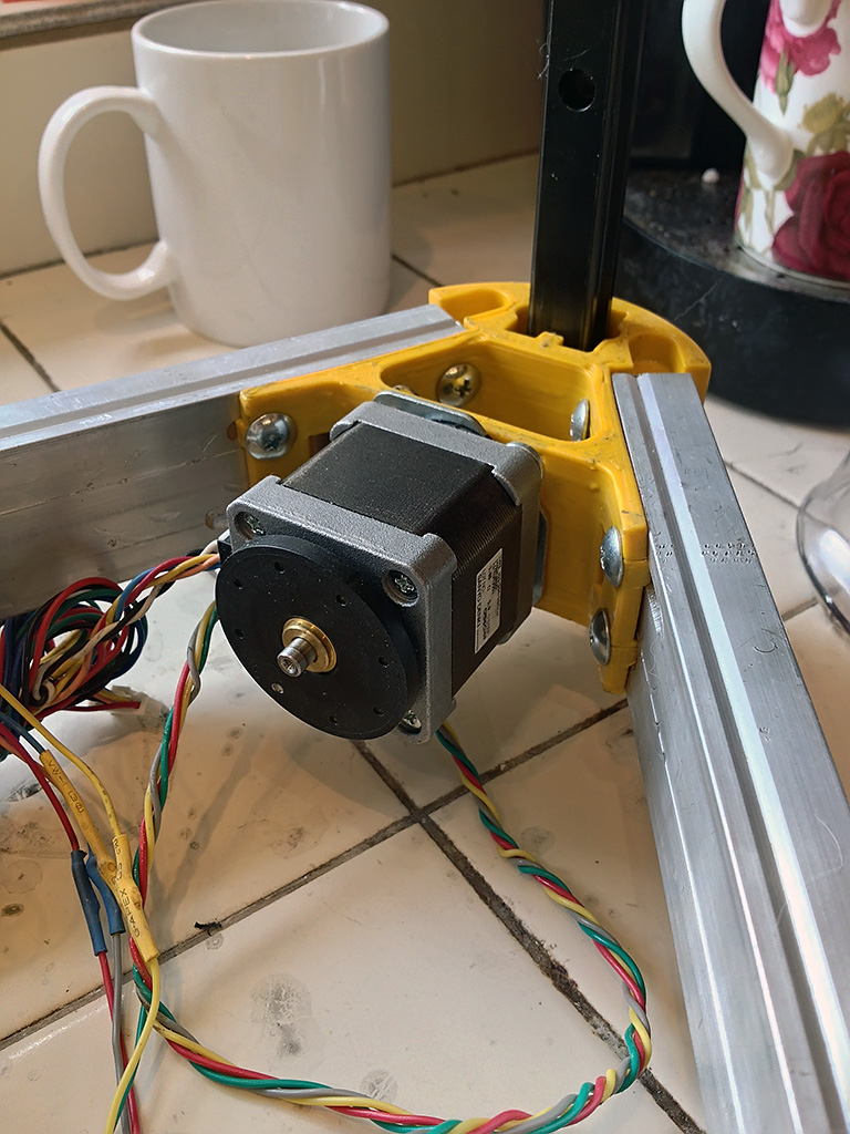

Well this sucks. My CF card has gone south and can't be reformatted. I got on the Smoothie iRC channel and it turns out that these are known issue. Apparently they are a Chinese knock-off of inferior quality. I have a new card on order. In the meantime, a chatter told me how to recompile with my custom config file and flash the smoothie board without the CF card using dfu_util (I had to grab the sources and compile on the mac along with a usb library dependency). Now I can flash the board directly from the terminal. This will keep me going until the new CF arrives.
Meanwhile I'm still trying to sort my extruder stepper issue. I checked the pin crimps and they were all perfect. Someone on the IRC offered that I might have a bad phase in the stepper, I have a few things to test tomorrow when I have a little time.
Posts: 2417
Location: Redmond WA
Re: Config file for smoothie board And a few tips/notes.
Post by Polygonhell »
I'd check the actual Vref on the drivers to verify that the Smoothie board is actually setting the digipot for 1.5A. Be VERY careful with the multimeter probes, all the driver variants I've looked at are enormously sensitive to being shorted etc.
Assuming you have one of the earlier SeeMe Steppers, they are usually wired Black Green Blue Red, or Red Blue Green Black if you want it to go the other way, IME when they are wired wrong they rarely move in the intended direction for very long.
Thanks, the suspect stepper is actually a Kysan stepper. The other stepper I tested is identical to the ones i have on the Rostock so I mimicked the wiring I used on the Max. There are enough variables that I need to go back and diagnose from the start. That's a job left for tomorrow.
