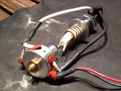

This is what can happen if you don't have a peek fan running on your HotEnd.
Posts: 5359
Re: Is the fan really necessary?
That's not true. That's what happens when you over-temp (247C+) the hot end. The PEEK fan is there to keep the cold section cool so you don't have PLA jams.

geneb wrote:That's not true. That's what happens when you over-temp (247C+) the hot end. The PEEK fan is there to keep the cold section cool so you don't have PLA jams.
Drat. I wasted 20 seconds posting that great picture just to find out that I was wrong.

nice hot end Eagle. did the thermistor pop out or what?
bvandiepenbos wrote:run a fan or you will likely have PLA jams.
btw, even for ABS I think the fan keeping barrel cool helps you have better retractions.
I think that is what happened. I found the image elsewhere on the forum and I think the
peek destruction was caused by a thermistor coming out.
