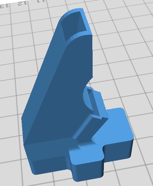

here's the new design we are using here at the shop... since we redesigned the platform and its thicker, I changed the fan shroud so it doesn't hit the platform when installing, also capped the bottom, and capped off the tab area so the fan can shift less...
Guanu

I go to the stock area and grab em lol... http://seemecnc.com/collections/parts-a ... blower-fan these are what I designed the shroud for..
dont feel bad boundless, I'm the one who originally designed the shroud, and decided to throw in the capping idea into the new revision... originally I didnt because of back pressure.. and there is still a decent amount of it, but the airflow out the tip is quite a lot even with this design, I just had to add a cutout because the new thicker platform needed clearance.. and while I was at it, decided to cap off the tab area.

I like what you did there. The capped off area will keep the fan pointed at the nozzle instead of being free to spin on the screw. I also liked the rounded end. This should give a bit more clearance from the surface as well.

I am curious, what are the square bumps on each side for?

Strength, support.

bvandiepenbos wrote:Nice revision. Thanks Guanu.
Keeps the shafts on the Effector from walking out in that direction on mine at least.
