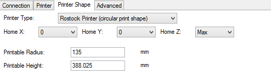

alright sorry thats my fault, i meant to say the calibration cube that gene mentions in the build manual. what slicer are you using? what temps do you have? it looks like you are running only walls/perimeters no infill? what is your movement speeds? do you have z lift?
popping is usually signs of moisture in the filament so you were right to switch, you can search here for posts about precooking filament in the oven to remove it.
with all these questions i am asking it might be easier if you just snap a screen shot of your settings windows and post it

Is there any other setting I might be missing?

those look pretty standard, lets have a look at your slic3r settings too

ok so if you got a .5mm nozzle your widths should be .55mm, the way you you have it set at .45 or lower will force too much material in smaller path.
i like top/bot layers fill pattern to be rectangular.
extra length on restart should = 0.
from what it looks like in those pictures is you aren't even getting a straight line/edge... I would take another hard look at your mechanical setup like belts, cheapskates, and arms.
