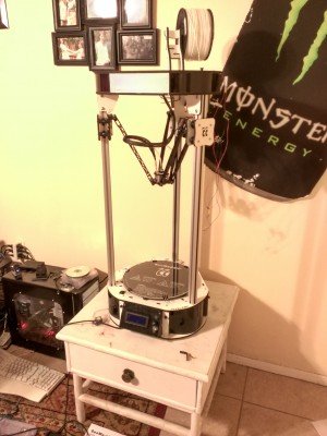

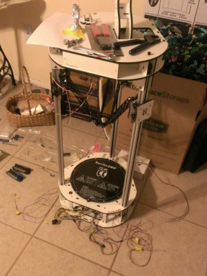

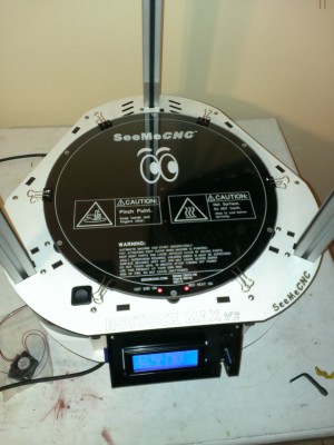

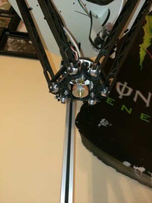

Hey there everyone! I assembled my new baby over about 2 days after receiving it on July 8th (impressive to myself considering it was a start/stop ordeal with my girlfriend pulling me away often lol) and had very minimal complications, any complications being due to my own misreadings or "whoopsie!" moments. Below are some photos of her, only one of which while she was still being assembled. I still haven't gotten to print my fan shrouds, I've been having some issues with getting repetier onto my host computer. Things will hopefully be chugging along here soon though!
While I was still assembling it

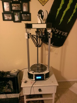

W.I.S.P.E.R.
W.I.S.P.E.R.
See the dangling fan wires? lol
I think I did a pretty good job with the RTV silicone

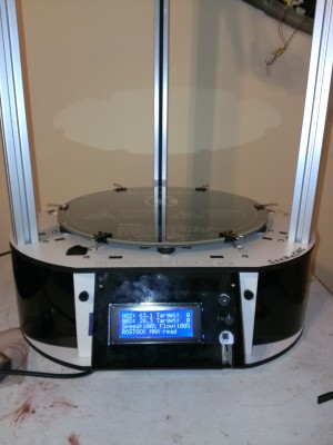

Look at those beautiful red LED's :)
The only flaw I could find, the two rows of missing pixels :/

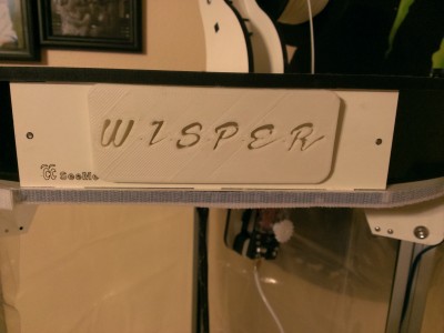

First things first, she really needed a way for people to identify her.
She printed her own name tag!  If you click the photo for full res, you may note the tiny dots between her acronym ;)

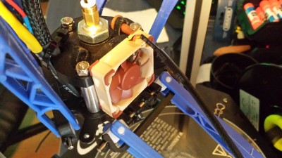

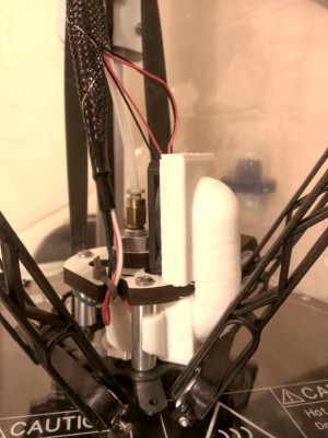

And I kinda broke my original PEEK fan :/ So I had to make my own fan shroud to fit a Radioshack fan :)
I made my own model in Autocad by using calipers on the model Geneb has us print in the manual!  Isn't reverse-engineering great fun? :)

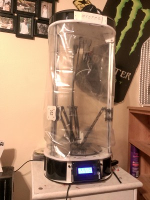

This shower curtain cut to size, and a little velcro, make for a pretty slick looking enclosure to hold heat in.
Mike B posted this suggestion over in the Tips n Tricks area here
This was a brilliant idea and I can take no credit for it.

Here's my custom PEEK shroud model if anyone needs it for their own radioshack fan ;)
The model should work for any 40mmx40mm fan
NewestPeekFanMod.stl
Here's a more updated file!
(47.15 KiB) Downloaded 589 times
I'm so glad you guys like my 40mm mod :)

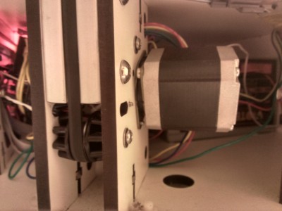

So, I've performed a few upgrades to W.I.S.P.E.R. and I must say she is running swell so far :)
I installed some astrosyn dampers on my tower motors
Here are the Astrosyn dampers I bought from astroboy on the forums.

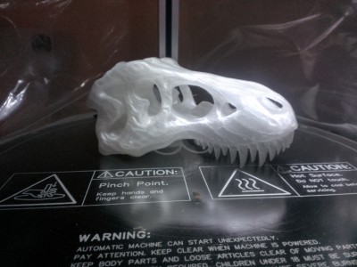

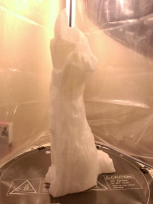

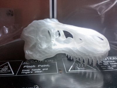

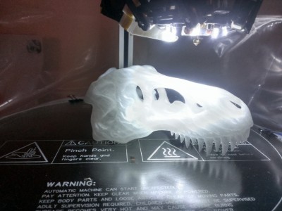

Here are a few shots of the Trex skull I'm printing, just the top part so far, and it was printed without the dampers installed. The lower of the skull is being layered onto the print bed as I type, with the dampers installed, so we'll see how the quality compares.
It's transparent ABS, and I didn't do anything yet to clean up the outer finish.  I think it came out pretty clean.
I'm debating on doing a cold acetone vapor finish to attempt making the outer shell totally clear.  What do you guys think?

Also, if any of you out there have KYSAN stepper motors and find they are running a bit hot, I changed all my voltages for tower motors down to 100, and the extruder motor to 105 in the firmware. Just doing that brought my motors down to a temperature that is completely comfortable to rest your hand on.

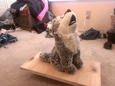

Currently I'm printing an incense burner (shaped like a howling wolf) for my girlfriend.
Pretty interesting method I used to make this model. Autodesk has this program, "123D Catch", that can stitch together a bunch of photos of an object so you can put together a 3D mesh of an environment and then extract what you actually wanted to model from the resulting mesh.
Here's my finished STL if anyone is interested in seeing what it came out like.
wolfmouthv3 (repaired).stl
The file I chose to slice and print first, MAJOR filament fail gave me an excuse to redesign
(425.08 KiB) Downloaded 571 times
EDIT: I fixed up the interior of the model and lowered the face count and it prints a LOT better now.
WolfLowPoly(final) (repaired).stl
This is the better file and the one I ultimately printed.
(105.06 KiB) Downloaded 528 times
Here's 1 of 28 photos I took at 12MP resolution with my phone's camera to make the mesh.
I modeled it, reduced polygons, and cut a hole up the middle and out the mouth. Printing now, let's see how it goes!
Edit: Here's the finished print!
Here's the finished print, scaled and stretched to the height and dimensions I wanted

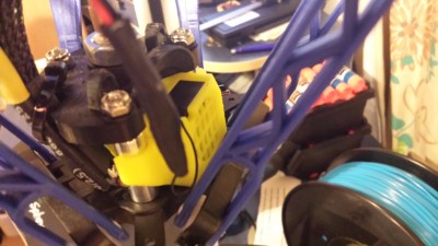

lightninjay wrote:Here's my custom PEEK shroud model if anyone needs it for their own radioshack fan ;)
MyPeekFanMod.stl
Hey lightning,
do you have the inventor or solidworks file for that fan? I want to try and push more air through it by making the opening on the fan side bigger.
Thanks.
Re: My new baby! Her name is W.I.S.P.E.R.
Posted: Mon Nov 17, 2014 4:27 pm
by lightninjay
I have an Autodesk dwg (I think) but you'll have to wait until I get home from class. :)
Here's the dwg!

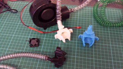

I've also been experimenting with Peek and Layer Cooling. My initial idea was essentially the same as your Lightning but I was concerned that the types of fan were using don't deal well with any backpressure so I was going down the line of modifying the top adapter plate to mount a 40mm fan.
I knew it was unlikely but hey I've got a 3d printer why not try and see... it's exceptionally close (see below) but ultimately it would require some mods of the fan housing or a fan 8mm depth or less IMO as it will catch at max build area.
Pretty close but no cigar
What did surprise me was how good the printed hot end adaptor plate was (95% solid ABS).. a few printed washers and other than if you lost your peek cooling I can't see any issues.. so haven't even bothered putting my wood one back on... works great and opens up options for alternate 40mm fan mounting solutions like your lightning as you can open up the air feed a bit more by cutting back the adapter plate. So hope you don't mind but I've taken your model as a base to modify in an effort to improve the air flow.
So while I'm fighting with my Modelling skills I've just fitted the standard fan and it works fine but so far I'm on my 3rd.
Normal Fan in first attempt modified adaptor plate
I've got a Squirrel cage air blower system I can desk mount for difficult filaments that are jam prone with any heat creep. It's serious overkill for ABS/PLA however
and a bit nosy even at reduced speeds so not a general filament cooling system. It's 10 or 6mm ID Tygon Tubing, 92mm Sq Cage, modified peek shroud and some tubing anti-kink coil so ~£10 in total ($15). Still I'd not recommend it too highly due to noise.
Black is 6mm White is 10mm I tested
Yeah it's all a bit Heath Robinson but I've had loads of fun just messing around... :)

What you're doing will have ZERO effect on the printed part. The stock PEEK fan & shroud is perfectly suited for the job it has - to cool the PEEK section of the hot end.

Yes clearly the stock fan and shroud offer sufficient cooling or the system would suffer from heat creep and at worst your "Peek" would melt.
Sorry I wasn't clear and didn't mention it but the reason I'm using a 40mm Noctua Fan is for reliability as so far my experience with 25mm fans reliability has been very poor. My stock fan lasted a week so tops therefore on this basis it's not suited to the task, loss of cooling due to fan failure is a safety risk IMO. So yeah the design is fine but for me reliability kills it.. unless someone has found some quality 25mm fans, I'm on my 3rd already....
So I got some 40mm Noctua fans which I know are reliable (they don't do a 25mm) .. or as reliable as I can get so I've modified to allow me to use one like a number of other people also have above.. as the 40mm files been downloaded a fair few times...... It's done now and works great BTW though nowhere near as elegant as the stock design but I'm simply interested in it working as reliably as I can make it.
